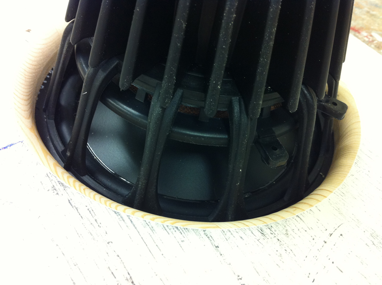

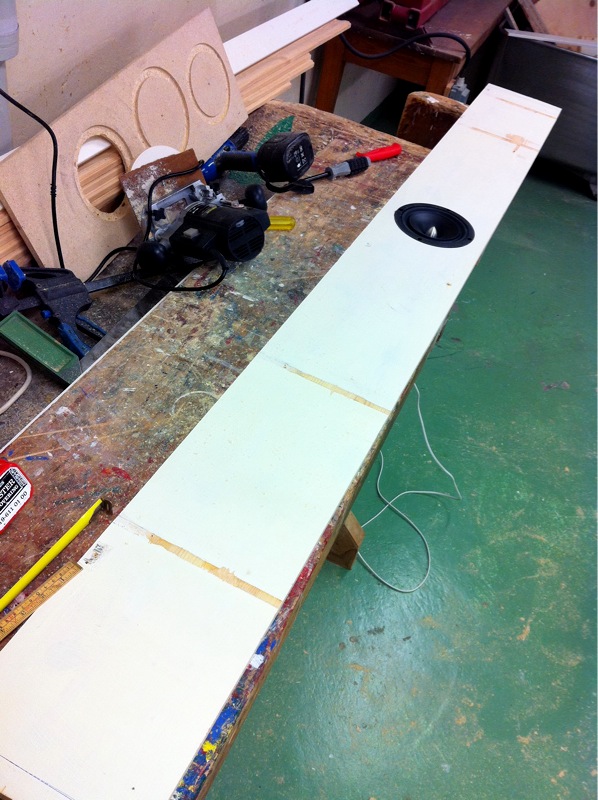

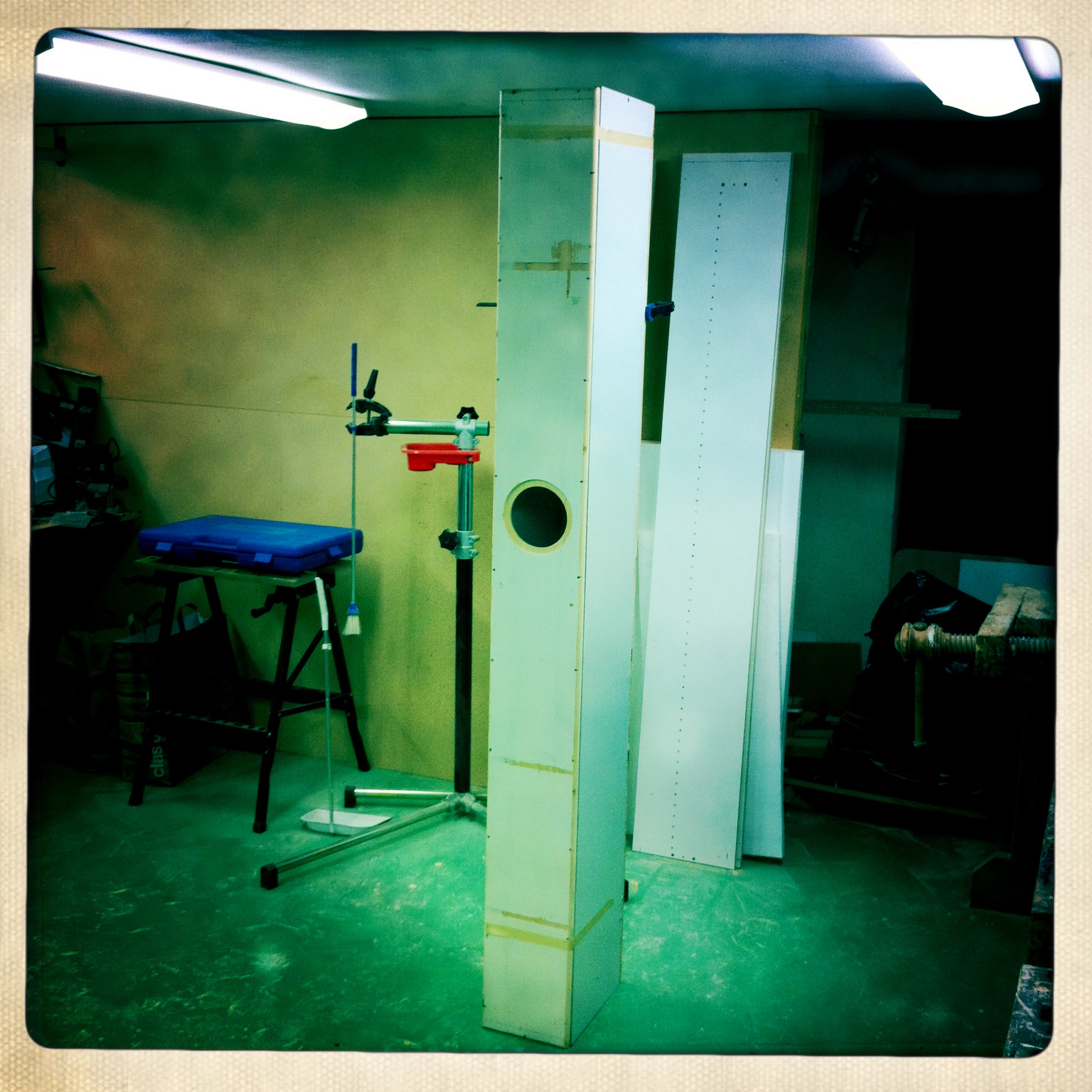

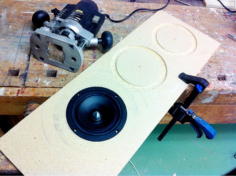

Hi. Ive had my W5-1611s for some time now, breakin them in in cardboard boxes. This weekend I got to some work done in the hobby shop we have in my apartment building. Baffle + back is cut to size, holes routed and today I hope to find some time to work on the sides panels and internal baffle

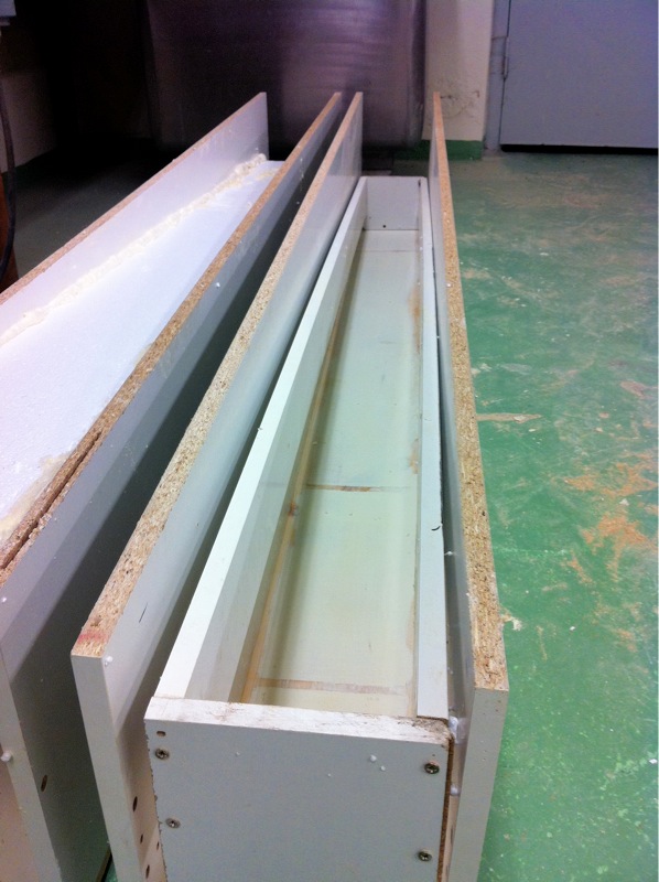

Im between jobs at the moment so budget only permits me to make do with scrap wood. The baffle and back will be in 19mm hardwood and the sides in 16mm low density MDF. For the internal baffle Im gonna use 30mm medium grade foam. The idea is that it will dampen some of the upper bass
Heres some pix of the project:
- Cardboard box break in
- Dry runs for the routing

Holy mother of pearl. These things are as resonant as hollering banshees in heat. Wrapping my knuckles on the sides is... interesting... The upper open part is particularly prone to sing the one note song. Im gonna have to try some serious bracing
Regards /Bo
Resonant is OK providing it's not within the functional BW of the enclosure -the -3dB mass corner of the 611SA according to the spec. sheet is 200Hz, so you don't want much output above that anyway (admittedly, it's not possible to be forensically accurate with a pipe-horn like the BIB, but suitably damped it should be rapidly falling above ~that region). Adding some bracing sounds like a good call with that particleboard etc.; should help push the panel resonance up out of the way.
Hi everyone. Thanks for ur tips and suggestions. Ive runs some test tones and music in the workshop. Next doors is a noisy laundry room. Not ideal but what can u do.
There seems to be resonances round 110Hz and Ive downloaded some more test tones so maybe i can pinpoint the frequency better. Most of the resonances occur near the speaker - no surprice I guess, both on the baffle and the sides. Its definitely muddling the vocals - not very fullrangeish
In the pre test tone phase I used my knuckles to locate the major resonances and then braced that part with 6 mm flower pins. Gonna brace some more right near the speaker
