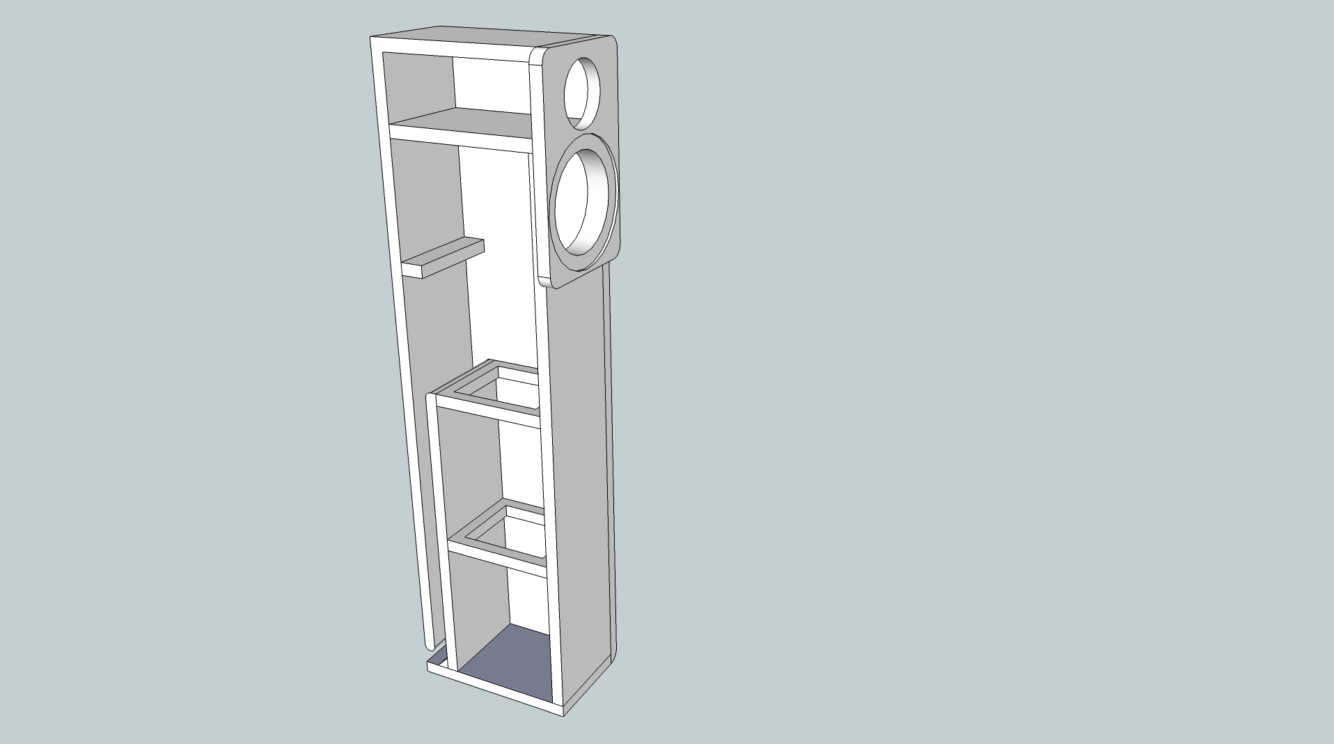

After heaving built a few pairs of more audiophile like speakers it's time for me to built something with a bit more oomph. A want to built a pair of compact floor standing speakers with built in subwoofers. For the subs i will be using the TangBand W5-1138SMF. I like the neodymium version a bit more but those are hard to find in Europe and are very expensive. For the mids and highs i will be using a full range driver to keep things simple. At the moment i think i will be using the Tang Band W3-926SDF but i haven't completely decided on that one.

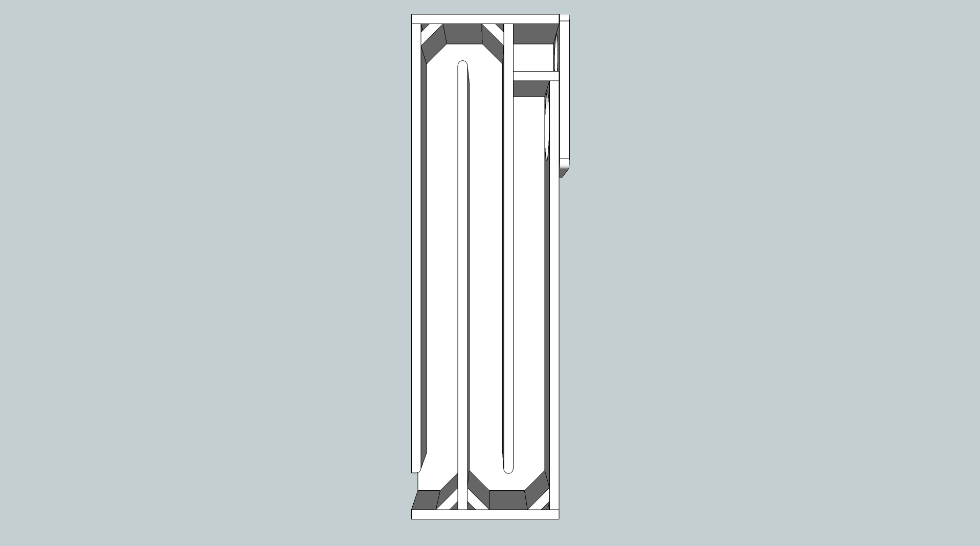

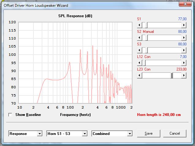

For the enclosure i want to built something i'm addicted to for quite a wile now, a transmission line. After a bit of modeling in Hornresp i came up with a pretty good looking response. Yes, it could be a bit flatter but it's not too bad. I can always change it later on.
After spending a bit of time in Sketchup i came up with a pretty awesome looking enclosure to my taste. I did have some clearance issues with that big ferrite magnet. A double stacked baffle was used to solve those issues. I also had to find a way to incorporate the fullrange driver into the enclosure. In the end i came up with a small closed box of around 1liter. I would have liked it to be a bit bigger but there wasn't much I could do about it without making the box look ridiculous.

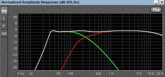

Because of the small closed box i might have to cross the drivers a bit higher than i originally anticipated. I could possibly use a bit of the natural roll off from the full range driver though. This speaker won't be very efficient but I don't really mind that, my amps has way more than enough guts to power a pair of these.
The only thing i'm not to sure of is the crossover because i haven't crossed drivers this low before (around 150 - 200Hz). I certainly do need an l-pad for the full range driver but do I also need a baffle step compensation cicuit? For the rest i would like to keep things simple, just a two-way 2nd order crossover. Any suggestions would be helpfull.

Hmmmm...
IMHO, you need to either drop the TL enclosure, or the small full-ranger.
You're gonna have trouble integrating the two while ensuring the FR driver doesn't run into power handling issues. Active crossovers would help, but I'd guesstimate your BSC circuit needs to come in around 500Hz. You could get that high by stuffing the transmission line to attenuate the mush that comes out the back, but you'll also lose bass.
You could get a 4" plus tweeter to sit in a larger cavity (extend it vertically), which would mean you can cross down to 100Hz or so and get a reasonable amount of power handling. You could then keep the transmission line if that's what you're after.
If it were mine, I'd go for a ported cabinet. You'll get similar bass performance with a much smaller cabinet. You could even use the money saved on materials to get more woofers (they are, after all, very inefficient).
The relatively narrow operating bandwidth of the port means the midrange response of the woofers is pretty much that shown by the datasheet, which will open up a lot more crossover options.

I was already thinking the same thing. I was running into some problems when i was designing the crossover. Dropping the TL enclosure does spoil the whole idea tho. I came up with the idea of using a full range driver because of simplicity and costs. A 3-way crossover will increase costs and make things more complicated. A vented box might be the solution but the efficiency is really setting me off. Only 81db 1w/1m compared to about 85 from the t-line. That will certainly drop though when the line is stuffed adequately.
With around 25 watts rms of input power and a crossover frequency of 200Hz, the driver displacement is just under 2mm. Increasing the box volume doesn't change much at all.

Hi Pascal,
I know this little bass speaker well (have used both versions), and it works great in a BR enclosure, tuned a bit below 40Hz.
The neo version has no advantage over the ferrite version other than weight. You are going to build a heavy piece of furniture anyways, and in that case a heavier magnet is only advantageous. The Mms of this thing is about 36 gr., from memory, and that creates quite some reaction forces if you swing it around at 40 Hz. A big slug of matter behind the voice coil is only good.
I don't see how switching to a BR would ruin your idea; you could still use the same form factor.
The only thing is that it is not very practical to do this with a passive filter/ you would want to cross over really low, like 100 to 200 Hz, and it is much cheaper and better to do this active, with a MiniDSP or so to start with.
Edit: looking back again at your drawing, this quarter wave style enclosure will severely limit power handling, and you will only know you went too far after having destroyed the driver mechanically.
Thanks for the advise. It will be a vented box than. That will save lots of problems i had with my crossover and will increase power handling. I should have forgotten that transmission line design immediately. I have seen someone built something similar before using the same driver and he ended up blowing up his subwoofer.
The box will be 12 - 14 liters tuned to 35 - 36Hz. The only problem is the extremely large port. About 59cm long. Tuning it higher is a bad idea, the response will than become very peaky. Efficiency is 82db 1w/1m. It has an F3 of 31Hz so in my room there is really no need for an extra subwoofer. Crossover frequency will be at 500Hz which is entirely possible according to the specsheet. I would like to keep that design, i think it looks good. The only thing i want to change is the depth of the enclosure. The height will also help with accommodating that huge port. I will also increase the volume for the fullrange driver a bit.
Powering these beasts also won't be a problem, my amp can supply op to 120 watt rms each channel at a 4ohm load. It's not 2ohm stable tho so adding a second 5.25'' driver certainly won't happen. And also don't forget the increase of costs. All help is really appreciated. I'm sort of on the right track now, at least I hope so.

Pascal, I think crossing over as high as 500 Hz will lead to disappointment; since at that point you are almost 5 octaves into the 10 audible ones that we have. Much of the music takes place here. The TB driver will do it, but it won't do it nicely. Distortion above 100 Hz gets rather ugly. Any decent FR will do much better in this respect. In addition, the FR will also have a much lighter cone, and for that reason will inject much less vibration into the enclosure.
Edit: your pipe length appears to be very long. What size diameter do you intend to use? 2" would be sufficient. But still, it might be long enough to have a pipe resonance below 500 Hz.
I have already made the port a bit shorter. Now it's 41 cm long so that's no too bad. Crossing the drivers at 500Hz did look really good in x-over pro. I was trying 200Hz before but i wasn't able to get anything near a flat response.
In the end i did find a way to cross that subwoofer at 200Hz, it's a two-way 2nd order Linkwitz-Riley crossover, the sub is crossed at 200Hz and the Fr at 250Hz. The response is actually not that bad. Lots of very high value parts though but not entirely impossible to obtain.
