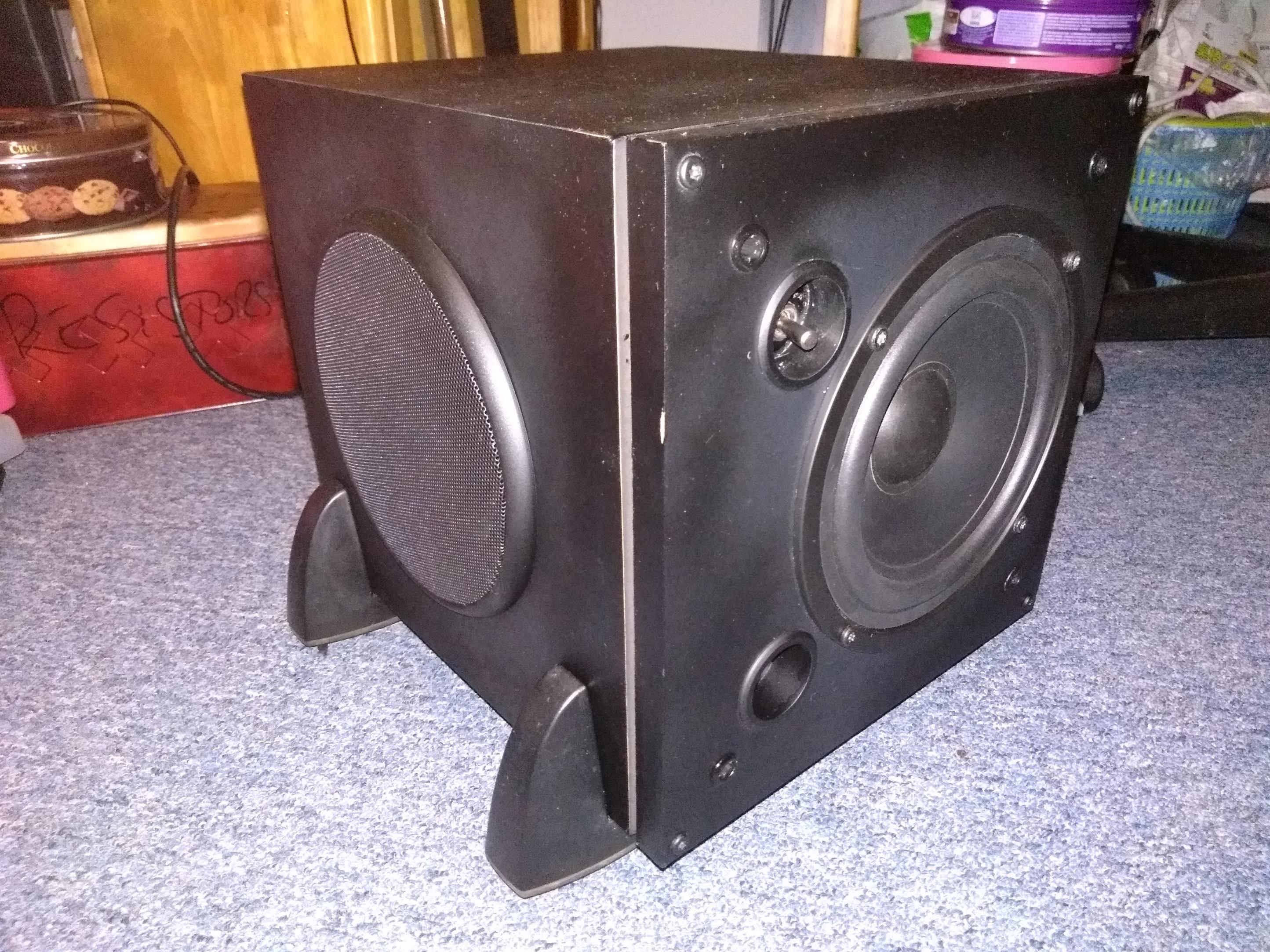

I dug out the parts and made a crossover - fitted into a kind of upstairs/downstairs lighting circuit so I can fully bypass it and listen to the sub with and without the filter. I've run out of time to do much else now tho - work will keep me busy til Christmas. The fact that it is working well and has no build issues will have to do for now. Besides, I've got so much hifi gear now that I may decide to stop the hobby and learn something new.
Anyway, here's a pic. The feet are Klipsch, the round ports are fake - blanked off. One blanked off port is used for the crossover switch. Internally it only uses egg box foam to damp the 4 of 6 panels.
