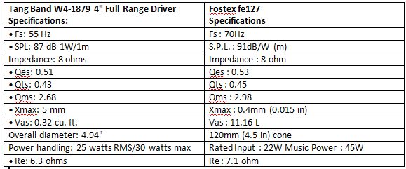

Has anyone put the W4-1879 into a pair of Fonken Floorstanders Mk ii?
Just thought I'd ask. I compared them a bit on paper, I can probably cut out the larger diameter required with a rotary tool.

Given how tightly tuned for the 'Kens are, it is unlikely to work optimally in FS2.
It may work OK in a similar box. I'll do more work on it when i get our set.
