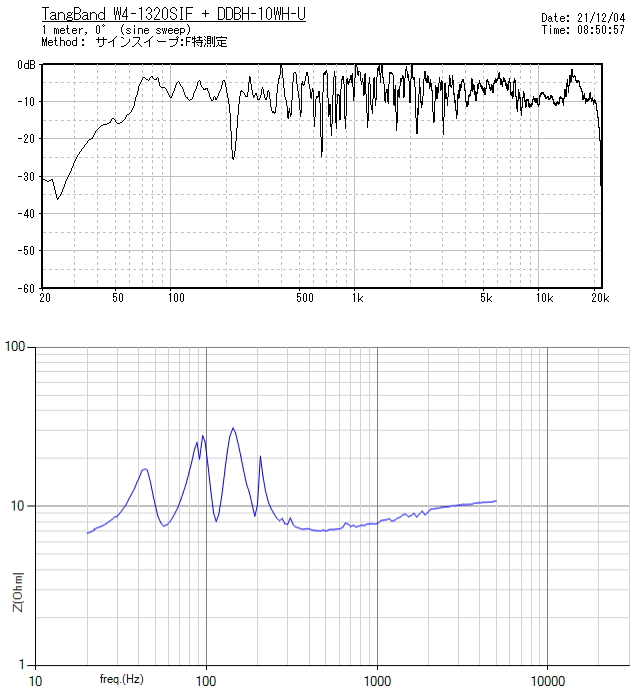

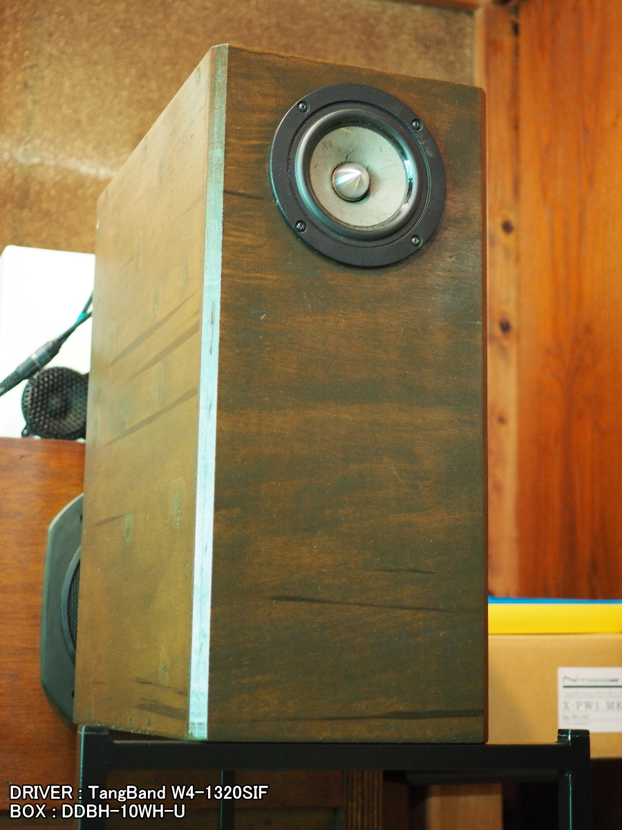

Dear IG81,
W4-1320SIF is a good driver.
It sounds beautiful regardless of T/S parameters.
I don't use simulators in box designs, so I don't care about T/S parameters.
W4-1320SIF | TAKE FIVE - Helge Lien / YouTube
TangBand W4 1320SIF | TAKE FIVE - Helge Lien - YouTube

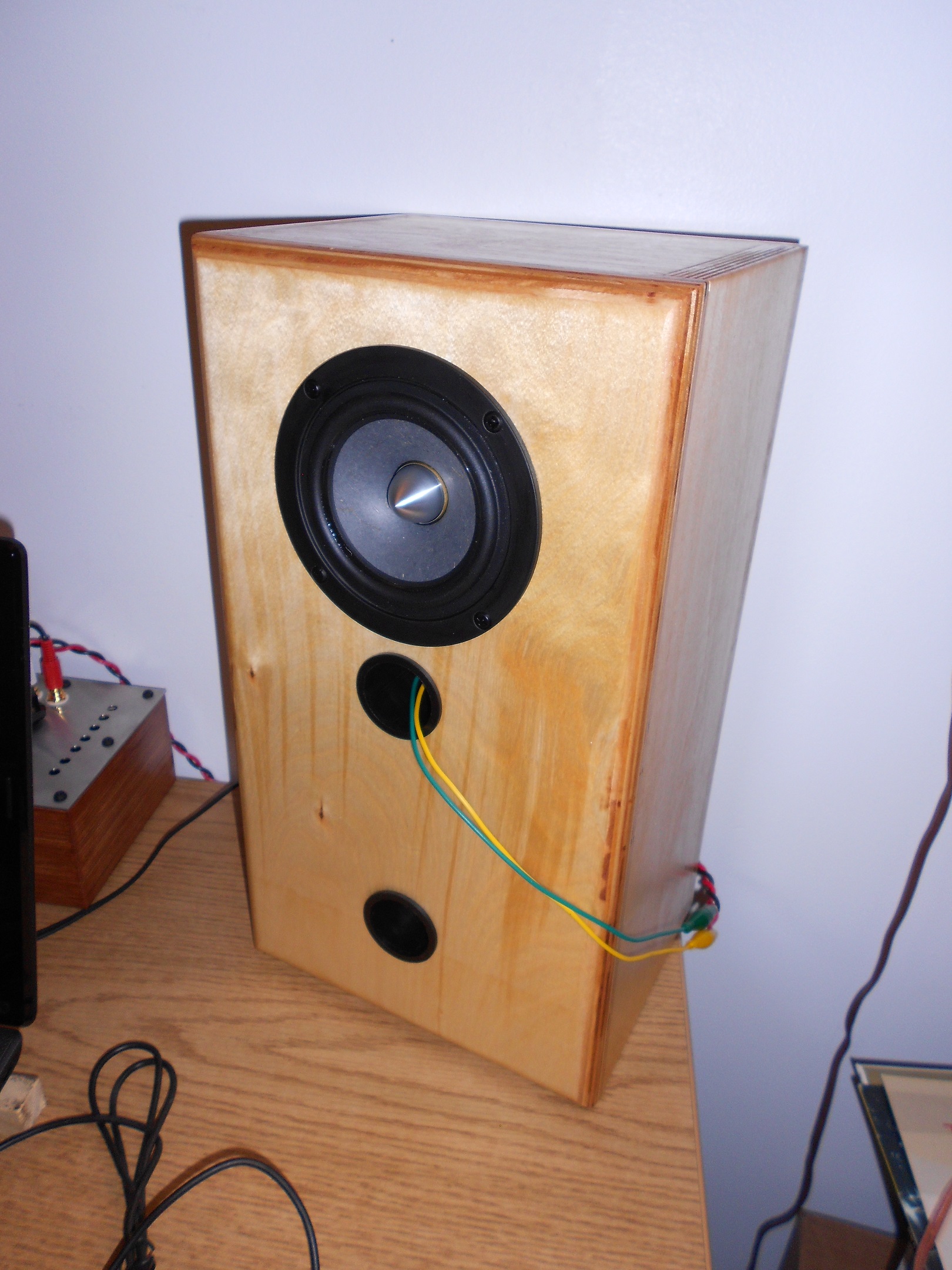

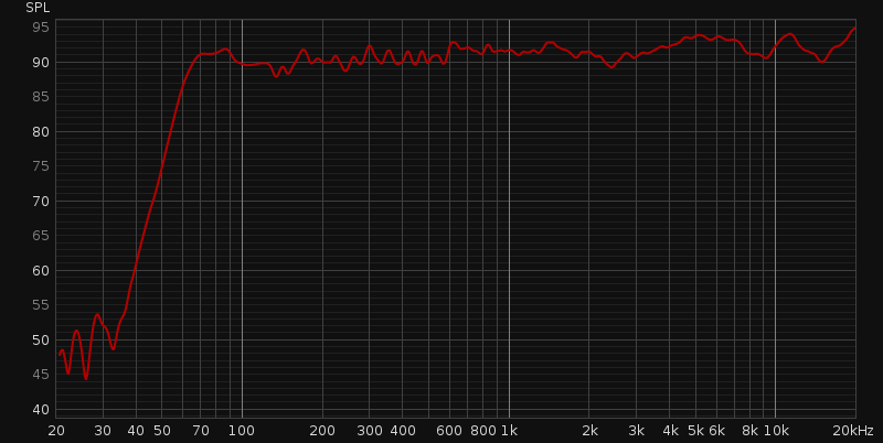

My W4-1320SIF are currently in double-chambered reflex (DCR) of 9L, which I built many years ago. Here is an old picture of the box, plus a recent FR measurement.
The below response was taken on-axis at 25cm and with an unknown input level, so the SPL level is not absolute.

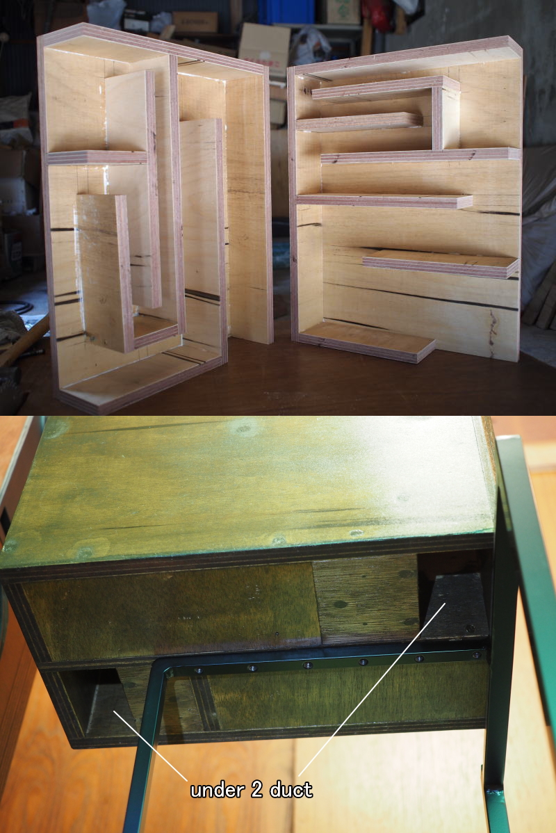

What enclosure do you have your W4-1320SIF in?
Kudos, as DCR's go, that's an impressively flat response!
I've always measured this driver's on-axis response to be quite flat above it's upper mass corner. I'm possibly minimizing room effects at 25cm away for the lower-end. As I mentionned, it is quite beamy though. Hard to listen as a desktop speaker. I prefer getting a good 2 meters away from them for a wider sweet-spot.

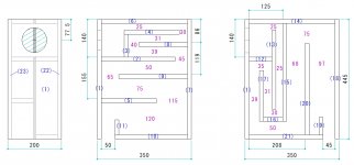

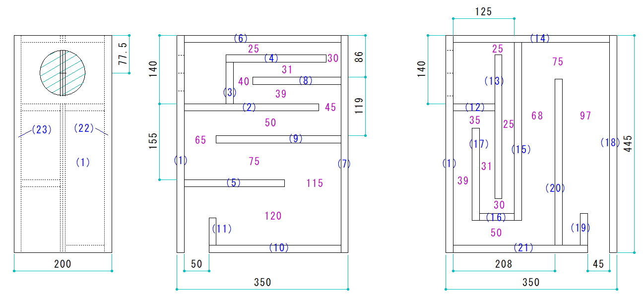

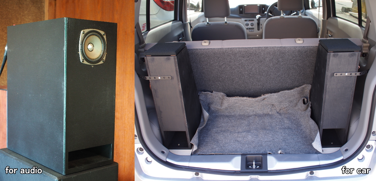

I designed it using the following online calculator.
Advanced Speaker Box Calculator
nandappe,
It's the first time I see an enclosure of this type. If I understand it correctly, it's driving two separate horns? How did you design this? I can see a lot of tweaking could be necessary depending on the approach. I would assume throat impedance would have to be comparable for each section to as to be "driven evenly". The impedance trace clearly shows something more than a single pipe/horn's action is going on there, so I suppose you nailed it!
