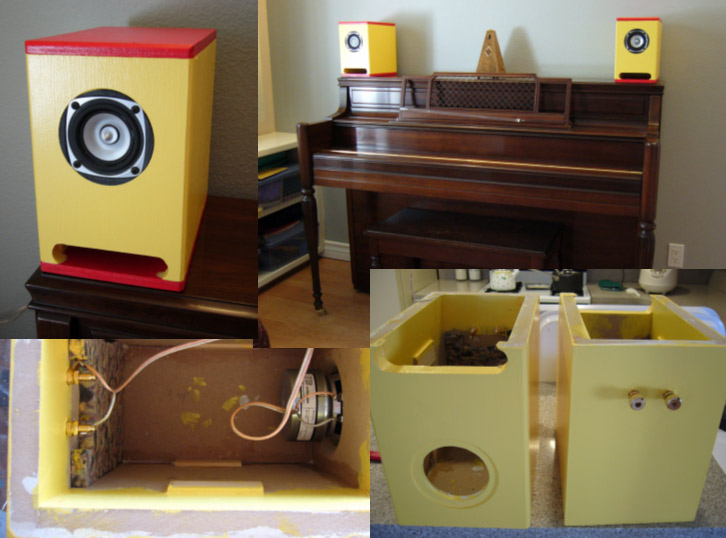

You may want to look at DelSol, built them with 593 and they sound good, similar size with bottom vent.
http://www.diyaudio.com/forums/show...0212&perpage=25&highlight=delsol&pagenumber=5
gychang
