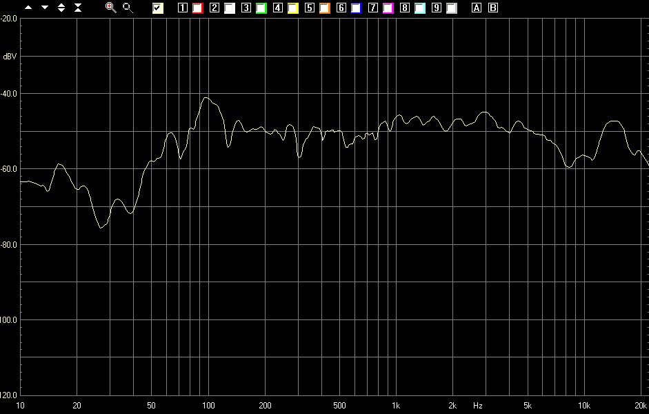

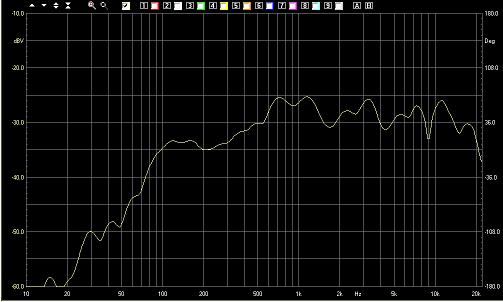

Can you please share your measurements?
I found the measurements of this site (I'm not sure whether they will need you to something)
Have a nice day
RK

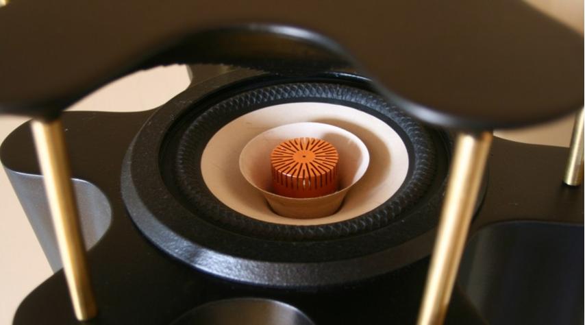

Rk,
I only see an image of driver in unusual flower shaped cabinet. Where are your measurements again?
Thanks.
Thanks.

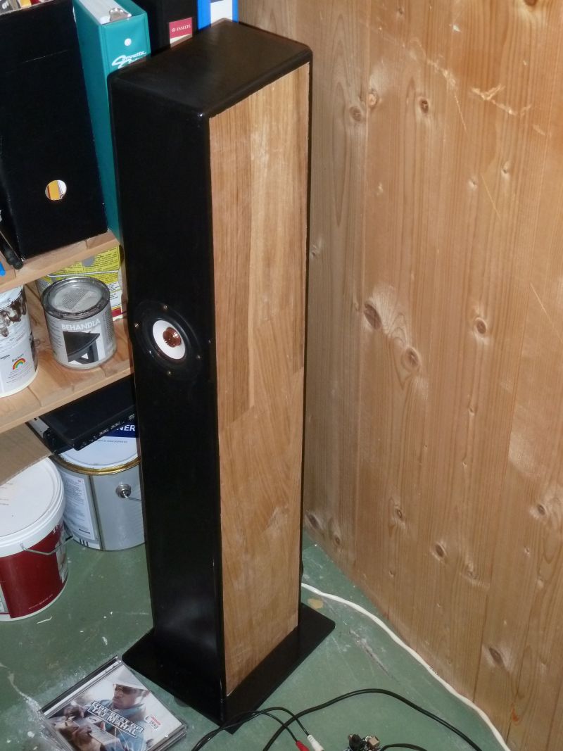

I just finished my TABAQ pair with this driver this weekend. And so far I'm amazed! They sound really nice with a lot of different music. Some things, like Led Zeppelin sound a bit harsh and thin. But I still haven't had enough time to experiment with placement, electronics etc.
They play music in a quite "laidback" way, which also makes them very relaxing and nice to listen to. Placed close to the wall in a small room (6-7m2) like in the attached picture, the bass is amazing and perspective quite nice. They also play more than loud enough for normal listening (IMO).
In the middle of a larger room (15-20m2), the bass is a bit lacking for some types of music, but then the perspective and realism becomes really amazing. Close to the wall in this room also works nicely with moderate sound levels, and the perspective is nice even with as much as 3m between them.
I run them fullrange without any tweeters, using only the baffle-step filter
as suggested in the tabaq design document.
If there is any interest in more details, please ask!
