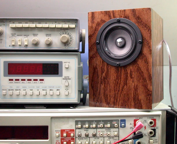

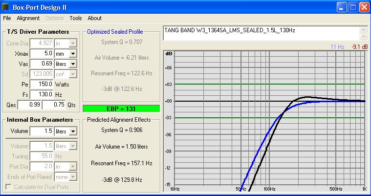

This is more to my taste. Just enough to squeeze in one of my tweeters. The VIFA xt25sc90 blends in surprisingly well with the W3-1364. All that's needed is a 4.7 ohms in series with a 6.8uF. Didn't have to use an inductor for the W3. Now, the vocals and the highs are much clearer.
