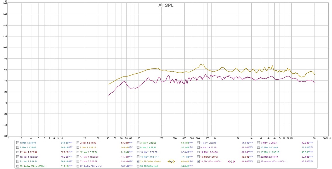

Thanks a bunch for the recommendations! I followed them and measured my speaker from 2" and from 2 feet, then encorporated the time delay in the 2 foot measurement. I might not have done it correctly because I am using the new beta version of REW, but these results look much more consistent. Unfortunately, I didn't get them lined up but yellow is the <500hz measurement and purple is the >500hz measurement.
Clearly, there is a roll-off at around 13khz and gently sloping bass up until around 130hz with a bit of a boost at 65hz (which could be the work of the vent).
Do you think I could cut another .5-1cm off the length of this vent to move the bass boost up a bit more? It still isn't too boomy (except at the peak of 150hz).
What is your verdict on this speaker and do you think I could do anything else to improve it? I'm thinking about adding some EQ at around 16khz until I can install a couple of tweeters.

Much better, although the scales are really hard to read on the graph.
Things from 500hz and up look pretty decent imo, and I don't really see any problems. Sure, a little bit of roll off in the top octave. In a car way off axis this would likely be a large roll off. So eq will only help so much. But worth a shot.
I think the most telling thing is your nearfield, yellow line. Looks like a classic case of having an undersized vented enclosure. You could try moving up the tuning, but not sure how much that'll help. Any chance you could just run it sealed and cross your subs in a little high, like 120hz?
