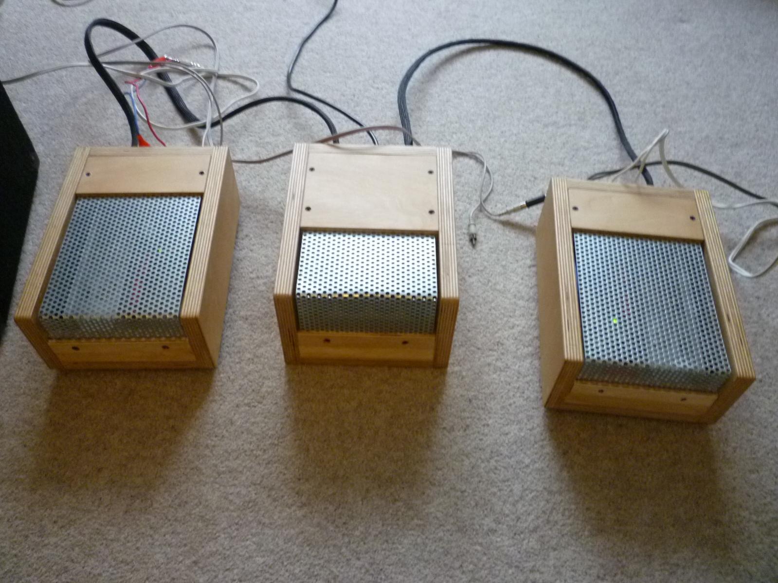

speaker - sidelined as I snapped up a pair of BK mosfets for the power amp for my second system; have been creating the attached with these. (modded within bounds of limited knowledge)
