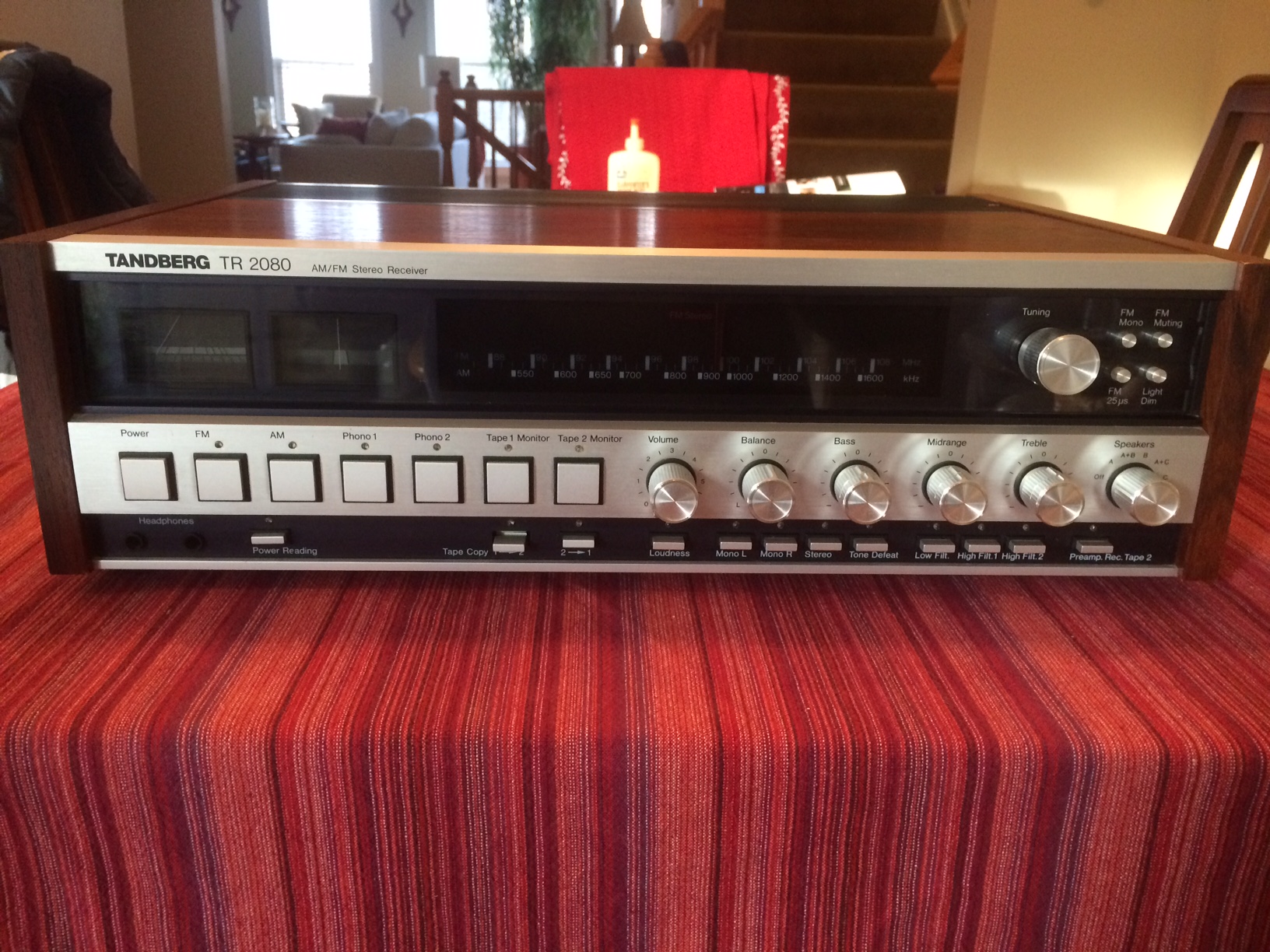

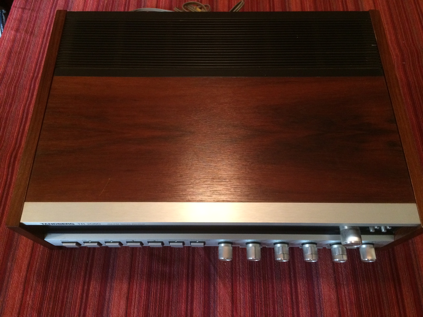

The wood case and front face look really nice, clean, no scratches or major blemishes. The only thing of note, the Tape 1 - Copy button is loose, looks like the plastic casing the goes around each of those buttons is missing on this button, but I do have the button. See pix of exterior.

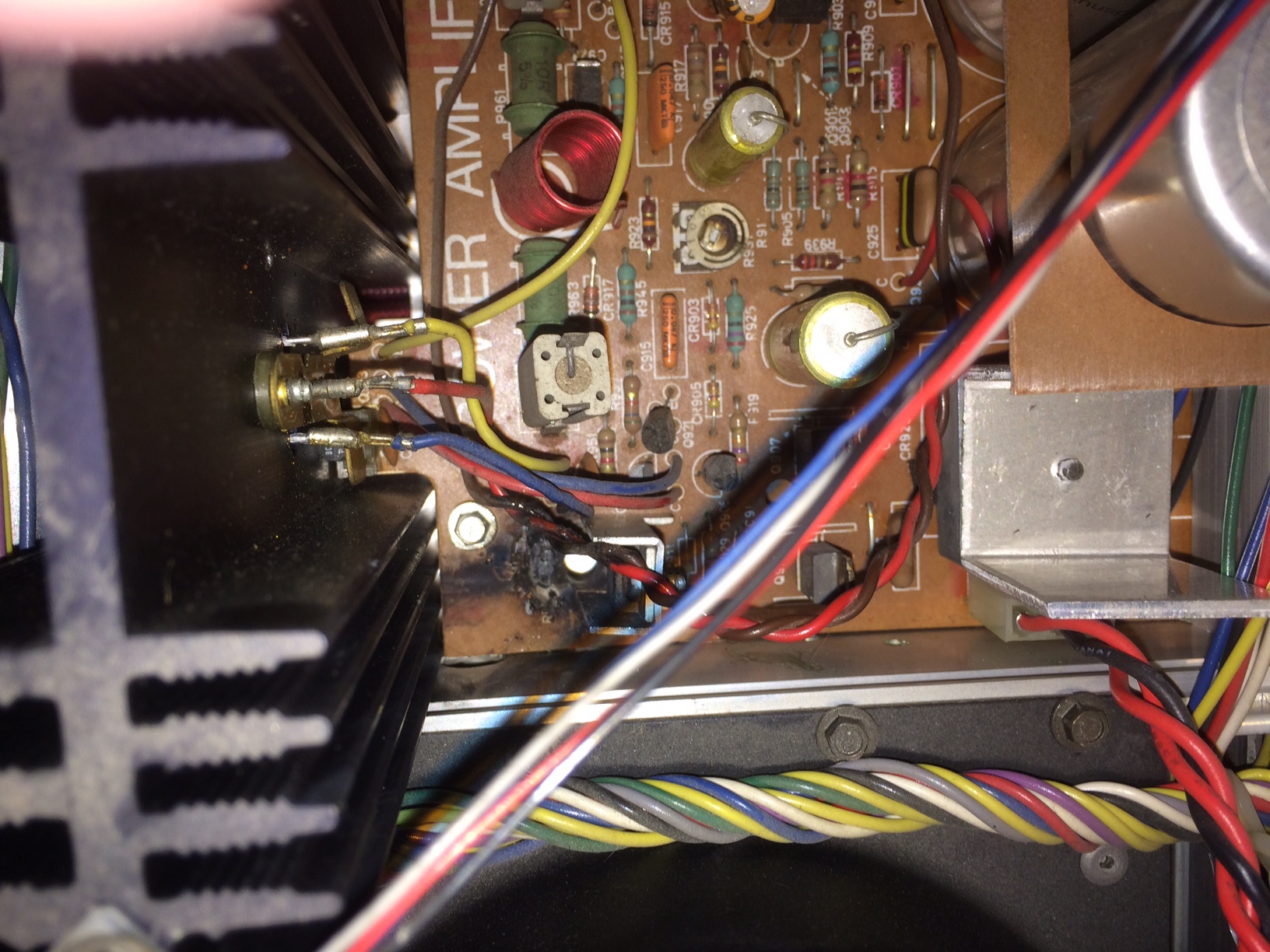

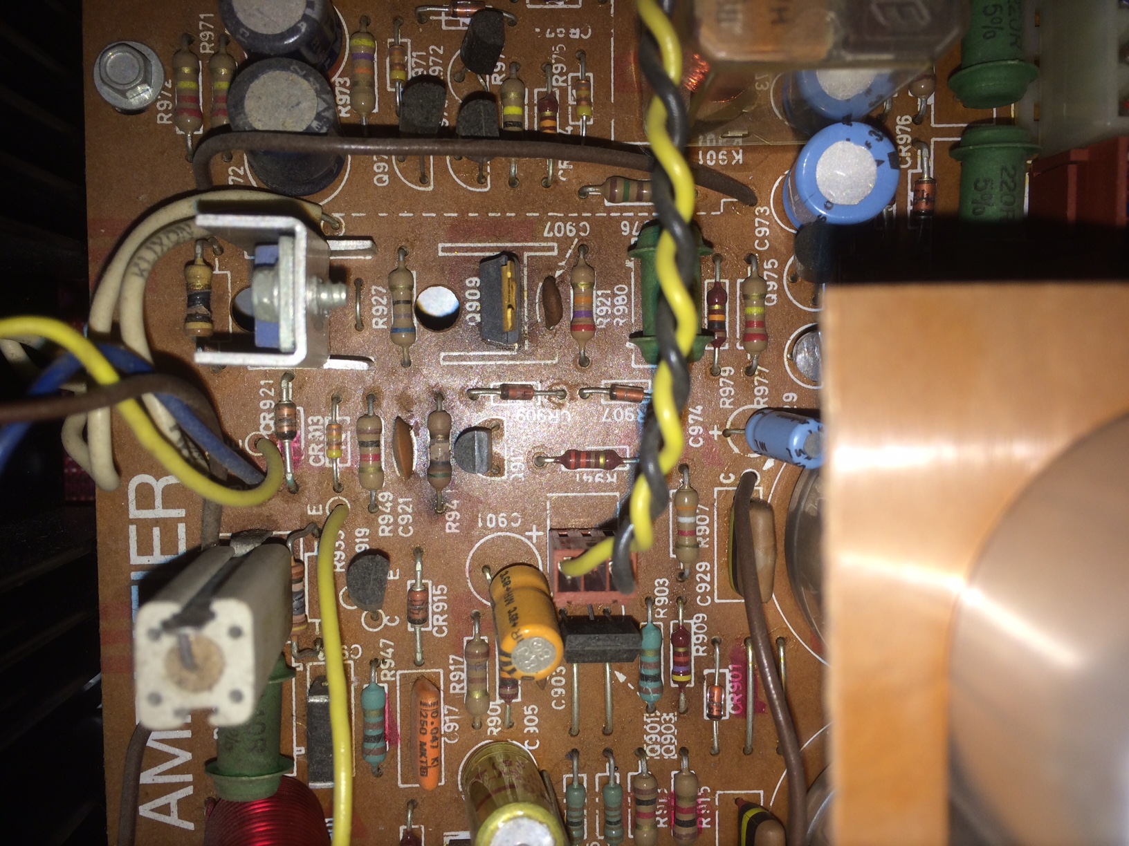

The bad news. Upon removing the case, I noticed dust build up on Power Amp board and did a good blow spray cleaning. As to the burn spot, both CR919 (diode) and R955 (resistor) are completely burned off the board. I looked over the rest of the board and found that R943 shows signs of overheating as well. This resistor is mislabled on the board as R941. All other components on the Power Amp board look ok, no signs of any leaking caps. See pix of amp board.
So as I said earlier, I can't make out values in the Service Manual schematics. Can anyone help me identify the values for these 3 components so I can see if I have any on hand or order replacements.

Looks like damage is to one channel only. I can locate the equivalent resistors for the other channel, and it looks like R955 is brown/black/brown (100ohm) and R943 is green/blue/red (5.6k). As for the diode, I can't see the numbers on the other channel.
So the 2075 Service Manual has better resolution over the 2075 Mk II/2080 Manual and I was able to make out D919 (not CR919). It is one of the rectifier diodes and part number is BY206. Mouser has these in stock.
Also, it looks like R943 and R944 should be 10k according to both manuals, but my R944 is clearly Green/Blue/Red (5.6k). R943 is too burnt to make out the red ring, but I can see the green and blue rings. Can anyone verify what the value should be? (Anyone have a 2075 or 2080 and can check theirs).

I have the BY206 diode and resistors on order. Still looking to confirm whether R943 and R944 should be 10k or 5.6k ohm.
I'm repairing a TR 2080 at the moment. I can confirm that R943 and R944 are 5k6.
