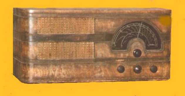

I searched the net, Solvsuper 1 came 1937-38.
I found numbers upto Solvsuper 12C on the net.
I guess the latest models used transistors.
At "Norwegian Historical Radio Society"
http://www.nrhf.no/nrhf-eng.html
you will find pictures of most Solvsuper models 1-12C
http://www.nrhf.no/nrhf-TR.html
Here is ´some pictures of a real oldie.
http://www.sparkbench.com/tandbergalbum.html
The picture below shows the first Tandberg Solvsuper 1
/halo

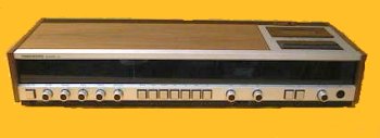

Its a tandberg solvsuper 12
Hi:
The history of this reciever: My dad purchased this during his college years in Norway (I am norwegian). He has a pair of speakers with it that have 8" (I think) drivers pointed up and four tweeterspointing in from each corner. The speakers are garbage... the tweeters are cracked, and the woofer dustcap is crushed. I might restore these at a later time...
Anyway, back to the reciever: It is a Solvsuper 12, without the built in cassete.
Here's what I want to do with it:
I would like to make it run off 120 v as opposed to 220.
I will build a separate selector box for attatching more inputs
And Id like to change the speaker connectors (the speaker cable requires little plugs that have one round pin and one flat pin) I would probably like to add banana jacks.
And if I can change/add components and get better sound I might want to try it. by the way, anybody else have one?

To make it run off of 120 volt, I assume I just change the transformer. Is this an area where I can upgrade?

Maybe I could help you with the powertransformer thing with your amplifier.
I don't think you need to change the transformer, you just have to change some wires coupled to the transformer.
I'm not absolutely sure but if my memory serves me right you don't have to change the transformer.
The Sølvsuper(or Solvsuper)products from Tandberg is extremely good products. They are solid and well designed, end here in Norway you often see them still in use.
I have done some service to a coulpe of Tandbergs products, among them a coulpe of Sølvsuper models, Huldra models and some cassette decks.
In fact I did some service at a Tandberg Sølvsuper 11 yesterday, it had an problem with the balancecontrol, so I just changed the pot.

But changing the wires will do nothing
of course you have to couple the transformer for 120V use. Changing wires to red or green, thck or thin will not solve this problem😀

Just looked at the transformer... thats a really easy fix...
question: the unit is not grounded. Should I connect a ground to the chassis?

Det å koble transformatoren for 115V er nok ikke så vanskelig nei.
Når enheten er kobla for 230V så ser en to ledninger som kommer inn fra 230V og er koble på transformatoren og en ledning på trafoen som kobler sammen to vindinger slik at disse er seriekoblet.
Her må en altså bytte om litt slik at disse blir parallellkobla.
Når det gjelder jording så vet jeg ikke helt hva som vil lønne seg. Jegh la merke til det samme ved Sølvsuper 11, at denne ikke var jorda, om det er noen spesiell grunn til dette vet jeg ikke.
Om du skal jorde eller ikke kan jeg heller ikke svare direkte på.
