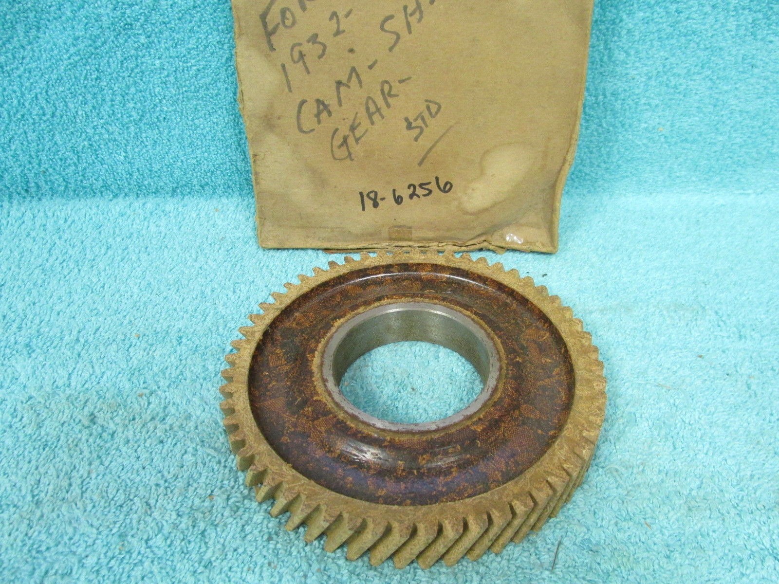

I don't tune my radio enough to wear the gear; maybe sdineen will. And not a comparable job, but--- the cam-drive gear in the Ford Flathead was a cloth-Bakelite composition very much like phenolic PCB stuff. These seem to last forever. (The stuff has gone out of style-- new replacements are Aluminum and accuse the fiber of being "weak".) OTOH this wore against a steel crank gear and was flooded with oil, and was a little large for its load to get enough center spacing over the crank.
