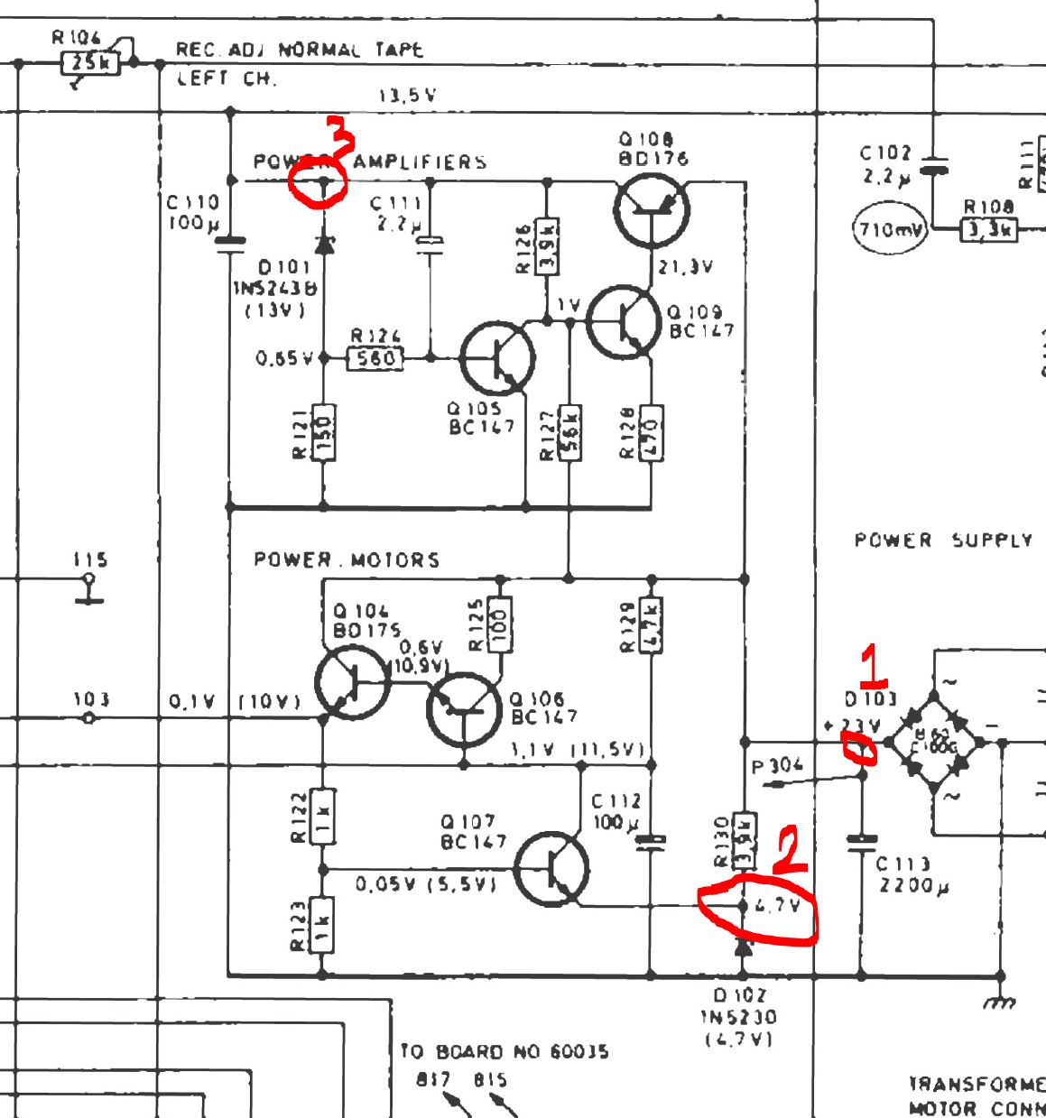

Thoughts: Here's where my head is being drawn towards.
The biggest current draw (relatively speaking) is the solenoid.... and the unusual thing is this deck has one solenoid but 4 connections on that solenoid .....
Is it mechanically latching somehow and there's a release coil within.? or is it feedback?
We've got:
Green - 23v (ever)
Black - ground.
Yellow - main control (decked when sol is actuated)
Blue - goes off to pause..........
And then theres MS2 mute switch (just above the solenoid) - what's weird about the depiction of that on the diag?.... the arrow in the middle to ground.... what's all that about😕
You did say it doesn't do the hum noise when you toggle pause when you're already in play mode didn't you? .... when in pause does the head plate fully drop back to stop mode position?.... or does it drop partially to just pull the pinch roller down a little?
I'm convinced the various switches (I'm calling MS1 into question too) are not operating when they should, to perhaps mask a perfectly normal heavy current draw when that solenoid kicks in before mute is released.
Maybe you could check the DC impedence of the solenoid .... and let's work out why there's four connections to it

Q305 Q306 seem to be a monostable with time-constant 22uFd+68k, a bit over a second, similar to your half-second event.
L2 Blue goes off-stage at the top. To what?

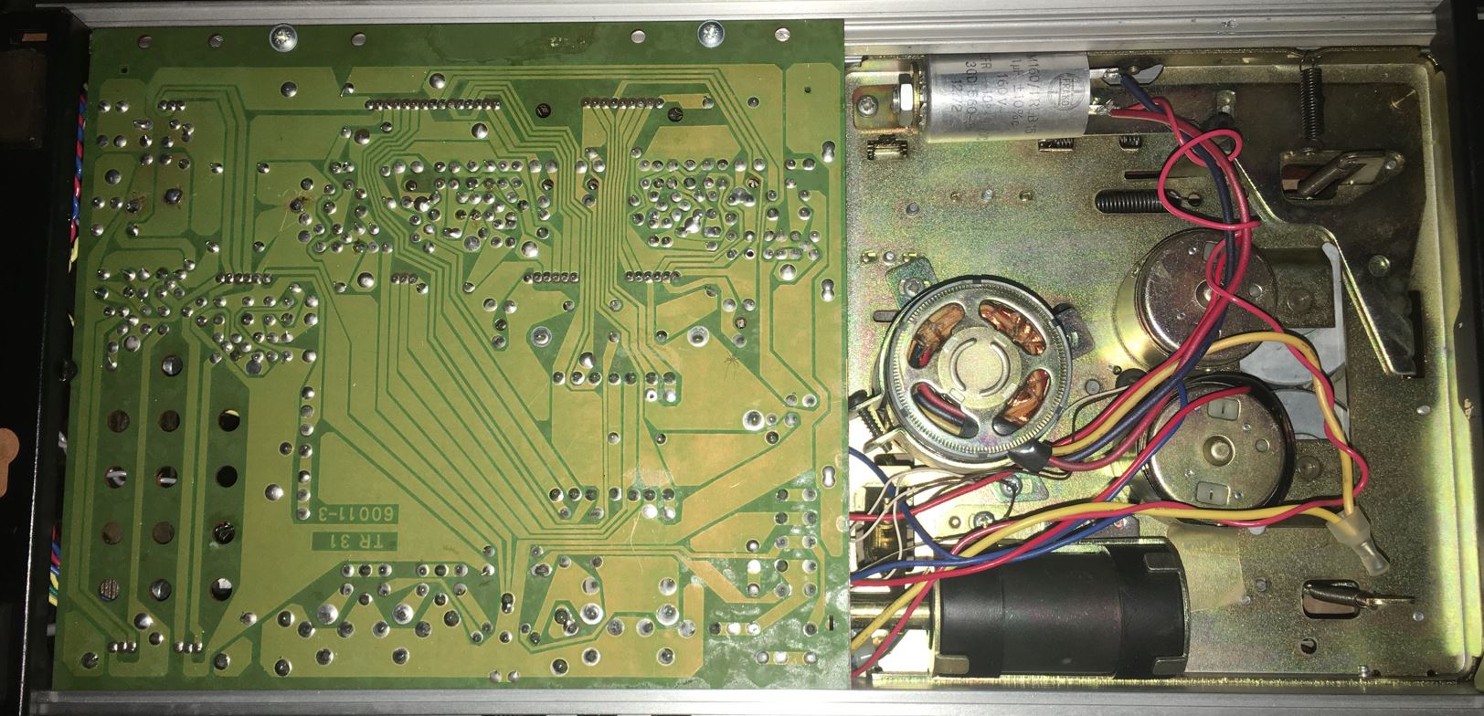

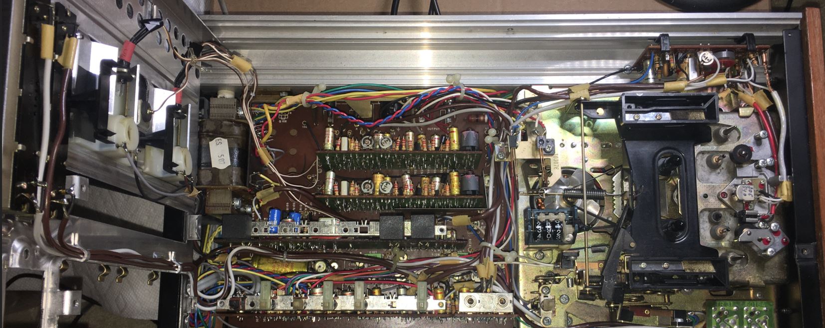

Sorry for delay in getting back on this. I was figuring out how measure these currents as these wires are in inaccessible places. Luckily no soldering was required 🙂 I could pull the pins and measure the currents
To answer some of the questions
- Yes, the capstan (dual) motor runs all the time and its an AC motor
- There is One motor for Wind and another for Rewind
- Upon play click the Wind motor is turning on and the Solenoid is pushing the head towards the tape
- Yes, it doesn't do the hum noise when Pause is toggled
I will try to upload some video. There is a size limit so I might need to upload to YouTube.
Here are some tests I did
Motor Currents (Wind & Rewind motors)
Wind/Forward Motor:
On Play Click : 314mA (Max)
While playing: 314mA
On Forward click: 620mA (Max)
While forwarding: 233mA
Rewind/Reverse Motor:
On Play click: 50mA
While Playing: 20mA
On reverse click: 600mA (max)
While reversing: 230 mA
Solenoid ( Yellow wire):
On Play click: 550 mA
while playing: 0mA
Solenoid ( Green wire):
On Play click: 500 mA
while playing: 0mA

First quick thought is that those currents sound sky high for the motors. Lets see what the others think to that. 314ma while playing sounds quite a lot. When rewinding and fast forwarding everything should be free and easy to turn... so why so high.
Brakes sticking? or back tension band sticking/incorrectly adjusted (does it have one of those 😀)
The solenoid looks like it could be a type that is just energised momentarily to pull and latch it one way or another and then the current is turned off rather than a type that needs to be continually powered.

Replaced the bridge Rectifier and it has fixed the hum problem. Now the voltage is not dropping on pressing the play button.

Oh wow, well done. I know I mentioned the bridge back at the start but never really expected it to actually be that. That really would have been at the bottom of the list.
Very very rare indeed.
Thank you Mooly. Yes, you have mentioned about bridge in the initial post. The bridge was tested ok in and out of circuit and that is the reason we didn't focus on that. Thanks again for all your valuable suggestions. Learned a lot from this post
