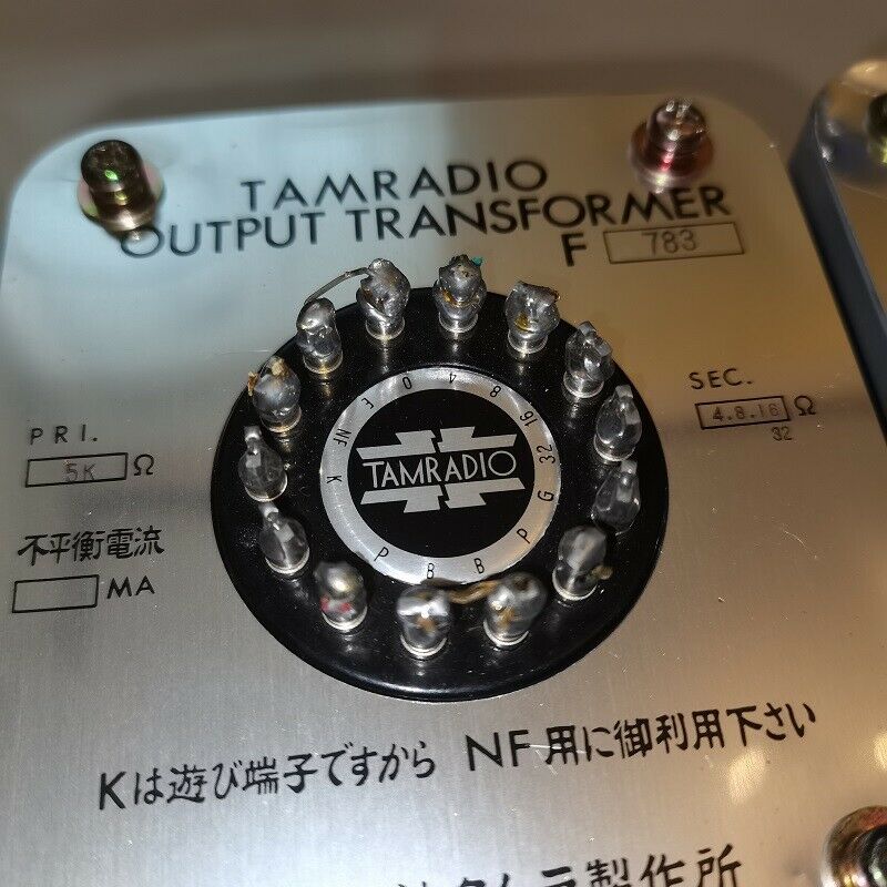

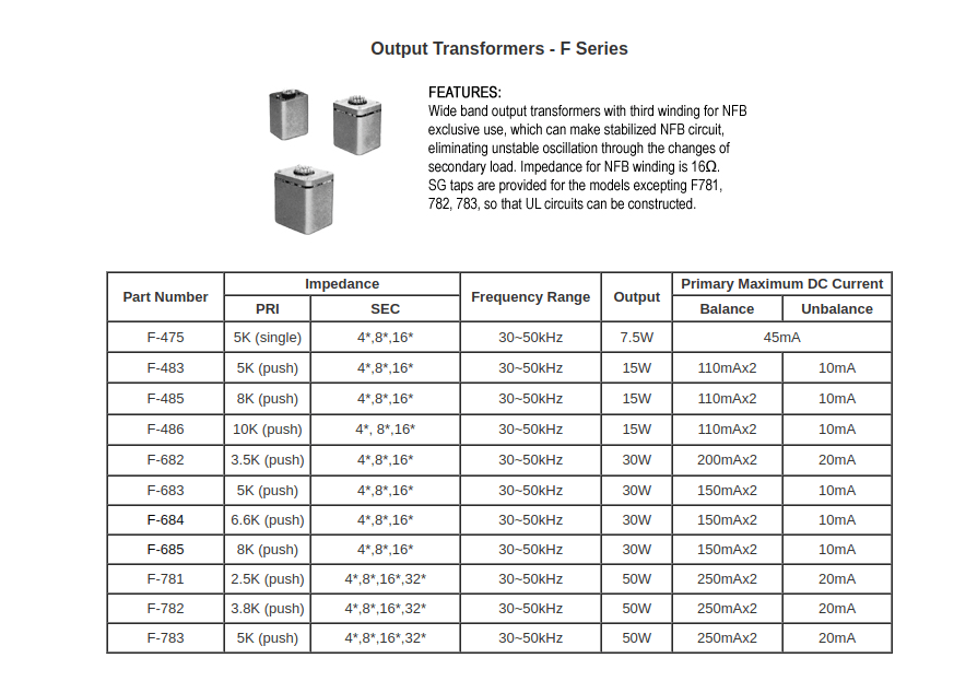

I don't understand the FEATURES explanation.

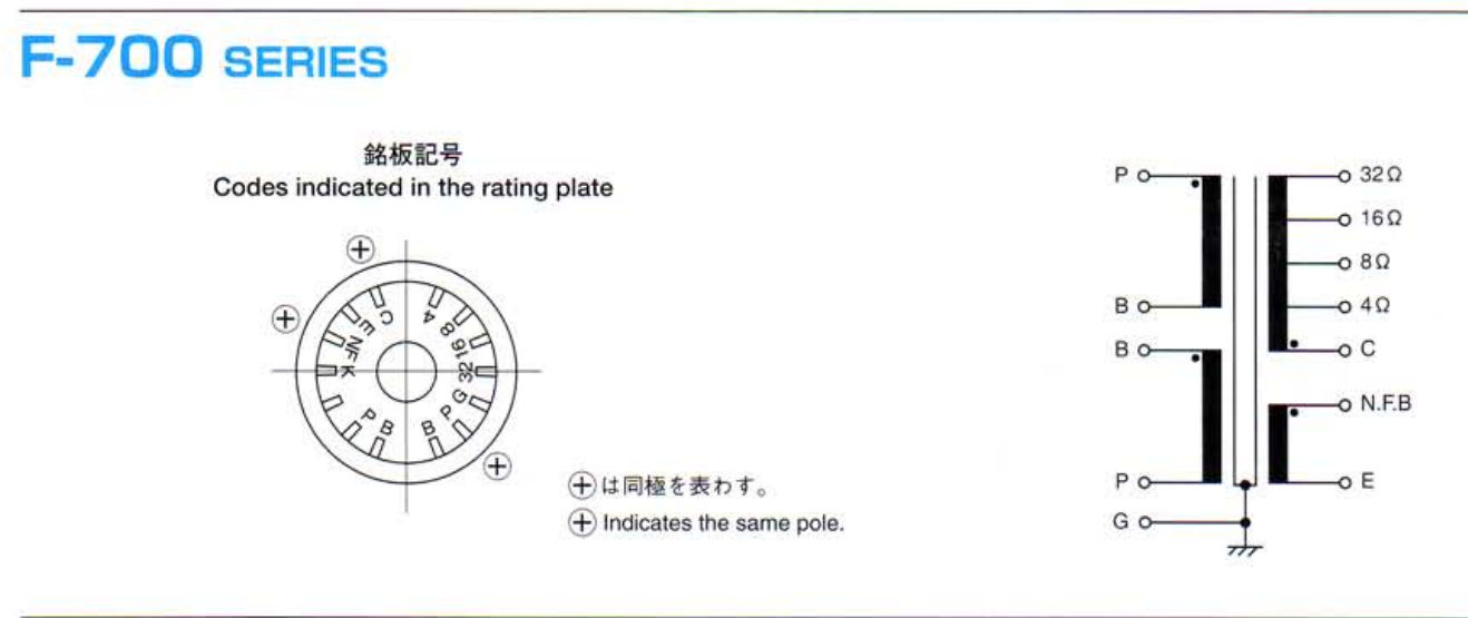

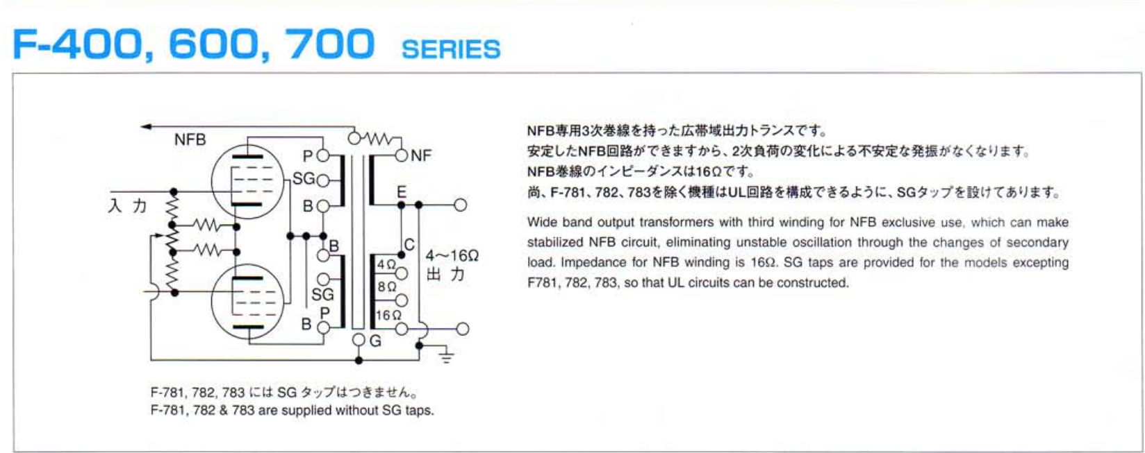

Is it CFB? I see only one NF and K connection.. for a PP transformer.
And only one G (grid #1?)
