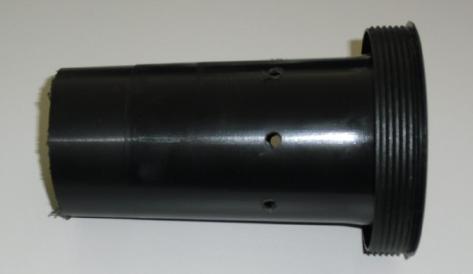

Yamaha has an expired patent on a small Helmholz resonator placed somewhere along the vent (opening connected to the vent) which is aiming to counteract vent resonance. Never tried it, so don't know if it works.
In general, I try to keep the cutoff frequency for the bass driver before the first pipe resonance. If this doesn't work, the only option is to decrease the diameter of the vent and shorten it. Or live with it.
Yes, that works - can simulate in Akabak and works in practice. Just set the length of the stub ("T" to the vent near one end) to the 1/4-wave of the resonance you want to squash. Stuff the stub with fiberglass. Typically, the resonance will be at the half wave of the vent, so you will need double the length vent for the stub. Can all be done with PVC piping and T fittings and caps.
