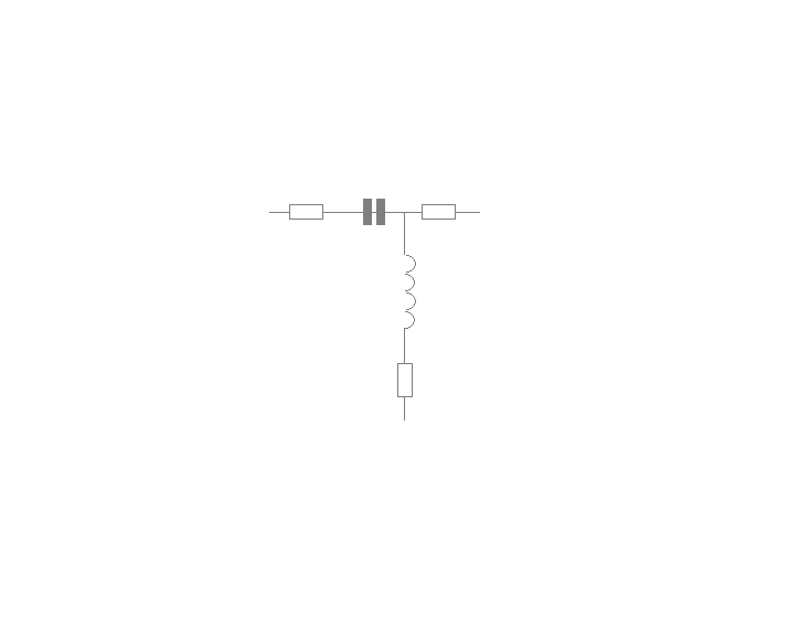

In the unmodified KG4.5 schematic (post #10 in this thread)
I think you're correct that it's indeed a 2nd order with some tuning on the capacitor. Sorry for the confusion.
I will do some simulations for you later. I can't find any specs on what the crossover frequency is between the woofer and horn tweeter. Any ideas?
Also, is the schematic in post 10 the original crossover of the KG4.5?

Only specs I've been able to find:
KG 4.5 | Klipsch
Michael:
I don't know what the xover frequency is supposed to be. Klipsch specs don't say. It's a fairly cheap horn tweeter (although a Tractrix horn).
The schematic in post #10 is the original, and matches what is in my speakers.

With the crossover as is for the tweeter, the cut off frequency is about 15 kHz. Below that, gradual muting towards silence of the mids. That set up could drive any one nuts.

The 2 ohm resistor in series with 33uF cap across the woofer -- That's not a zobel, is it?
It is not a Zobel. Neither does it matter. Any cap with resistor in this position will attempt to move the filter towards second order electrical with some limitation by the resistor, and by the woofer's impedance. Nothing will modify the woofers impedance, for all intents and purposes the RC only modifies its appearance. Nothing special will happen if the R and C values happen to be those of a Zobel, and there is no particular reason why they should be those values.
So far in this thread there is no hard evidence by which to judge the crossover.
I think that would be to balance the response of the horn, which would have an unfiltered efficiency of something over 100dB/1w/1m, with the response falling off drastically as you go up in frequency. Maybe the SPL is the target 93 to 95dB at around 15kHz, the filter rolls off as you go down, which counteracts the increase in SPL from the horn as you go down in frequency.

If the woofer had a DC resistance of 2 ohm, the original set up could well be a Zobel. But to put a 1.0 mH inductor on that would mean a cut off point of 300 Hz, which is bizarre. The nature of the original crossover is a crossover point of 800 Hz, with extra loud bloating around 600 Hz. The original crossover is horrible, painful to listen to.

try a series resistor between xo and driver(tweeter) 😀
the one shown before first cap, is that a variable resistor 😕

The RDE 070 is a resettable fuse on the tweeter. Klipsch owners can be a rowdy bunch! These speakers are from down in Arkansas, ya know...
I was told by Bob Crites (who specializes in upgrades for Klipsch stuff) that I don't want to take those out of there.
