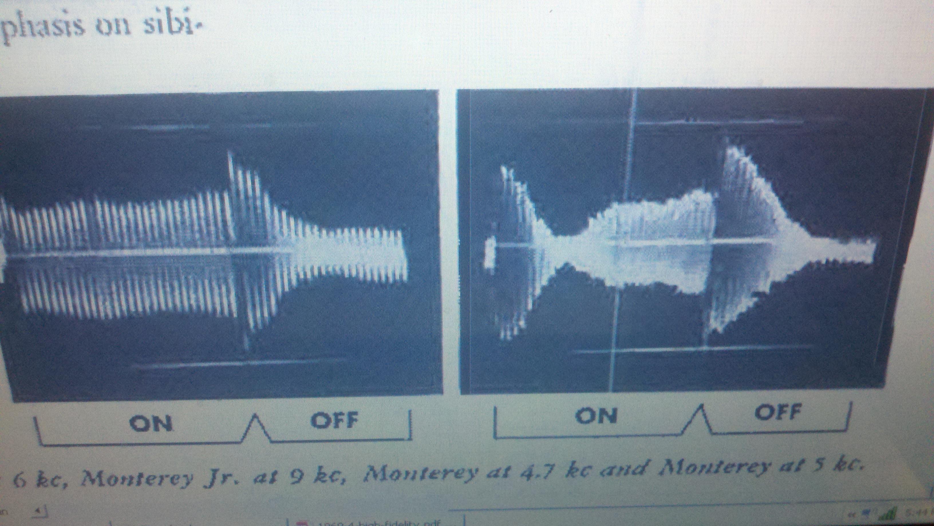

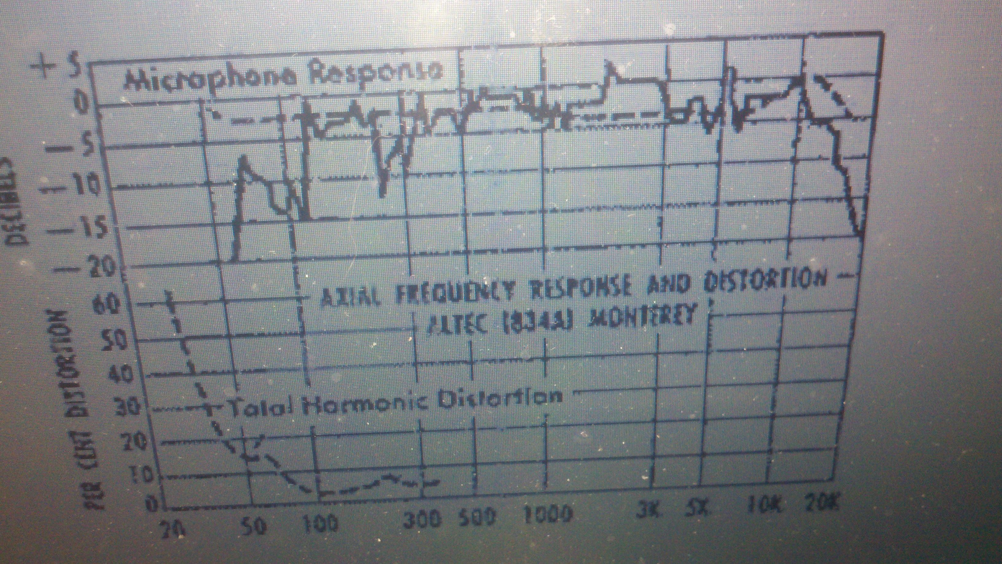

I recently acquired a pair of Altec 834A (Monterey) speakers and I'm quite pleased with the sound. I did hear a problem in the 4 to 5k range and considered using EQ to tame what sounded like typical horn coloration. The Monterey uses the Altec 3000B compression driver with a sectoral horn. Earlier, more collectible versions of the horn were made from zink and were multicell. The later "B" version is made from fiberglass and is not multicell. All versions use a very light, delicate microphone diaphragm. After digging around I found a test report from a 1960 Audio Magazine. The reviewers were using a new measurement technique; tone burst response. They detected serious ringing at 4.7 and 5.K (see first photo) Output at 5K was actually higher after the burst than before!
My question is, where is this ringing coming from? I know about tar filled larger horns from Altec, so is it the horn structure itself ringing, the driver itself, or the shape of the horn? I would love to tame this problem, because otherwise they are a great sounding speaker.

If you mean the Altec user's board, it's impossible to register there these days, so I can't post or even search there. If you mean the Lansing heritage site, I'll give it a shot, but things move glacially over there unless you're discussing current high end JBLs. Female vocals are where the ringing is most audible. The extension on this driver is amazing. The curve I posted doesn't show it because of the rolloff of the measuring microphone, but I understand it has usable output to 27K, which must be rare for such an old design.

FWIW, stock 511s ring too, even bolted to a baffle board. It is, as you say, very annoying. My cure is to fill the bells, and essentially pot the outside of the horn in a thick layer of polyurethane construction adhesive. Done properly, the horn is then very neutral sounding. A similar cure would probably solve the 3000B problem.

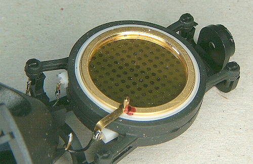

Something like that could easily be removed from the diaphragm again, if it turned out to be not the reason:

Flat diaphragms are the worst shape concerning resonances.
I would glue a cylindrical piece of damping foam on the center. Someone who is a fanatic could try to convert it to a balanced mode radiator by adding masses.
The diaphragms are exceedingly delicate, I'd be a little wary of trying this one.

Definitely the horn ringing, at least in the case of a 511. Originally you could tap the bell and hear it ring. Zilch used a DE250 driver for his test, which has a very flat, resonance-free response.
