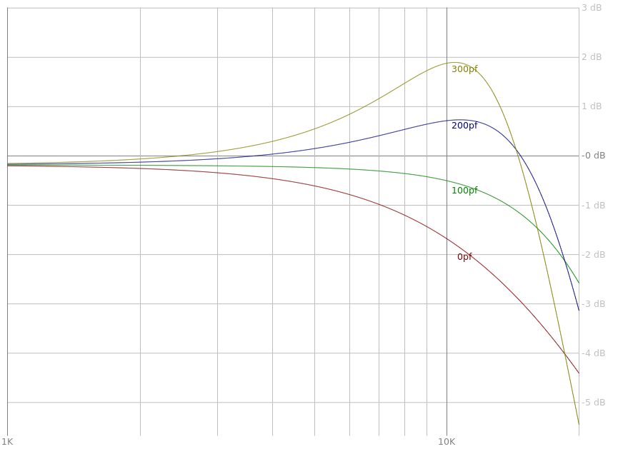

I have owned this cartridge for two decades. It has always been a bit bright. Audio-Technica recommends 100-200pF total load for the turntable, cable, and preamp. This is a low value.
I estimate my system had ~300pF. So, I removed the 100pF loading capacitors from my DIY preamp.
The difference is apparent. The AT440ML now sounds smooth. 🙂
The Internet has a lot of posts about brightness in Audio-Technica's current models. If you own one, make sure that the capacitive loading is under 200pF. 47K resistance works well.

Glad you have noticed this. The AT generator is capable of very flat performance (dare I say up with the best) if you get the capacitance under control. A total of 150pF would be ideal but as the cables alone can account for all of that you need a phono stage with low input C and removable loading capacitors.

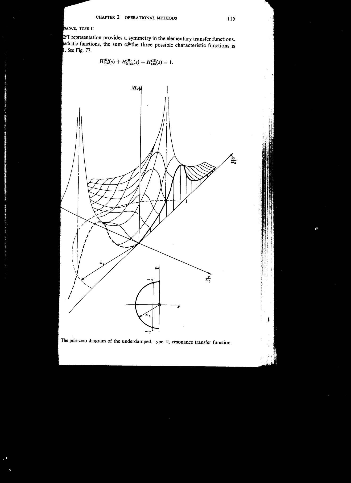

Don’t depend on the manufacturer to give you information on the cartridge termination that sounds the best. They terminate their cartridge for flattest frequency response, and they do this by peaking the electrical response by using an electrical Q greater than 0.707. Back in the 1970s I tried various terminations and went so far as to put my preamp in the plinth beneath the tone arm to minimize the cable capacitance between the arm and preamp. I decided that you just aim for a Q of 0.6 and to heck with the frequency response. There will be more attenuation at the high end but there isn’t much music out there so you shouldn’t care. Why a Q of 0.6? That’s because it’s almost phase linear. If you look at the Q of a two pole phase linear Bessel filter, the poles require a Q of 0.57, so 0.6 is close enough. I found a picture of a two pole frequency response in an old text and it shows what you are dealing with. You have a zero at the origin (the cartridge doesn’t produce DC) and at infinity (the cartridge doesn’t reproduce to infinity) and two poles you can move around. You can’t do much with two poles, so just go for phase linear. I think that sounds best.
