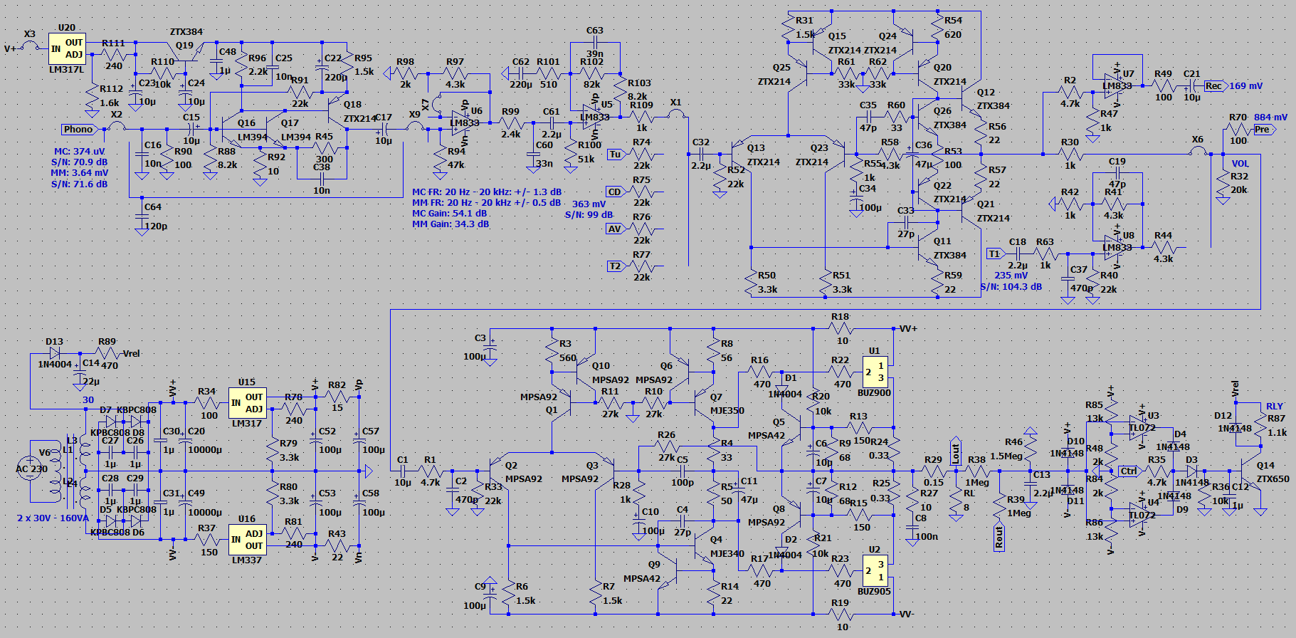

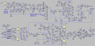

I have this amplifier which, believe it or not, I won in the UK magazine HiFi Choice competition they run every month when I was living there back in ´97... I've modded it in several stages, the last one a couple of years ago and, as I was tidying up my LTSpice circuits folder, I realised I'd never shared anything about it. Since there's very little info to be found out there other than the user manual, which I uploaded myself to HiFi Engine here, I thought I'd post at least the stock schematic in case any owners (if any left!) google for it. Note that the sensitivity, S/N and FR figures shown are simulated, not measured.

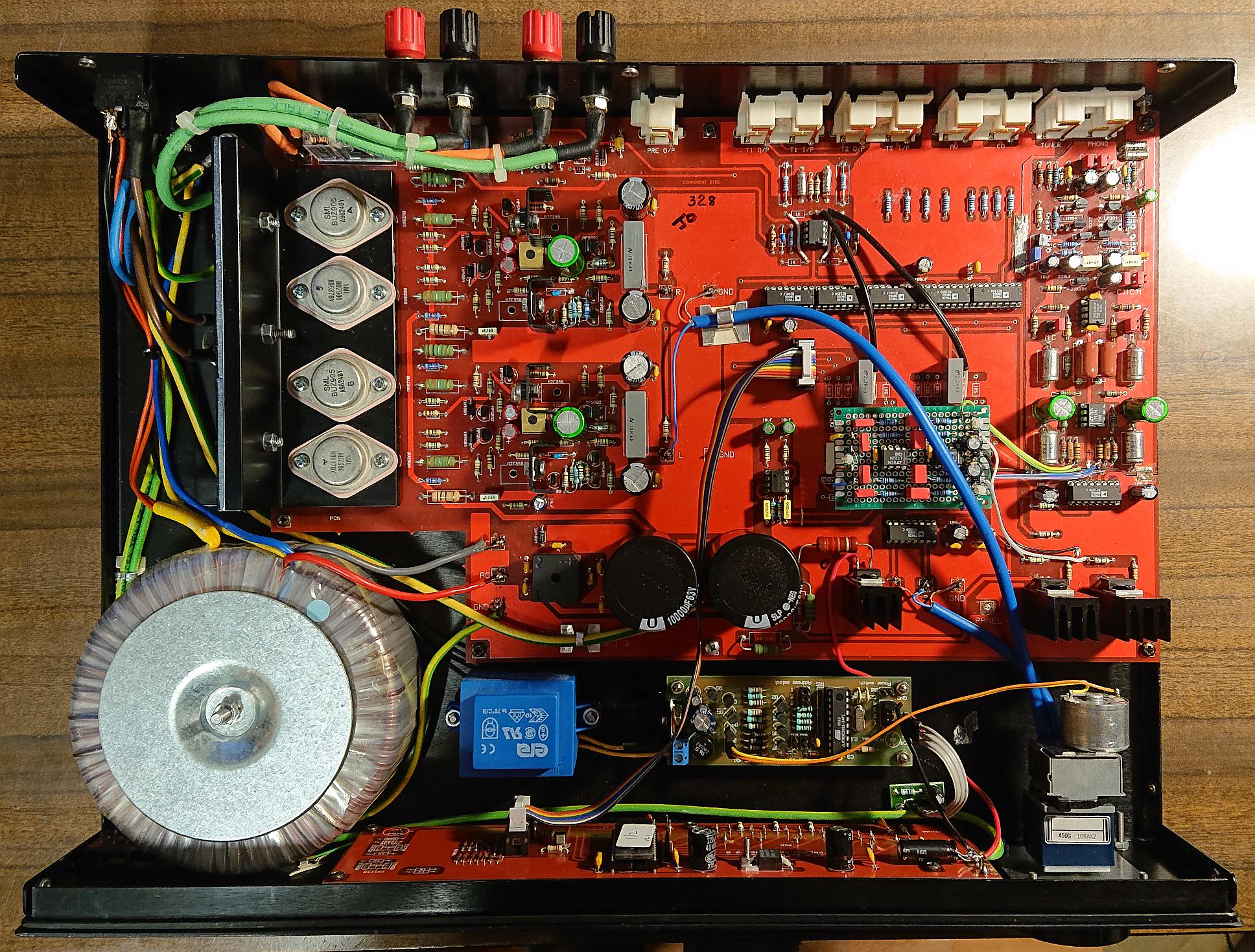

I've also attached a picture post-the last mod, I have some more detailed ones if anyone is interested (sorry, I didn't keep any before pictures). The little transformer and PCB at the bottom are a remote volume control kit from Dantimax, the small PCB on top of the main one is a 4th-order Butterworth high pass filter I put at the output of the phono preamp to get rid of a nasty 10Hz resonance in my cartridge and underneath it is where the discrete preamp used to be, which I removed and replaced by re-purposing the opamp that was the input buffer for the Tape 1 input. I also modded the phono preamp and the output stage. I can go into more details about the circuit and my mods if anyone is interested.
