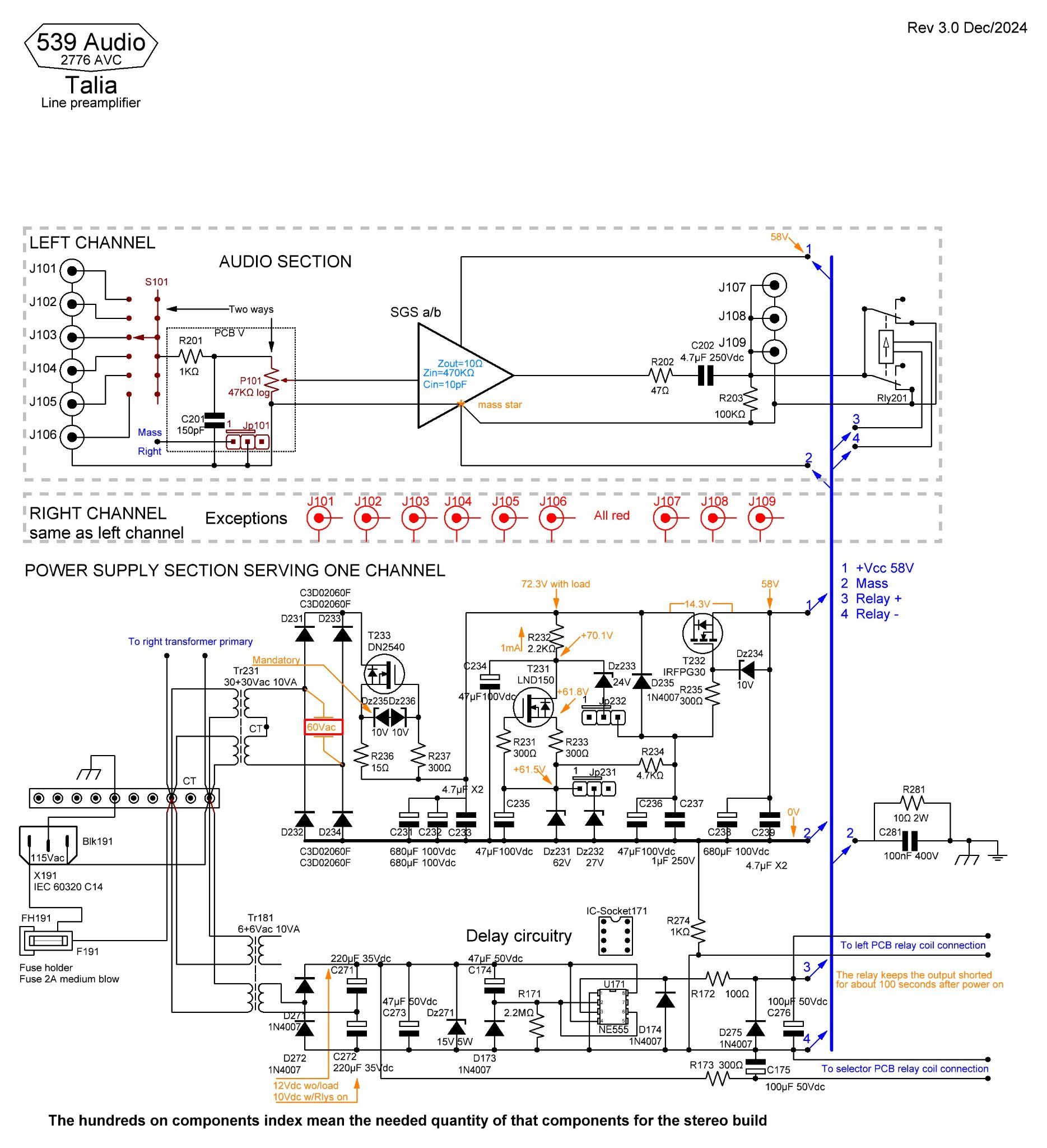

Functional blocks:
  • SGSa or HDP01 (SGSb) module for signal amplification;
  • low-pass filter at the input, inserted in the volume potentiometer board;
  • Virtual Battery type power supply;
  • delay circuit that keeps the output short for about 120 seconds from power on;
  • input selector (optional) made with miniature relays, and a small power supply.

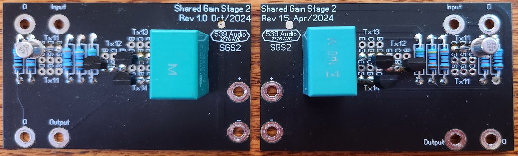

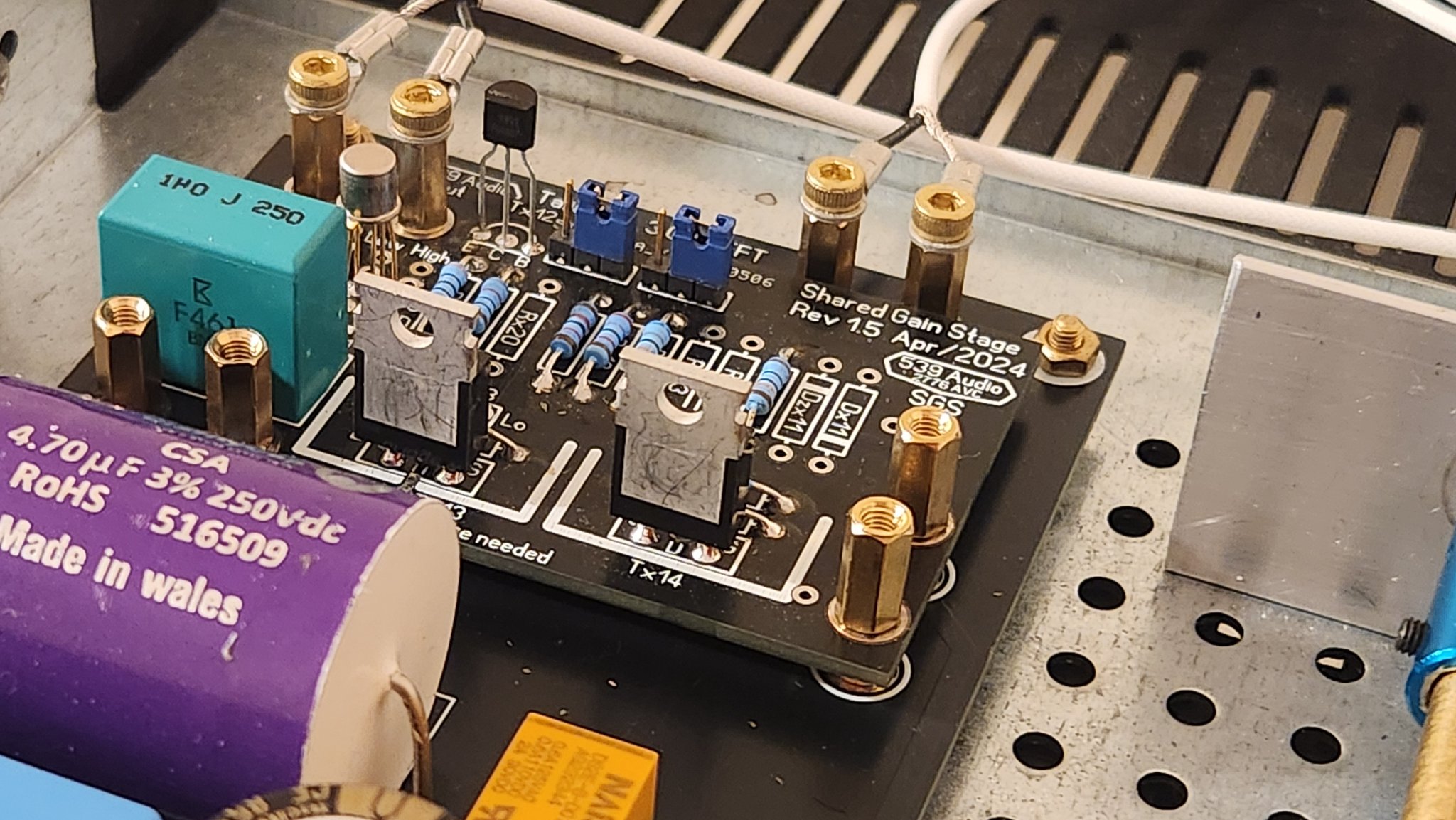

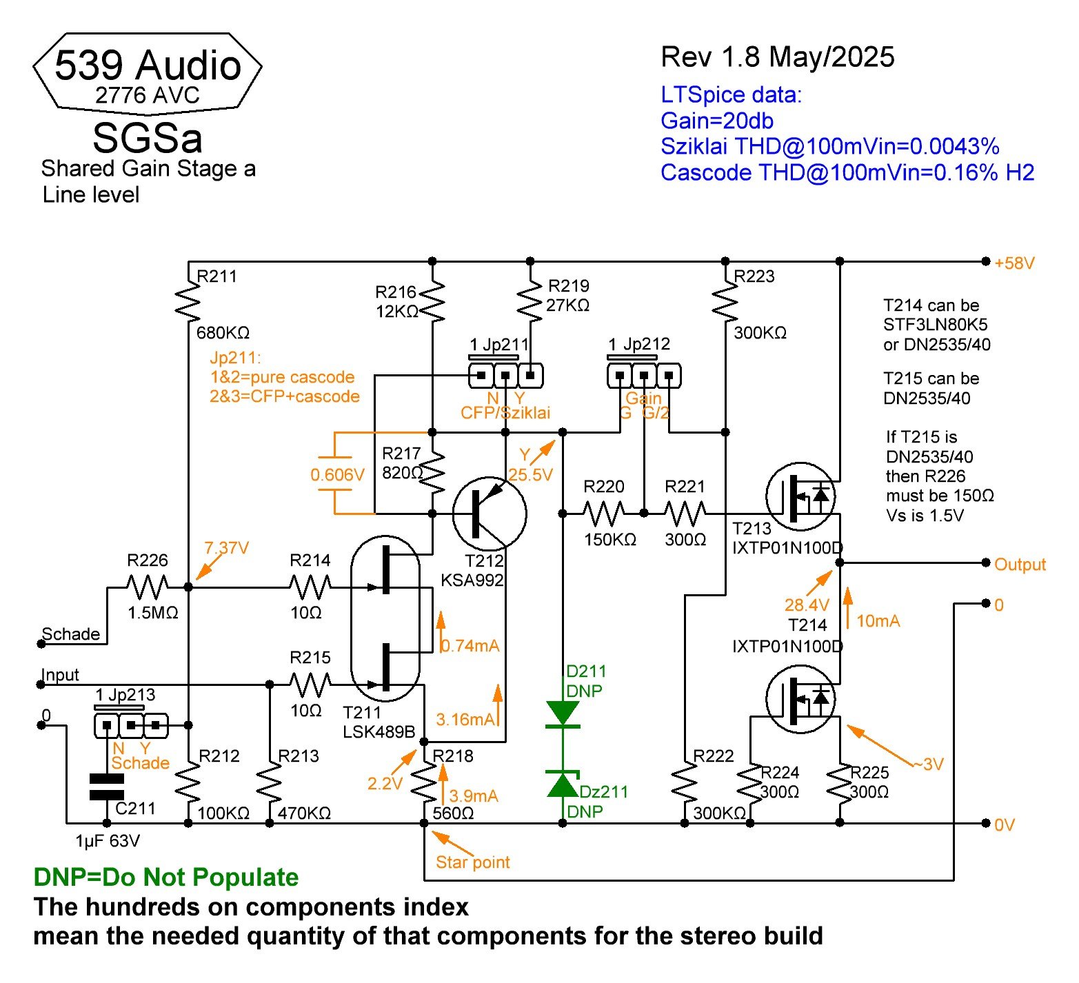

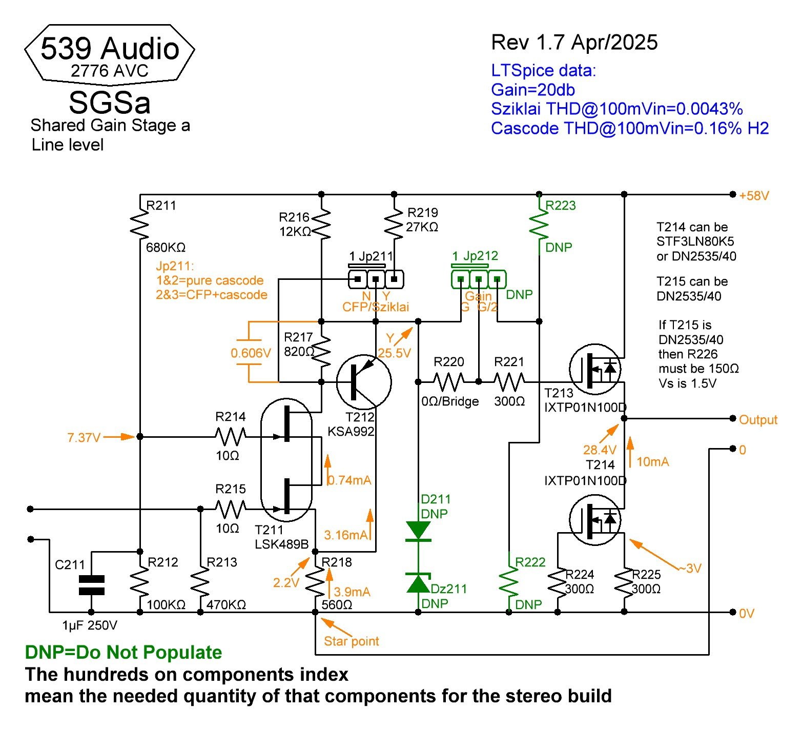

SGS module (schematic in picture 1, PCB in pictures 6 and 7).

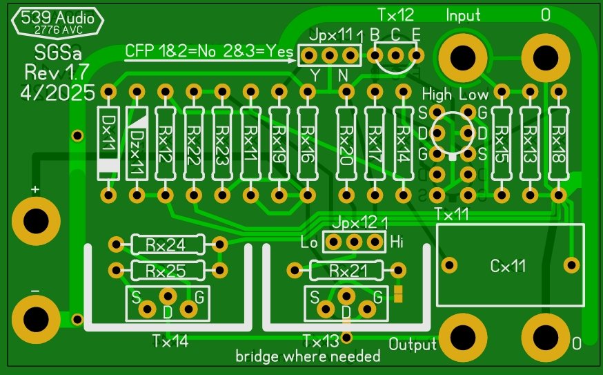

I will not describe the tuning work on the SGS module; from the schematic, you can see a JFET cascode connected with a BJT in CFP configuration (developed by engineer George Clifford Sziklai in the 50s). The BJT increases the JFET cascode's transconductance and its linearity. In this case, we are not looking for a particularly high gain, but we want the amplification stage to be linear across the entire audio band, a fact guaranteed first by the cascode, and then improved by the BJT in CFP.
Which JFETs should I use for the SGS module intended for the Talia? Even if I started with the LSK489A dual JFET to set up the Vera, ending up with excellent results, when I came to set up the Talia, I preferred the LSK489 selection B (LSK489B), which allows an easy configuration for the gain we are interested in. Selection B has a dispersion of the characteristics that is decidedly less wide than selection A. I verified that there is a good chance of being able to match two LSK489Bs acceptably by purchasing only three.
The gain stage is followed by a source follower loaded by a CCS set to 10mA. The depletion MOSFETs seem to be made specifically for the CCS configuration, so I used an IXTP01N100D, which is expensive indeed. According to the opinion of most audiophiles present on various forums, it is one of the best devices for this use. I had some, so I also used them as followers with excellent results. I believe that the cheaper pairs STF3LN80K5/DN2540, and DN2540/DN2540, which do not show any lack of availability, can guarantee the same qualitative results. In other projects, I used the DN2540 with excellent results, but on the net, it is not much appreciated. Sometimes, it happens that a component gets a bad name just because someone has used it badly. A voltage of 60V keeps the JFETs safe, without particular precautions, keeps saturation away, and allows the gain stage to remain linear up to over 10Vrms output signal. Unluckly I lost the LTSpice simulations, and I don't know how to use it fully to replicate the same simulation conditions; I hate its CAD for drawing circuits, but having received the schematic .asc files from a gentle forumer, who is passionate about it, I was able to run several simulations and determine the values of the resistors to use.
A side note: bootstrapping the CFP seems a good idea, but it is not. I tried: the gain increases way too much, and the hiss too. The same behavior is expected if you load the CFP with a CCS.

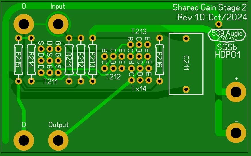

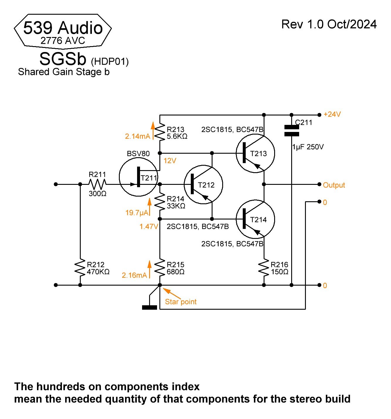

HDP01 module (SGSb - schematic in picture 2, PCB in picture 8).
This is the project by Eng. Maltese presented on the Italian magazine Costruire HiFi #61, which I refer to for the complete discussion of the project. I copied it as is, without changing anything. I have always been attracted to its circuitry. I designed its PCB to be mechanically compatible with that of the SGS.

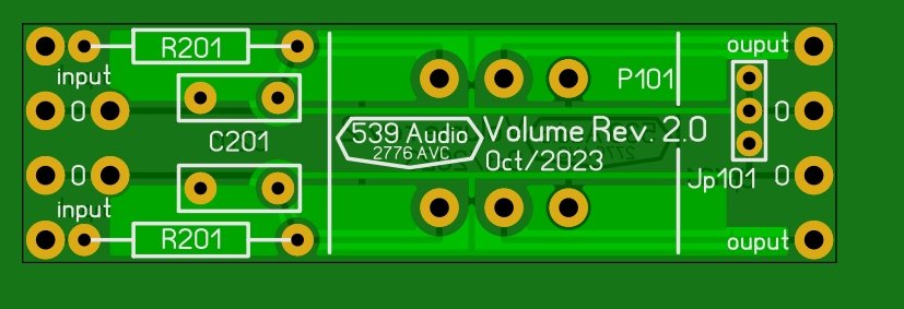

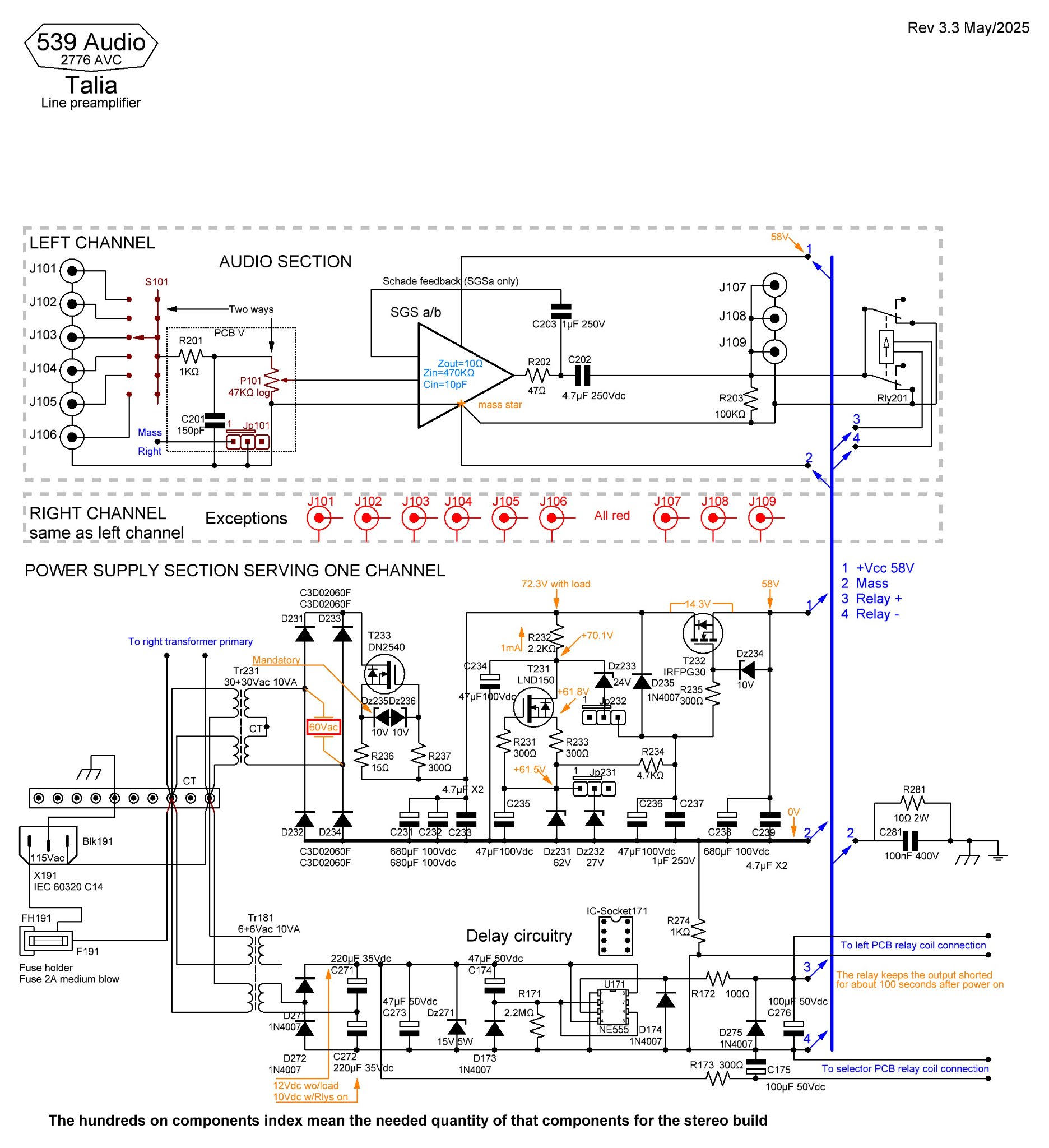

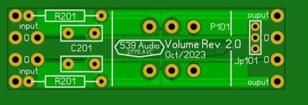

Low pass filter (schematic in picture 3 - motherboard PCB in picture 10). It prevents high-frequency disturbances from reaching the amplification circuits. It is a simple RC circuit housed in the same PCB that connects the hot side of the volume potentiometer to the center pole of the selector and the potentiometer slider to the input of the motherboard.
Virtual Battery power supply (schematic in picture 3, PCB in picture 9). It is the main power supply of the Talia, its circuitry has been known for a long time. I believe it comes from Technics; in my versions, there is always a CCS to drive the Zener diode, preceded by an RC filter. The voltage thus obtained is filtered and sent to a further RC filter, before driving the gate of the output MOSFET. Not being a supporter of feedback, and not requiring a lab instrument precision, my preference for solutions intended for HiFi has always gone to the Virtual Battery circuitry, which has never disappointed me.
60V configuration for the SGS module: set Jp231 open (2&3) and Jp232 closed (2&3). We obtain a 60V output to power the SGS module. Some may wonder why Dz233 is present. Here's the explanation: given the long time constant imposed on the charge of C235, C236 (resistors, capacitors, and the charging current of 1mA), waiting for the voltage to stabilize would become exhausting. Dz233 brings the gate drive voltage almost instantly to the Vin-Vz value, about 40V. Then the voltage continues to rise due to the time constant and the value of the main Zener diode; Dz233 ceases to exist because the voltage at its ends goes below the Zener threshold, and the rise time of the last 20V is entrusted to the time constant mentioned above. This fact is not very decisive in this configuration, which only supplies 60V, but it has its weight when the voltage to be supplied is 300V.
24V configuration for the HDP01 module: to obtain 24V, a voltage suitable for driving the HDP01 module, Jp231 (1&2) must be closed, which puts Dz232 into the circuit at 27V, and consequently Jp232 must be open (1&2), since the “accelerator” function is no longer necessary, indeed, it would overdrive Dz232.
The stabilizer is preceded by a depletion MOSFET connected to the rectifier bridge, configured as CCS, and used as a damper; it limits the turning-on peak and the capacitor charge peaks, and greatly attenuates the disturbances on the power line due to diodes' switching (thanks to Eng. Chiappetta - project Valvolinea). Pay attention to the "Vgs off" of this mosfet (T233), since it determines the value of the resistor connected to its source (R236). The value on the schematic (15Ω) may vary depending on the Vgs off, the goal is to obtain around 72V with load on the + pole of the first capacitor (C231), so vary R236's value according to this.
Delay circuit (schematic in picture 3, PCB in picture 9). It ensures that the output is shorted for approximately 120 seconds from the moment it is turned on. It consists of a timer made with an NE555 and a relay for small currents, whose coil is driven by the NE555 after the time set by the constant R171/C174.

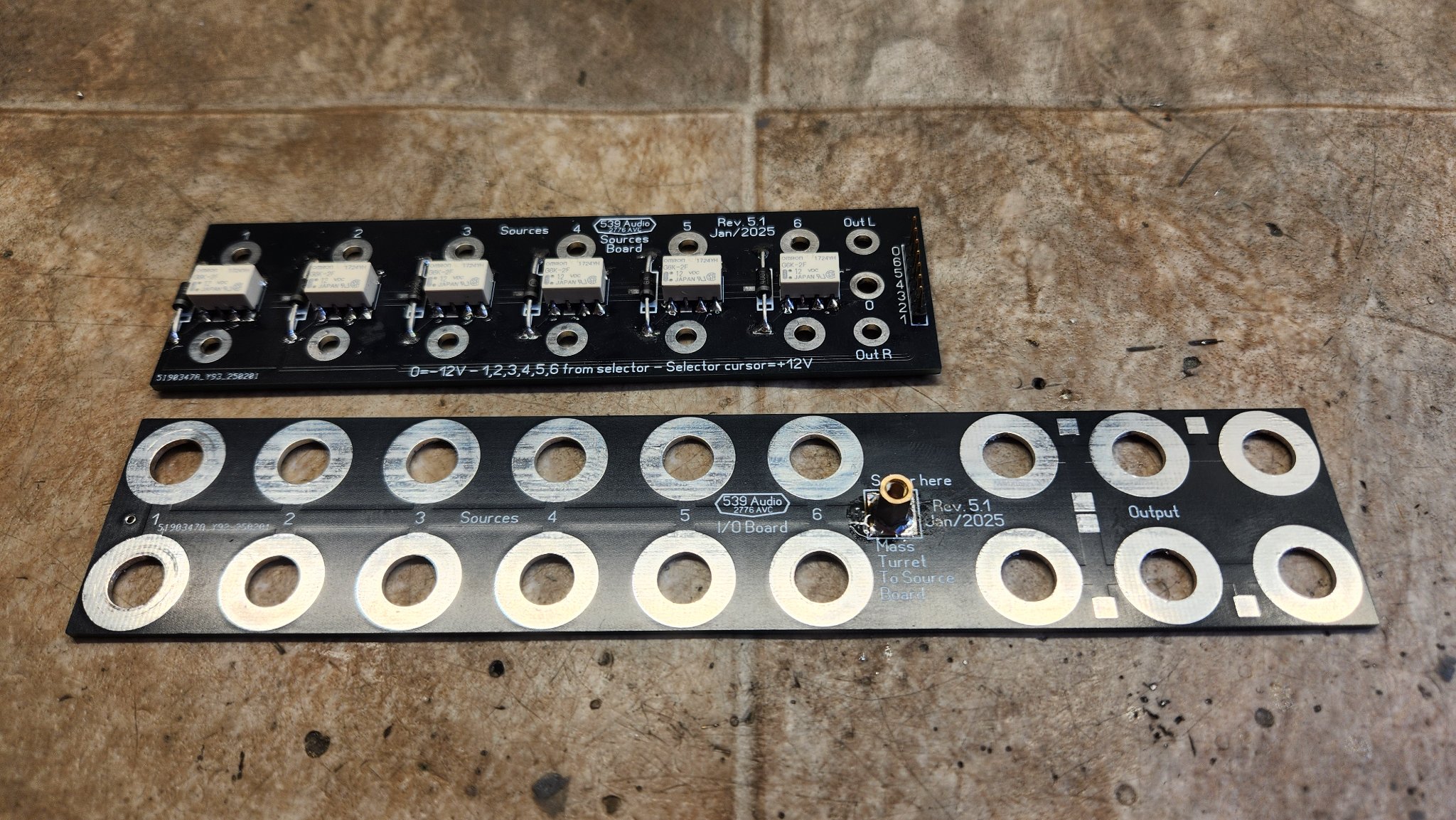

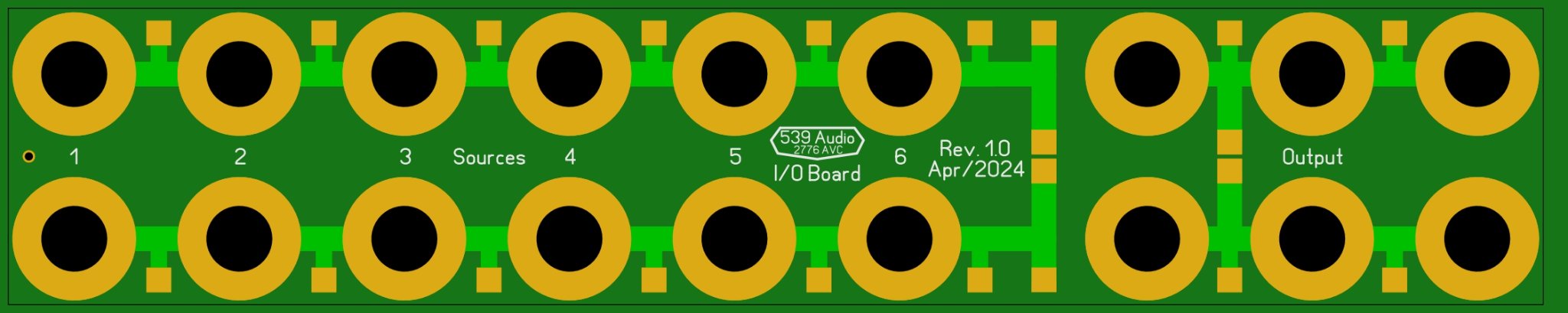

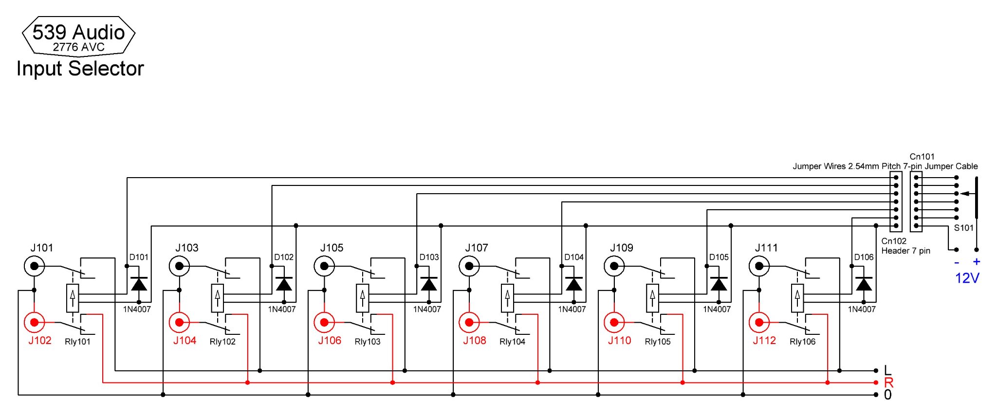

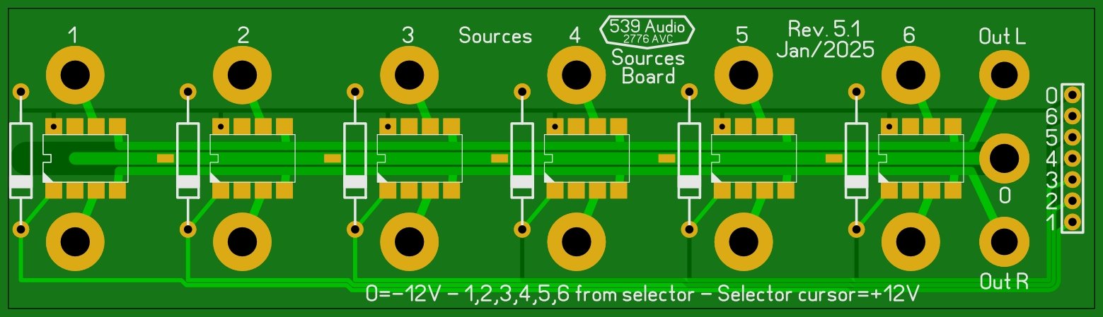

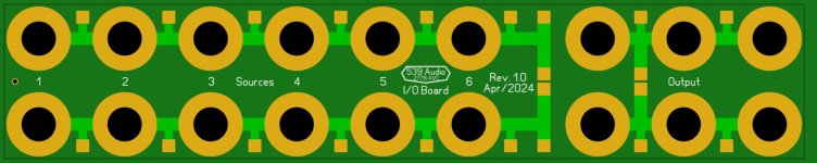

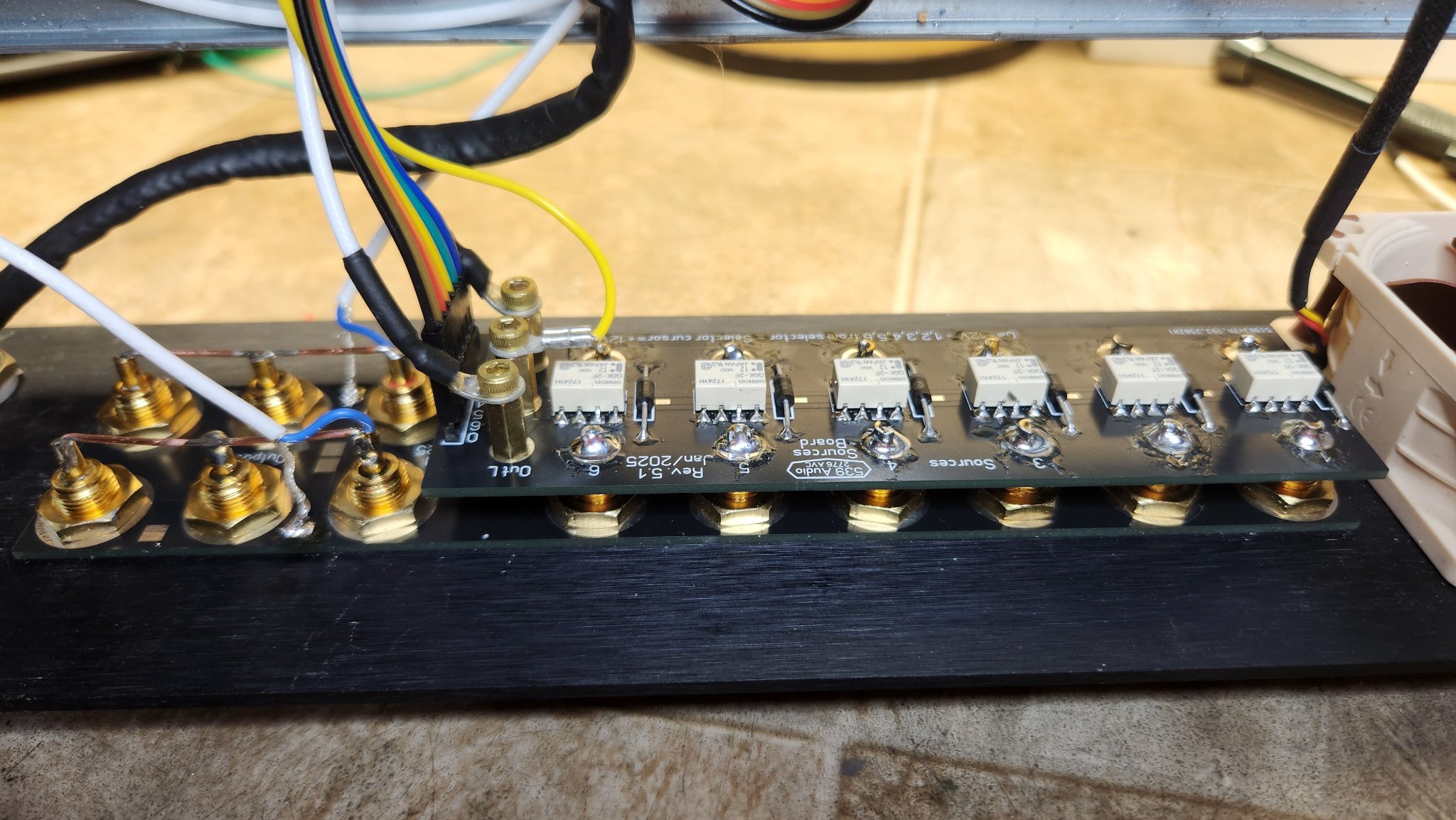

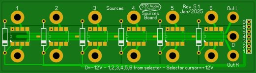

Relay input selector (schematic in picture 4, 2 PCBs in pictures 10 and 11).
It is optional and uses 6 miniature relays with contacts in an inert atmosphere. Their coils are driven by the rotary switch placed on the frame, 1 way, cheap, but reliable. The switch sends to the single relay to be activated the voltage of a power supply similar to that of the delay circuit.
The power supplies of the delay circuit and the input selector have “tube” origin; they use the heater secondary (6.3Vac) by duplicating its voltage to serve the relays. From the schematic, the two power supplies are not evident, it seems to be only one. Being a dual-mono project, the selector power supply is mounted on the PCB of the left channel, and the whole delay block is on the PCB of the right channel. The silkscreens help to understand which components to mount where.

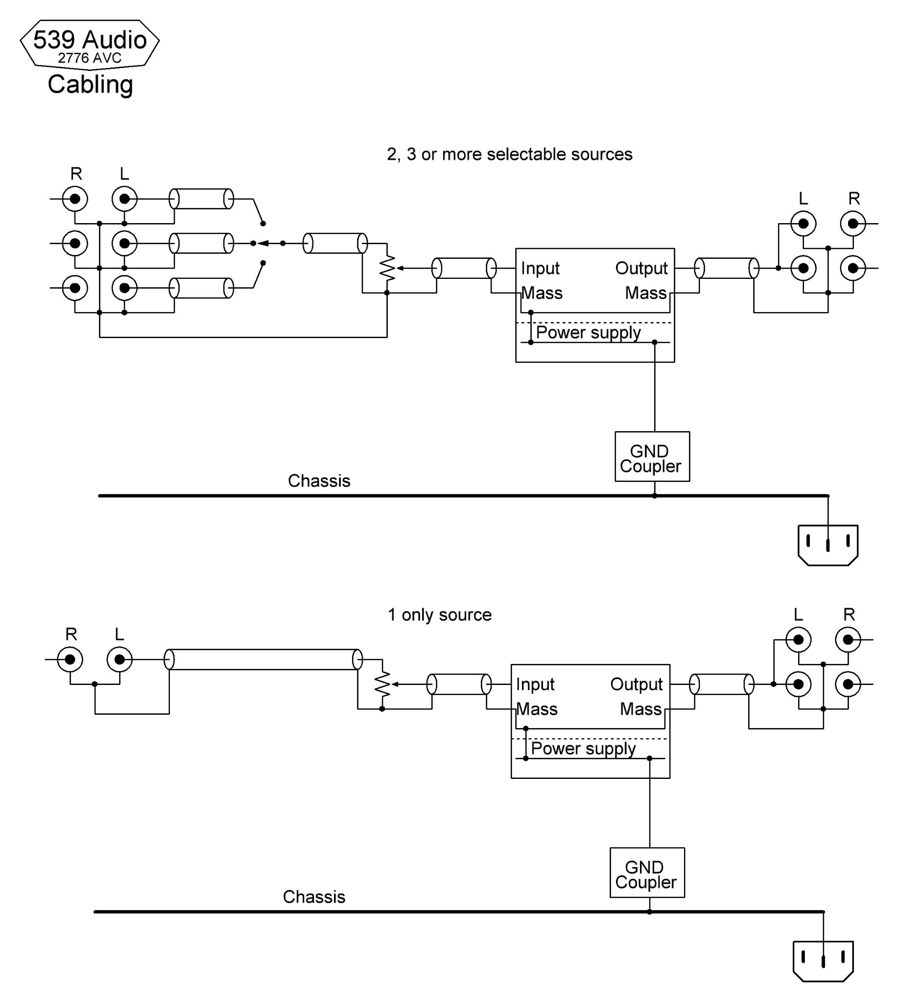

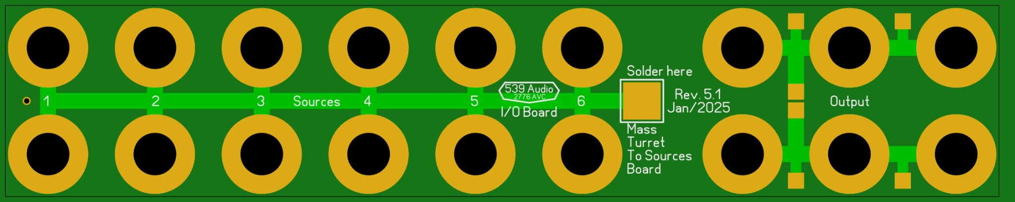

Input and output wiring.
Three solutions are possible for connecting the inputs:
• wired connections, as per the schematic in picture 5, which involves the installation of 12 shielded cables whose braid must be connected only to the ground of the RCA pins, while the opposite end, connected to the selector, does not have the connection of the braid, so a heat-shrink tube must be placed both to isolate the crown of the braid and to mechanically reinforce the central conductor; in this case the selector must be two-way, and of excellent quality; the schematic guarantees a correct path of the signals and the grounds;
• connections made with miniature relays, schematic in picture 4; for the wiring, again consider the schematic in picture 5, starting from the central contact of the selector, which can be cheap, but must be reliable;
• use 12 pieces of unshielded copper wire, of excellent quality, to connect all the inputs to the selector, which in this case must be of excellent quality again.
I chose the first solution, even if the 8 minutes of work for each wire make this activity very boring, which I had to spread out over 3 days. I also see the second solution as a good one, but I have never tried the alternative of unshielded wires; it is used by many DIYers, but I cannot say if it is a good solution.
The last connection to make regarding the input signal is between the volume PCB and the motherboard, also made with a shielded cable, following the wiring schematic.
For the outputs, use the same shielded cable already used for the input signal.

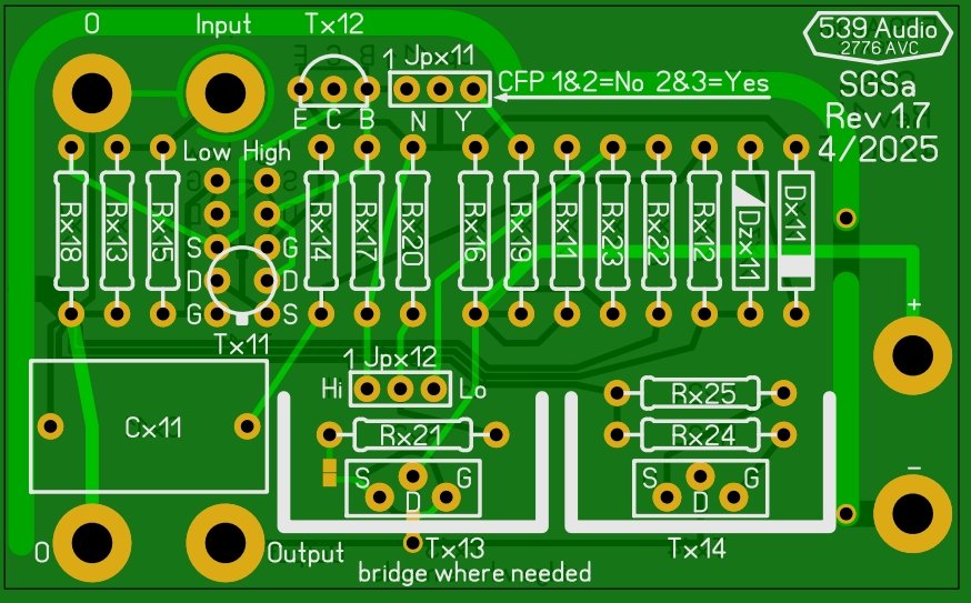

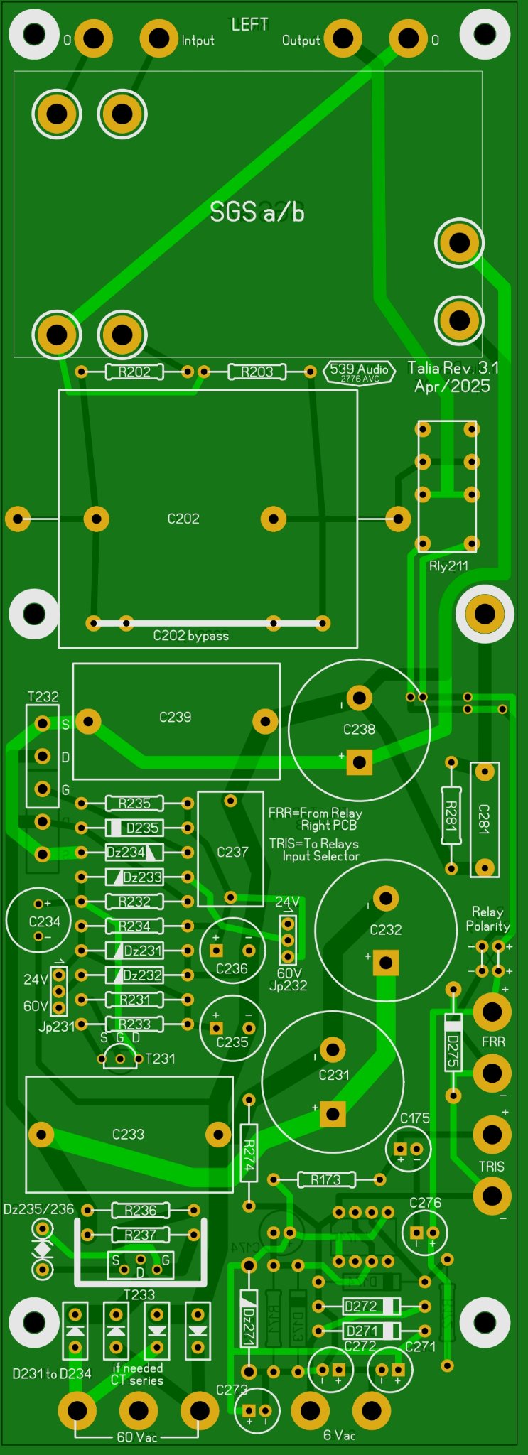

Printed circuit boards. The PCB of the SGS module (pictures 6 and 7, quantity required: 2) is the result of a unique, reversible design to give a symmetrical appearance to the internal assembly of the preamplifier.
IMPORTANT - sometimes the components do not match between the two faces (see T211, R224, and R225); it is not a silkscreen error. Near T213, two jumpers must be made between the two pairs of small SMD pads that are very close to each other; these jumpers swap the G/S of T213, and are made with a drop of tin on the face opposite to the one where the components are mounted. One pair of pads is behind the drain, the other pair is in correspondence with the gate or the source, depending on the face considered. If you forget to activate these jumpers, the module does not work. Thanks to this shrewdness, it was possible to keep the PCB unique, reversible, and symmetrical.
The PCB of the HDP01 module (picture 8, quantity required: 2) is also reversible in symmetry and allows the use of most JFETs and BJTs available on the market.
The PCB of the motherboard (picture 9, quantity required: 2) also derives from a unique, reversible, and symmetrical design: to assemble the two channels, simply mount the components on one face for the left, and on the other face for the right. Since everything is arranged reversibly, except for the NE555 socket, the delay must be mounted on the PCB of the right channel, and the power supply for the selector must be mounted on the PCB of the left channel.
Nothing prevents that, for needs or opinions that I cannot imagine, one uses the same face of the aforementioned PCBs to create the whole assembly, which will then not be symmetrical. In this case, the right faces must be used for both channels, due to the non-reversibility of the NE555 pinout.
Volume PCB (picture 10, quantity required: 1), solder it directly to the potentiometer; it contains a low-pass filter to eliminate radio frequency disturbances.
RCA input and output pin PCB for the relay selector solution (picture 11, quantity required: 1): connects the RCA pin grounds and supports the relay PCB.
Relay and RCA pin hot sides PCB (picture 12, quantity required: 1): carries the miniature relays, it is to be soldered to all the RCA pin center connections, and attaches to the PCB below with a screw bringing the mass connection.
RCA input and output pin PCB (picture 13, quantity required: 1): optional, makes it easier to connect to the jack pins in the case of wired assembly.

  • 01 – SGSs module schematic.
  • 02 – HDP01 (SGSb) module schematic.
  • 03 – Mainboard schematic including the Low Pass Filter, Power Supply, Delay, and Power Supply functional blocks for the relay selector.
  • 04 – Schematic of Sources Board Input Selector 5.1 (Relay input selector).
  • 05 – input wiring schematic. If you choose the relay selector, consider the schematic starting from the central contact of the selector.
  • 06 – PCB of the SGS module left channel.
  • 07 – PCB of the SGS module right channel. This is the same PCB as in picture 6, turned on the opposite side. In order not to take up too much space, the other double-sided PCBs will be shown only on the left channel side.
  • 08 – PCB of the HDP01 module, left channel side. Turning the PCB over, the right channel side shows.
  • 09 – PCB of the motherboard, left channel side. Turning the PCB over, the right channel side shows.
  • 10 – PCB of the volume board, with the low-pass filter. It must be soldered to the potentiometer.
  • 11 – PCB for connecting the RCA pins, it is mechanically in contact with the rear panel, and makes it possible to connect to the input PCB in picture 12. An 8mm long M3 threaded female/female brass turret (pics 16/17/18/19) must be soldered on the SMD pad.
  • 12 – relay PCB for connecting the hot sides of the RCA pins. It is soldered on the hot sides of the RCA pins; a brass turret male/female (pic 18) must be inserted into the hole corresponding to the brass turret of the underlying board. The photos of the installation clarify the assembly.
  • 13 – PCB for connecting the RCA pins, which is mechanically in contact with the rear panel, and facilitates the connection of the jack pins. It is optional and is not suitable for working with the relay selector, for which the PCB in picture 11 must be chosen.
  • 14 – Zoom in on the SGS module mounted in service. The PCB in the photo is from V.1.5, the current one is V1.7, which has only one jumper for cascode/CFP switching

  • 16 – Mounting PCBs of the relay input selector.

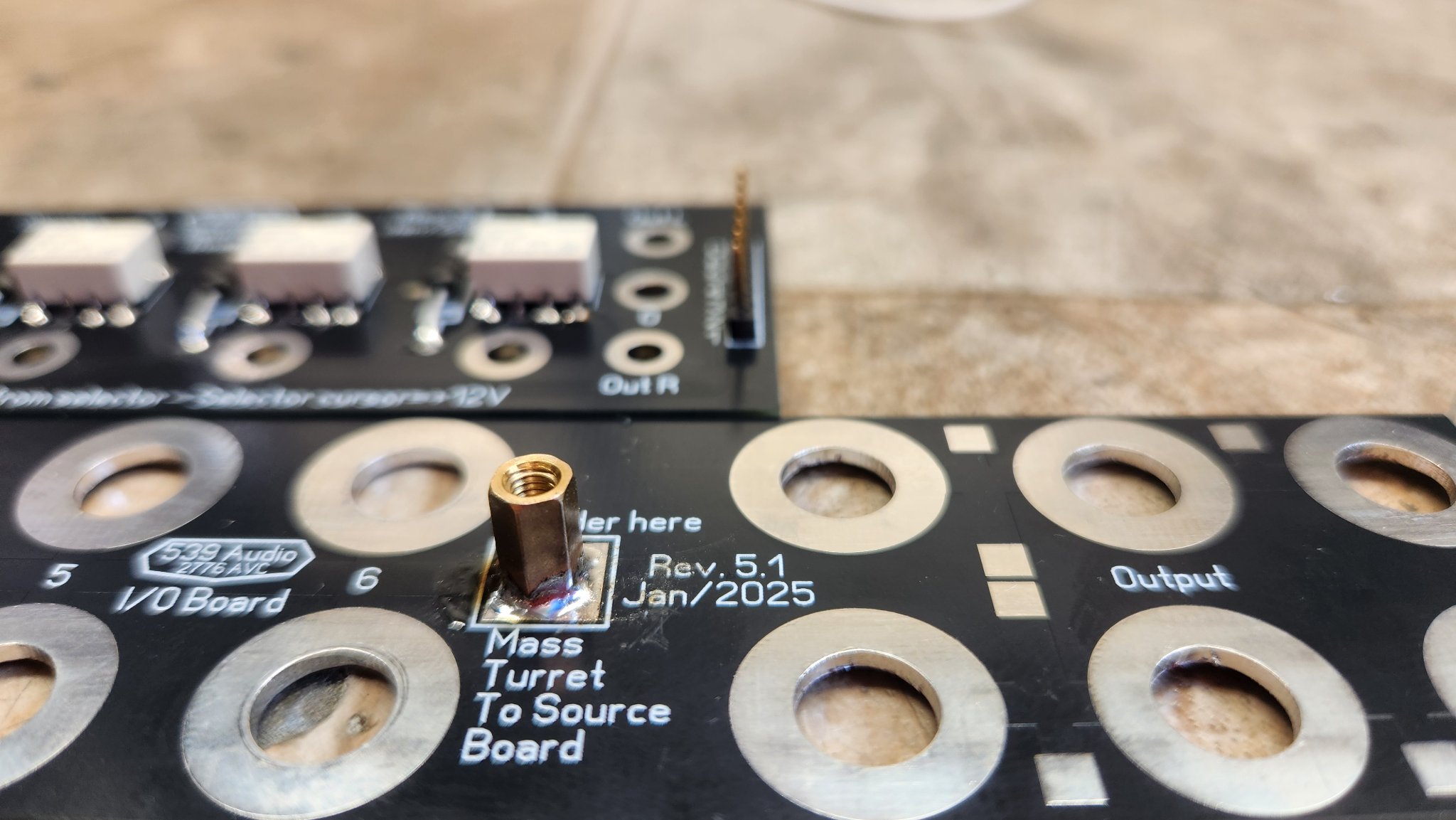

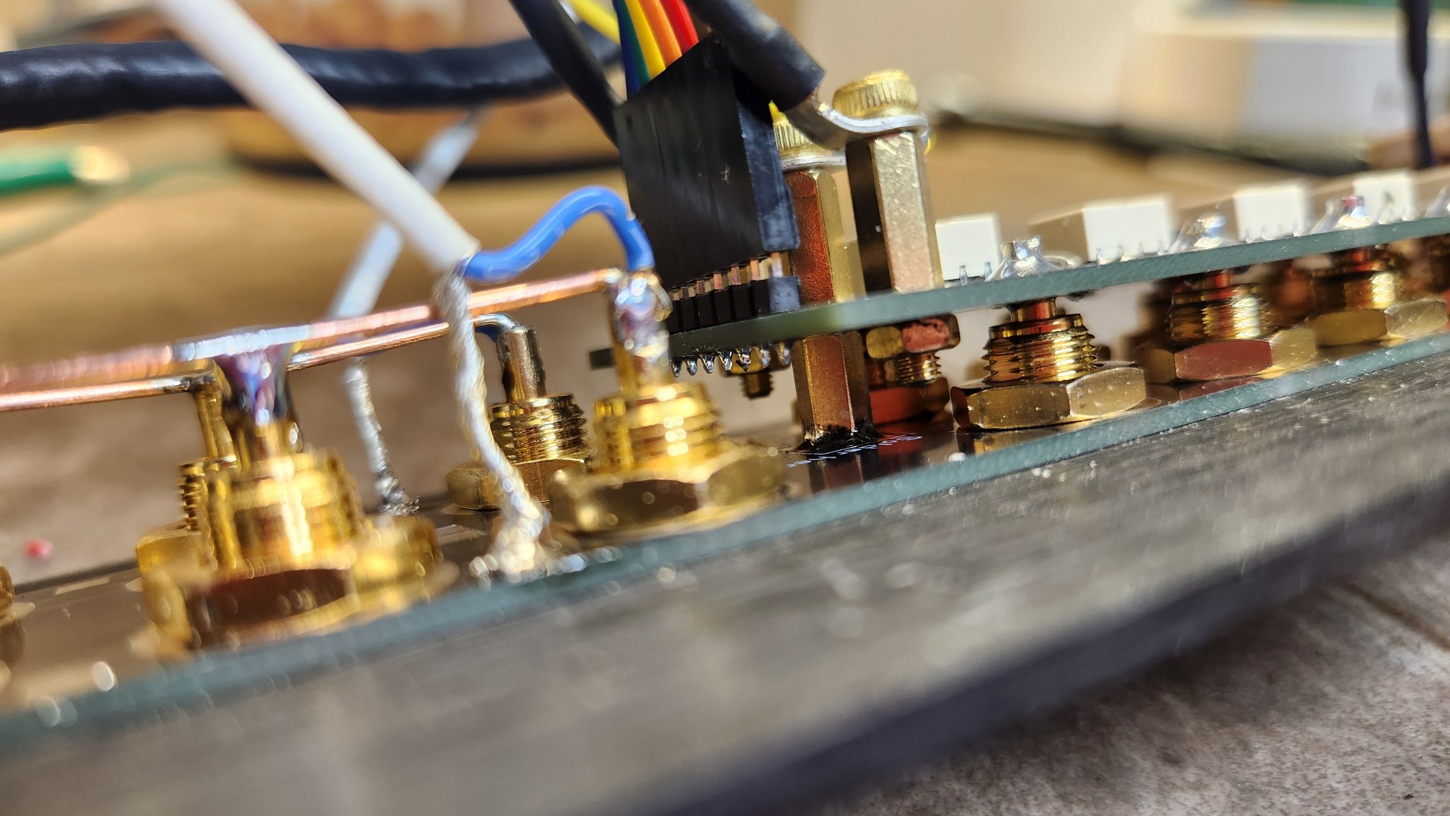

  • 17 – Detail of the RCA pin mounting PCB, showing the brass turret soldered to the PCB, which, in addition to providing mechanical support to the relay PCB, carries the ground.
  • 18 – Shows the installation of the two “RCA pin” and “relay” PCBs. Since my Talia uses the wired selector, I included the photo of another hybrid preamp, which is why you can see a fan. The selector in the photo is of excellent quality, wasted in this case.
  • 19 – I tried to highlight the turret that mechanically and electrically connects the two PCBs.

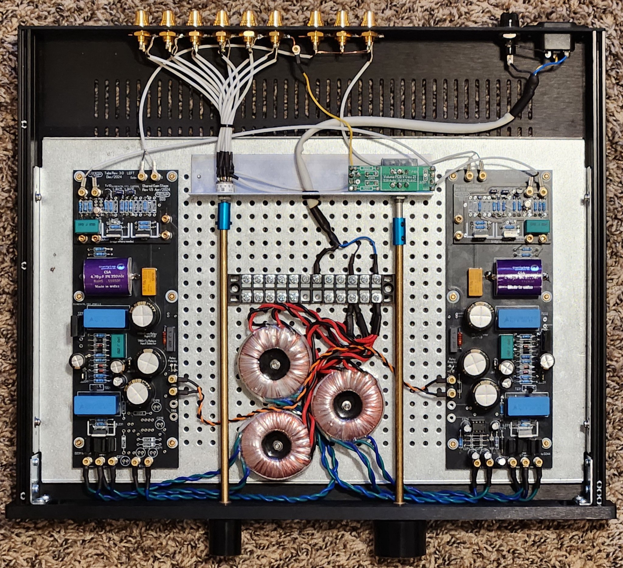

  • 20 – Top view of the inside of the preamplifier. 2 of the 3 10VA transformers have two 30Vac secondaries connected in series, and serve the main power supply; the third transformer has two 6Vac secondaries, which power the services. This is not a mandatory solution, it is simply what I found available.

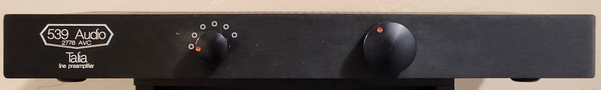

  • 21 – Front view. Notice the extreme essentiality of the front panel that does not attack the eye with lights and a high density of elements. The writings are engraved.

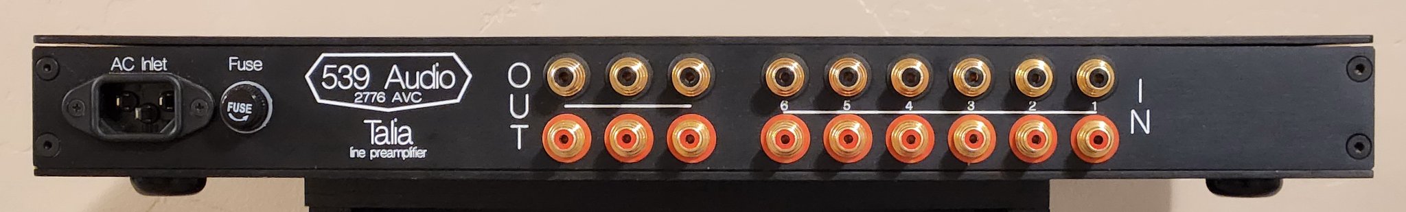

  • 22 – Rear view. The writings are printed.

The effort to be put into the mechanics of this project is not particularly burdensome, but it is still not negligible. You need to have a pillar drill and excellent quality bits. Or entrust the drilling to a service (I use HiFi2000), if you also want the engravings and printings.
The layout inside the cabinet reflects the setting I gave to all my pre-line amplifiers, to keep the wiring as short as possible. This forces the positioning of the potentiometer and the selector in the rear part of the cabinet. This implies the need to extend the potentiometer and selector stems with two pieces of rod (eBay), until they protrude from the front panel and then end them with a pair of knobs. Then comes into play a 1.25” x 1.25” x 1/16” (thickness) aluminum angle (eBay) on which the potentiometer and selector are fixed. I will not go further in the description of the mechanics, the photos give a better idea than many words.
