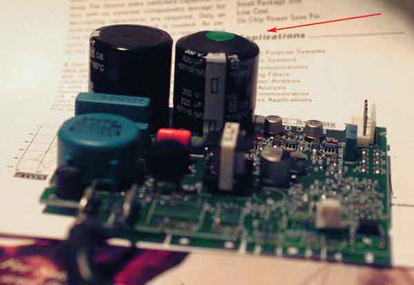

The two obviously vented caps on my MSI motherboard measure about a fourth of their rated capacitance and an ESR in the ~1 ohm range--obviously defective. A third cap removed for control testing seems perfectly normal with an ESR in the low milliohm range. Since these parts were a pain to remove (I still can't get the solder out of the positive lead holes), I'm going to avoid removing any more. My kingdom for a robust desoldering station! I think they're United Chemicon KZG parts.
I doubt my MB's caps are part of the 'plague', but rather the expected fallout of parts that are worked hot and hard, and possibly a bit underspecified for the duty. This application well outside what I'm used to considering for audio electronics; I hardly ever look at the ripple current ratings.

Replaced the bad caps on my MSI K7N2-Delta 2 motherboard with Rubycon MBZ parts, and it's once again alive. Even overclocks a bit, which it wouldn't do before. Bonus! There were places for four caps but only three were populated; I added a fourth in sockets which I'll pull once in a while to attempt to observe any change in ESR. My Dick Smith ESR meter only reads to .01 ohms, which is what the new caps measure so it may take some considerable time before any degradation becomes measurable.
The two obviously bad caps were mounted directly alongside the CPU heatsink, so it's likely that heat was the villain rather than poor quality construction.
