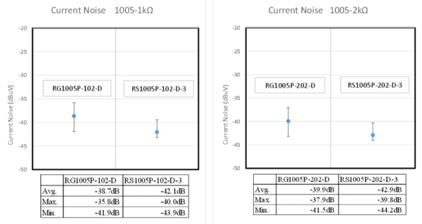

Yes I know, the "datasheet" is rather light on actual data.
They should show at least show some graphs like the new Susumu RS.
That Susumu RS has low noise comparable to the tx2575.
Another comparison of thin film <> thick film
