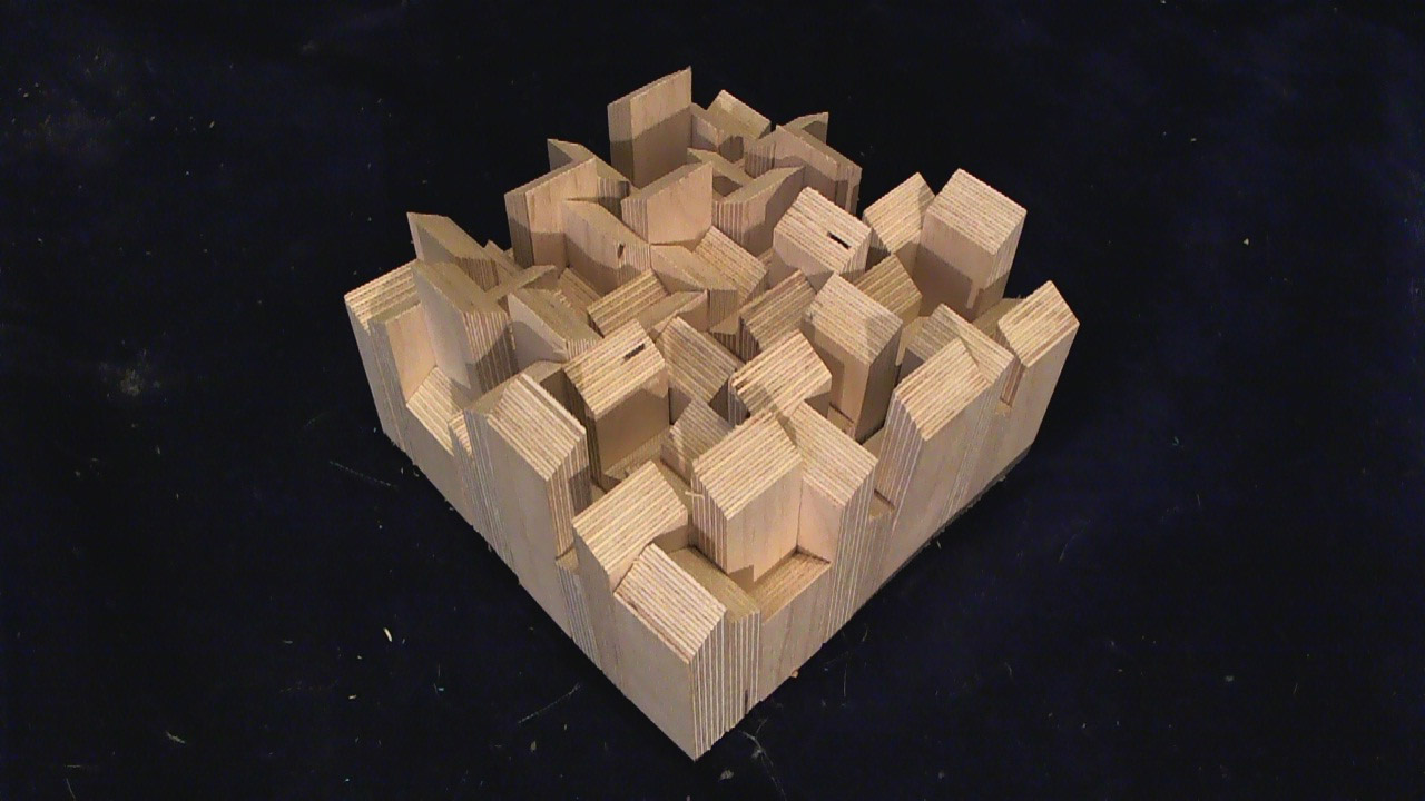

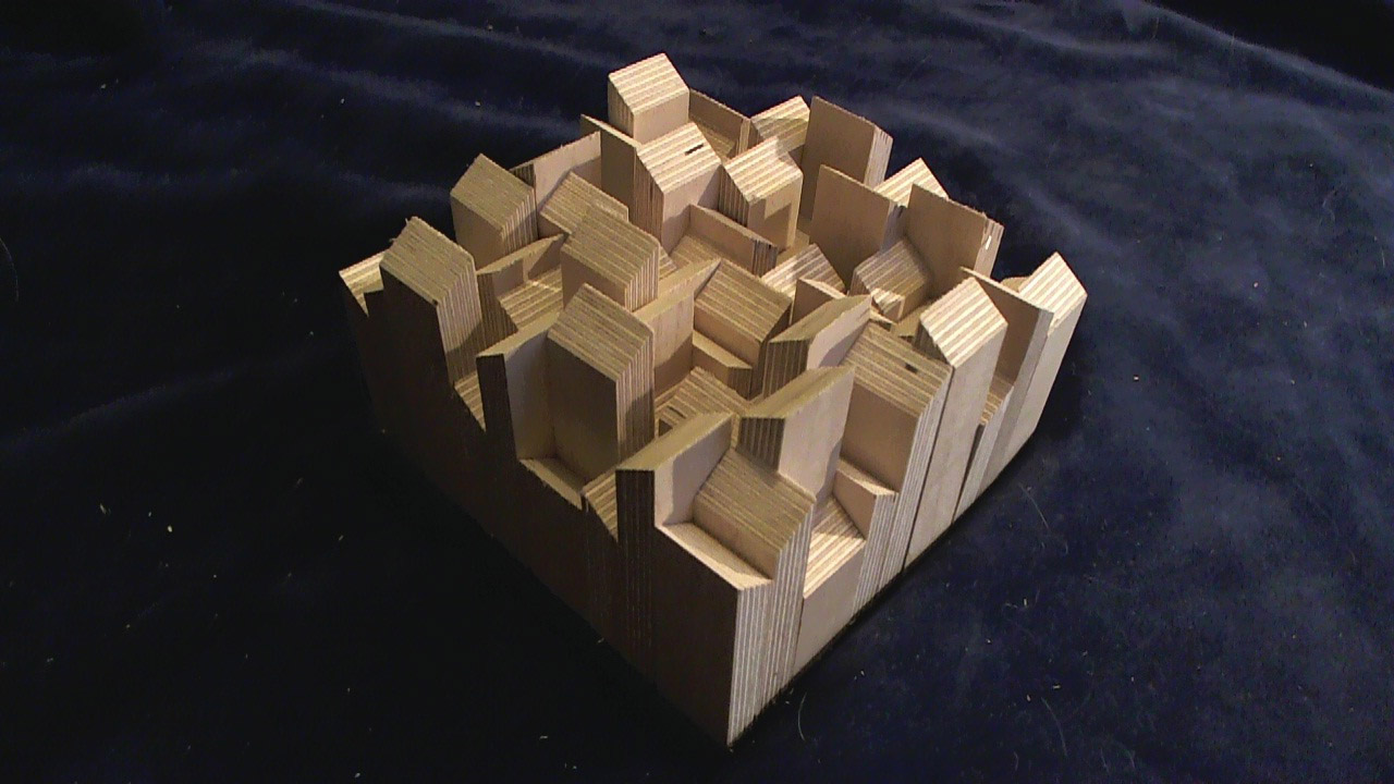

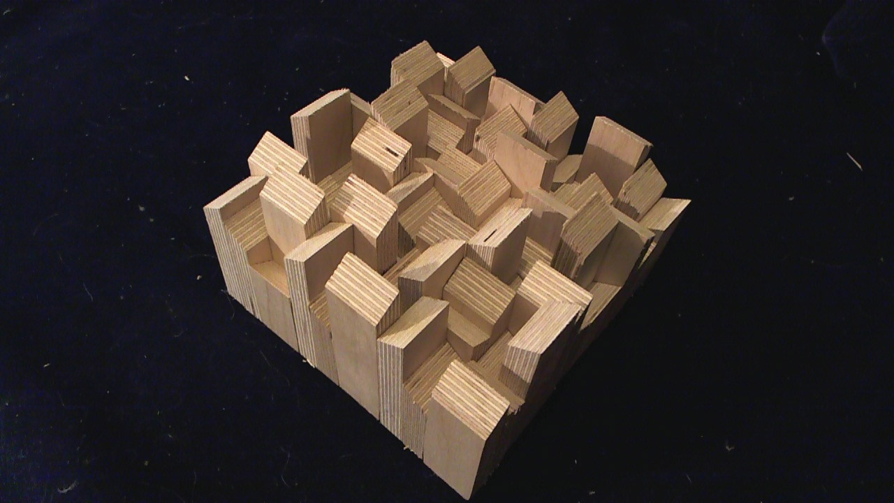

Is Olique the same as Isometric
Allen,
Is it possible to get a couple olique photos?
dave
Are these "olique" photos? I remember Isometric from drafting class in school a while back... ... is that the same as olique? This difuser is hard to get the light right. Here are three diferent lighting arrangements of this difuser in an Isometric composition. Let me know if you prefer a diferent composition .
