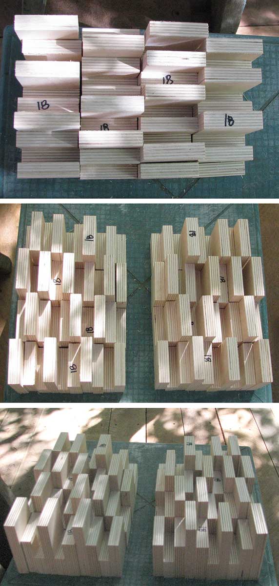

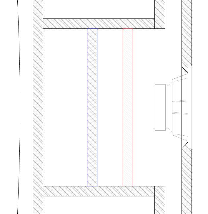

When Chris & i built (chris did the actual building) the 1st test set of Woden Maeshowe the Air Cavity behind the driver was purposely enlarged so that we could play with it. Sucess with the FE126 lead to Valiant, an adaption for FE126En.
All along we knew we'd have to fill it up/reduce its volume back to spec. I had the idea of using the "blocks" i often mention.
This is meant as an illustration of what i mean by that. I will note here that what follows was/is very successful.
Blue is approximately where we put the divider, red is where it should have been.

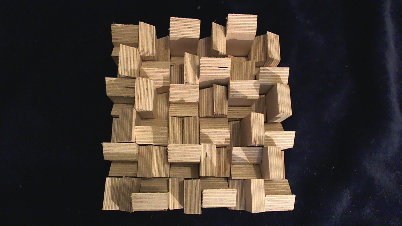

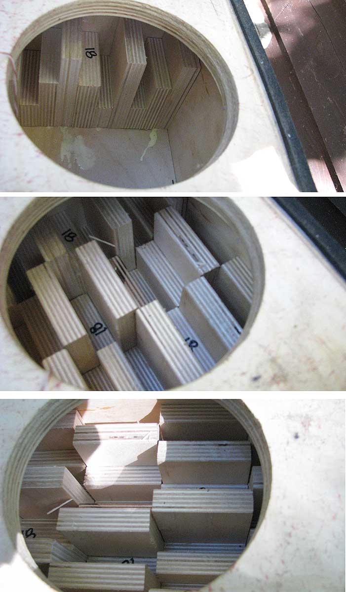

1st i figured out how deep a block i would need to fill to the depth of the specified rear dividing panel (distance from blue ro red). I took this depth and multiplied & divided by the golden ratio.
I had to install thru the driver cutout so i figured a grid of blocks 4 high by 10 wide (9 blocks 15mm wide + 1 18mm). Chris made up a 1/3 each of the 15mm blocks in short, medium and long. The 18mm blocks were all made medium. Installed this gives a net air cavity volume as specified.
I arranged the blocks so that each row had the same number of s/m/l and then arranged them so that no 2 blocks with the same height were adjacent. (and mirror image for each speaker). Then using a dab of glue i installed into the cavity to create a "bumpy" rear wall. A layer of 1/2" cotton felt was placed over the top and the driver installed.
EL70eN was installed and the "issue" we were having that we were using as a benchmark had dissapeared. The new Alpair 7.3 was installed (sans extra magnet as that was quicker than cutting a hole in the damping to accomodate it) and worked superbly.
One can take this further by making a more complex grid of blocks. For instance, more of them, more lengths, cutting the outside end at an angle, using pyramids instead of rectangular prisms.

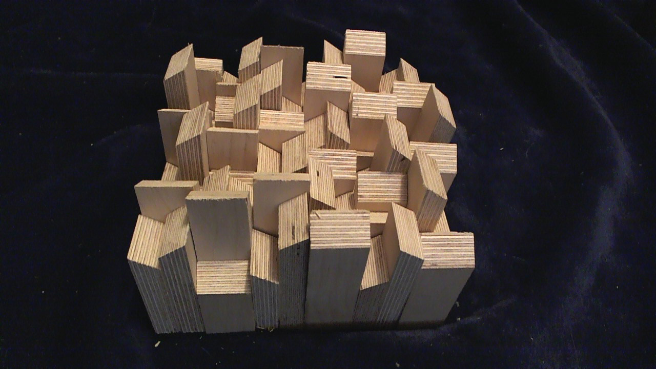

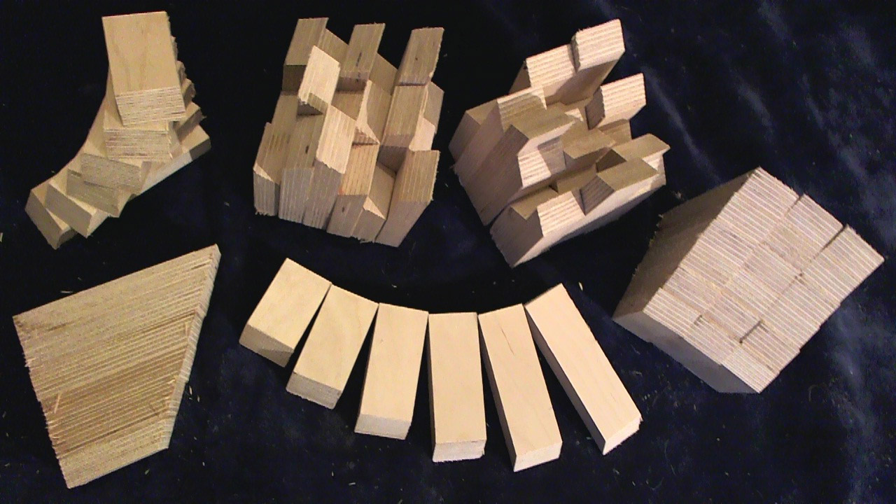

Sorry to interupt, but I figured I would show you what the imformation on this thread has inspired me to do for my Avebury project:
It was hard to use only prime numbers as I did not have a lot of depth to work with. And the golden ratio was done by Dave, so I went with sloped surfaces on my blocks. That way every distance is covered with-in the range of my slopes when put in continuous order from smallest to biggest. (picture 1) One group of smallest to biggest has six peices.
Next I figured the layout of the grouping of peices by attemping to make the distance from the top to the bottom of adjoining pieces as differnet as possible, creating different "cavities". One grouping has a redundency, but they slope in opposite directions creating a different "cavity". All the "pairs" have similiar patterns, but they are diferent by how they adjoin. (picture 2)

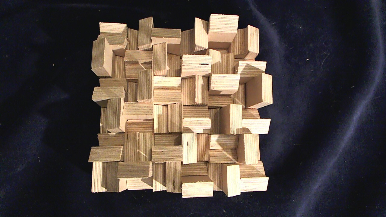

Now the fun part. I created four squares, each consisting of 3 groupings. I followed the same sequencing on creating these squares, but it is amazeing how different they turned out. I then put the squares together by rotating the adjacent square 90 degrees. (picture 3) I want a "sysmetrical" diffusion to keep the driver loading the horns equally. This may not de necessary.
Have I lost ya yet?
Bear with me, I am almost done! I just hope this helps someone!

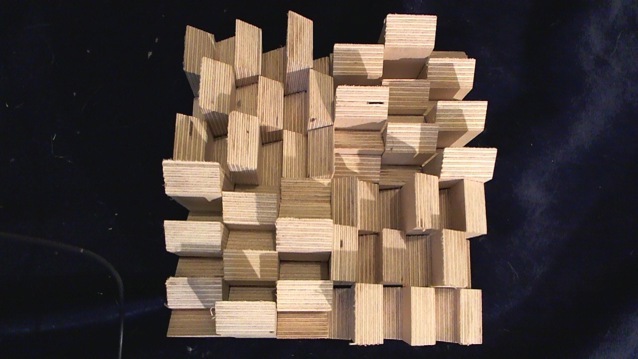

...So, after I got the squares together to form the whole diffusion panel, I rotated every other pair of peices. (picture 4)

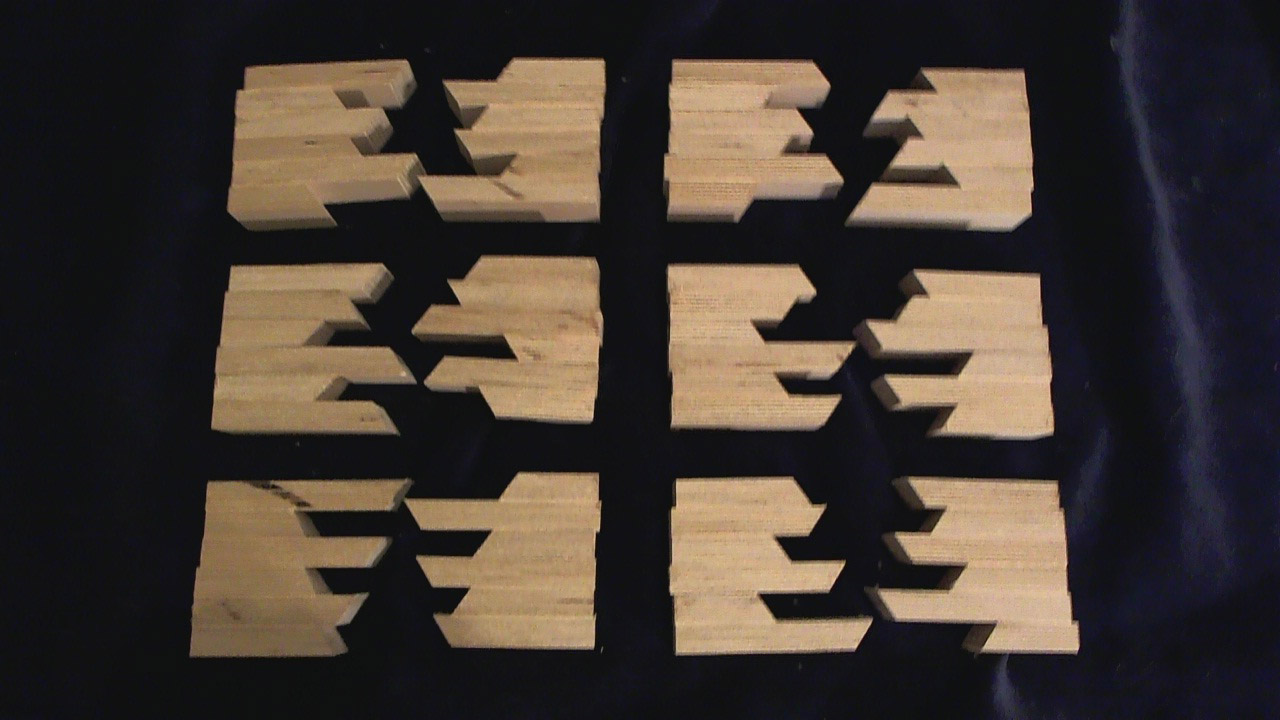

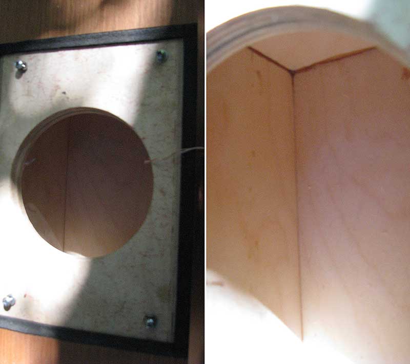

...After some looking, I decided to rearrange the four squares to scatter the sound around more "balanced" Is that an oxymoron for a diffusion panel? (picture 5+6) This is the one I like best.
