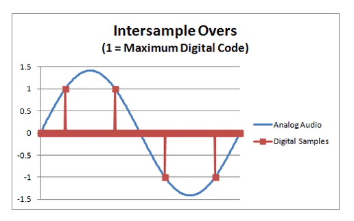

There is always some distortion no matter what. Same for noise. Anyway, are you referring to intersample overs in regard to reproduction of 0dBFS? The distortion that is worst at a sample rate of 44.1kHz, and at the particular audio frequency of 11.25kHz?
Intersample overs do not happen with sinewave.

What about this:Intersample overs do not happen with sinewave.
https://benchmarkmedia.com/blogs/application_notes/intersample-overs-in-cd-recordings
