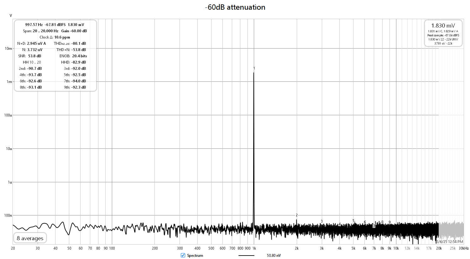

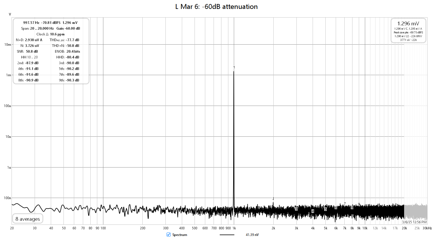

attenuate the signal -60.0 dB before 'recording' or passing it through your Signal Chain
OK, I did, by a precise stepped attenuator. Would you tell me if it is "good enough" to prepare a test with vinyl?
I would really like to know what is your goal, or better please show me YOUR examples.
And I do not understand why to work with such attenuation. We are about to check OUTPUT of the phono preamp, thus not signals in mV.
PMA, as I said earlier, i was just commenting on item 4 in EdGr's test which involved signals near or below the noise. I was explaining how I did this repeatably in Jurassic times to determine good and bad Digital Signal chains.
So no. it has little to do with phono preamps ... but perhaps some relevance when people claim to hear such stuff in a none DBLT.

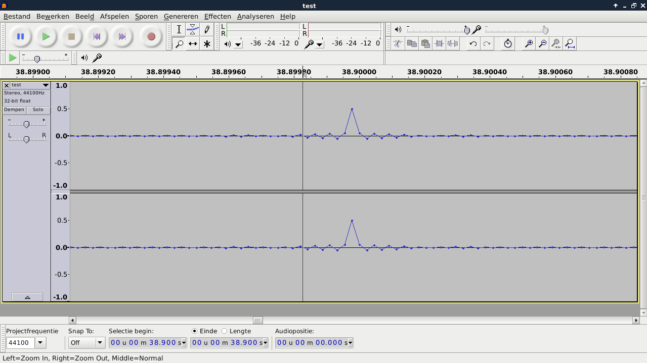

Your click waveform looks like a sinc:
To get such a waveform out of an ideal RIAA preamplifier, you would have to take a series of Dirac impulses, pass them through an ideal 20 kHz low-pass filter and through an inverse RIAA network. The ideal 20 kHz low-pass could be a very rough model for a cartridge, but how the clicks are supposed to get inversely RIAA corrected is unclear to me.
All in all, I don't think you can conclude anything at all. The test is sighted, also known as unreliable, and the waveforms are unrealistic.

As far as I can tell, it only shows that some people think they hear the + 1 error in your click signal. Maybe they might also have misunderstood the test and compared part 2 to part 1 instead of part 2 to part 2.
The peak value of the click does get higher, but only by about 0.015 dB, and the peak shifts somewhat to the left, see the attachment. I've calculated a sinc waveform and what you get when you pass it through a filter with transfer 1 + z, that is, the sinc waveform plus τz times its derivative to time, where τz = 1/(2π · 200 kHz).
The impulse is a reasonable approximation to a click because the phono cartridge responds to velocity, and the RIAA network is mostly an integrator.
Ed
Fair enough, if the original mechanical click looks like the impulse response of a low-pass filter with a bandwidth of 20 kHz or more.
