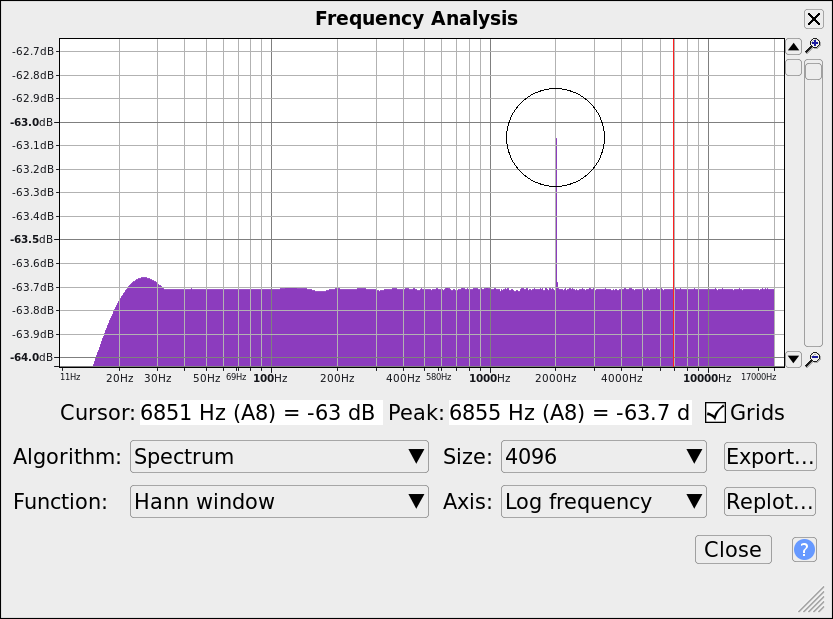

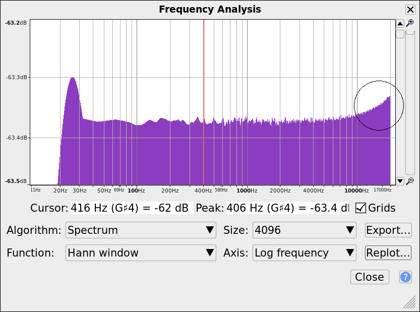

@kgrlee - Yes, I am adding a 2KHz sine at -40dB in (3), and at -80dB in (4). I picked the 2KHz sine because it is easy to hear (at 1%). It acts as a placeholder for distortion.
Here are FFTs of (2) and (4). The bandwidth-limited impulse contributes -63dB at all frequencies.
Ed

That 2/6 people could hear the "+1 error" is more than I expected. This error is only +0.04dB and -6 degrees at 20KHz. The results support the belief that phono pre-amps that do not have the +1 error seem quieter.
That no-one (so far) could hear the 2KHz sine at 0.01% is showing that the impulse masks low-level signals due to its broad spectrum. In my previous "THD challenge", one-quarter of people could hear a seventh harmonic at 0.01%, but in the presence of an impulse, distortion needs to higher to be audible.
