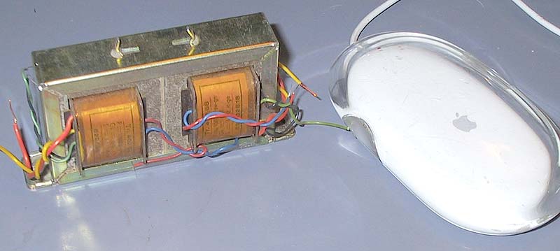

Can I build this amp straight from your schematic? How forgiving are tube circuits? Do I need that isolation transformer or can I just use a fuse?
How about tube rectification, will it make a huge difference in this design? I have some really huge electrolytic power supply caps. Can I use them, or should I stick to the values that you have used? I want to run 24 ohm speakers instead of eight ohm. Will I have to make any design changes? The compression drivers I will use are rated at 115bd/watt. Should this amp be Ok for them for above 500hz?
I am thinking about making this amp out of copper sheet soldered together. Then maybe heartwood side panels! I will also use pop cans to disguise the crappy old looking OPTs! When I get back to school with a soldering iron I may be able to whip something up.

tade said:Can I build this amp straight from your schematic? How forgiving are tube circuits? Do I need that isolation transformer or can I just use a fuse?
You need to have a transformer. It is unsafe to o otherwise.

I am looking at your schematic:
http://homepage.mac.com/tlinespeakers/TLS/tubes/images/SE_50EH5_map.gif
And I am going to build straight off of this. Have you made any changes to it during your tweaking phase or may I build straight from it?

tade said:Have you made any changes to it during your tweaking phase or may I build straight from it?
As noted in the article i moved the filaments to before the trafo (a bigger trafo or use 2 would be better) and when i do it again, i'll make the 1st cap after the rectifier small and move the big one to after the R.

The transformer functions as a current limiter?
so lets say i build this thing. Then it is a matter of listening and testing voltages? And If a voltage is wrong I try different resistor values?
tade said:why doesnt my incandescent lamp have an isolation transformer?
it doesn't have a ground (connected to the chassis). That is how i wired the heaters -- like an incandescent lamp.
