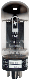

> hmm there made in germany.
I'm sure that TAD shops the whole world and selects the best tubes from all suppliers to sell under the TAD brand. Same as Groove Tubes and several other trusted-brand marketers. Same as Realistic in the 1980s. Same as most "RCA" tubes in the 1960s-70s: RCA listed every tube type but only made about half in-house, contracting-out the rest. Today there are only a handful of tube factories, so you can guess where they come from. If TAD sells a lot of tubes, they can contract for a better (or cheaper) grade of tube than that factory makes for other distributors.
TAD tests, sorts and rebrands Chinese tubes (from the Shuguang factory, IIRC). The do a good job of it, too. I haven't heard of any quality issues with the tubes they sell.

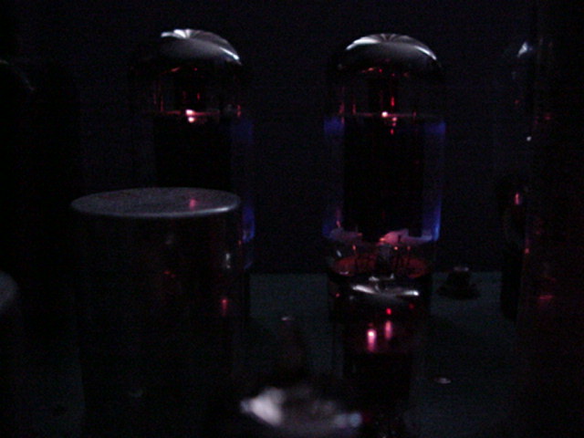

well i finally picked up 2 sets for my old bogen amps. some things
i noticed was the quality is as good as the original 6l6gb or better.
the tube filament wires are a thinner wire than the 6l6gb so startup time is way faster and the amps do run a little cooler than before. with the old 6l6gb tubes there was alot of loose base.
this tube has real Tight base lots more detail in the music.
all in all mholz was right in saying there good for guitar amps.
and there still good for the vintage amps to😀
