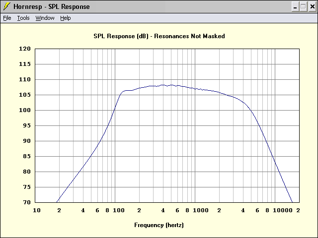

I am thinking of horn loading my set of TAD TM-1201s in a front horn. Probably in a 150 Hz horn and then cross at about 250-300Hz.
Has anyone tried this or would it be better just to use it as a direct radiator?
Are there any commercial horns in that size that suits the TM-1201?

If you want a speech range horn, to match the TD-1201 you will have to design it yourself.
This would be a non-trivial, although a possible exercise. I have already given you guidelines for doing that.

Run some simulations using Horn-Response to see where it takes you.
Horn throat Sd/2, length > c/(4*Fc), Mouth perimeter, = approx. c/Fc
Otherwise a simple sealed enclosure, with low-end equalization will do, unless your listening space is huge. Sensitivity of this driver is high.
As this is a low-Q driver, with limited xmax, c/o at >200 Hz.
WHG
P.S.
Here's the SPL plot from Horn-Response (McBean) with the TAD TM-1201 on a cosh horn.

You will find opinions here based on horn resp sims ,that TM 1201 is not really suitable for horn loading. Do a search on forums
Limono, you are so right. It wasn´t so long ago we discussed the subject here. This driver is not suited for horn use.
And that's a big beautiful failure. The biggest and most beautiful I have had.

I would suggest that the horn for the TAD driver was not correct in some way. Going from conical to exponential may not be the best way to use this driver. I'm guessing that a normal tractrix would be better.
Hi pos,
It's a shame that gorgeous looking mid horn is not a proper horn I'd say, as dirkwright has mentioned above. Rather, it's more like a wave guide shape of OB 😱 That project was finished in a tight schedule, not enough time for trial and error, sigh... But what is done is done, I still have to admit that's my desgin, my failure.
Eventually it was made like that, oh well. The short length and rapid flare don't provide optimum load and the big throat gives problem to the higher end. So the result is narrow usable range with little acoustic gain.
The whole system is supported by the HF and LF horns, with the mid filling the 200-800Hz or so (and some help from higher gain of the driving amp). I forget the exact numbers of xover setting, anyway the mid covers only 2 octaves, or slightly more. I think it's not a good configuration for a 3-way.
Maybe the only good thing is, maybe, again, maybe it provides some wave guide function, so the directivity from high to low of the whole system could be maintained or at least a smoother transition in the critical zone. I'm not sure...
Faulty as it is, the whole system is still very listenable, enjoyable, or even shockingly good in some materials. What a team work in covering the weak point!
