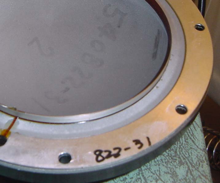

they are too fragile. The surround and dome are all one piece of beryllium so if you over power them or hit them with a little DC, pop, they're gone.
for the overload: what watts are necessary to do so? does this happen when using real big amplifiers, or also with 10 Watt amps and slightly clipping ?
for the DC: a series cap should prevend, but what would be the largest value for series cap here without danger for the diaphragm?
This pop, its gone, is it dead, silent, or does THD increase? i imagine if one plays a diaphram with small cracks and does not recognize some time, small berillium dust will come out of the horn and kill you.
till said:This pop, its gone, is it dead, silent, or does THD increase? i imagine if one plays a diaphram with small cracks and does not recognize some time, small berillium dust will come out of the horn and kill you.
I don't think that will happen, Till. The diaphragm wont vaporize into dust even though it breaks.. It's a metal.. it will come off in pieces, due to the floating electron structure of metals.. If this was a possible scenario I would expect these drivers to come with a small warning sticker..
In case they would be made by a european company .... they would not have beryllium diaphragms. As far as i know the material is forbidden for any products (except for military use) in EU countries. If pioneer would declare there is berillium in the driver, they would not be able to import them from japan to europe. In germany i was told they do not import, it took me more than 9 month to get TD2001 here. I found a MAK value for Be, 2ug / m^3 - that is not really much...
I hope it never will happen. As i plan to active crossover in a lower order some day i ask for safe series cap value.
Still, Beryllium will not vaporize. But I can clearly understand your concern protecting the fragile phragms from an economic point of view 😉
I made a couple of mistakes with these drivers. First I did not put a series cap on them and second I unknowingly used my DVD as a transport for my CD's. In the second case, when I put in a DVD without switching the pre off the DAC I would get the decoded DVD output at the speakers, which I assume is a series of high level square waves of various periods. The combination of the two mistakes was all it took.till said:
The failure mode was for the surround to separate from the dome right at the voice coil attachment point (look very closely at the photo below). The sound was to become increasingly distorted and compressed over a period of a couple days until one stopped working altogether.
