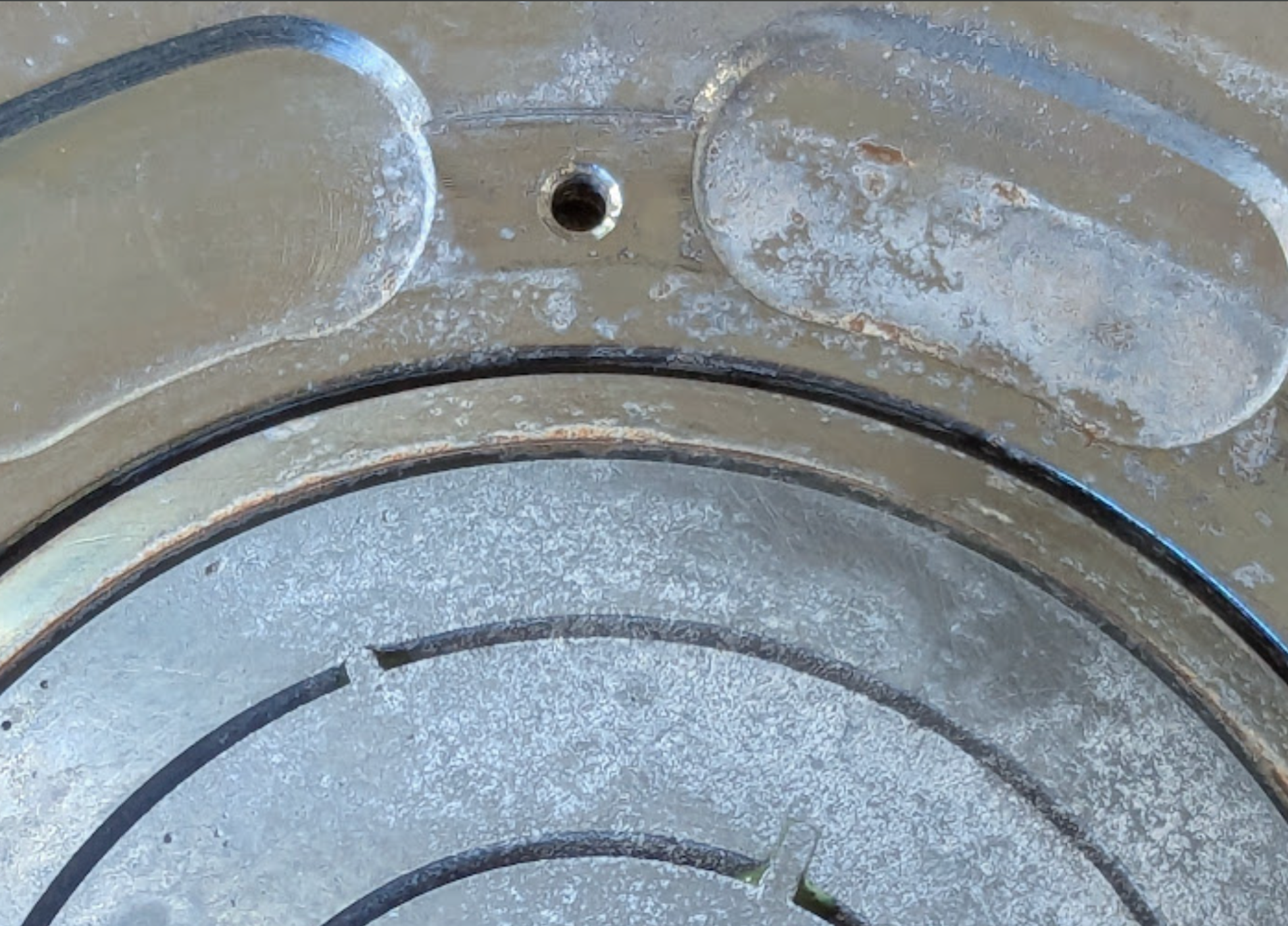

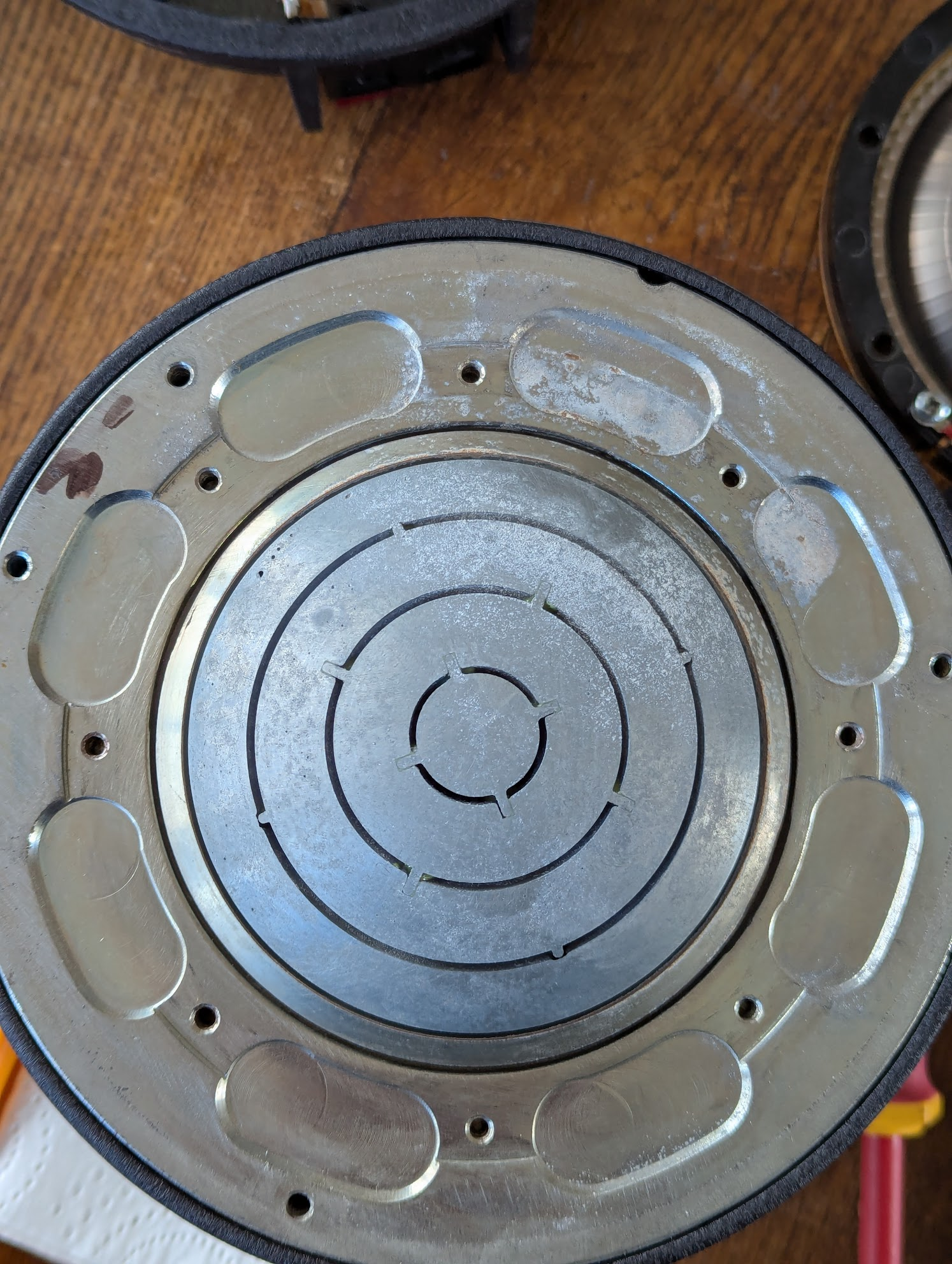

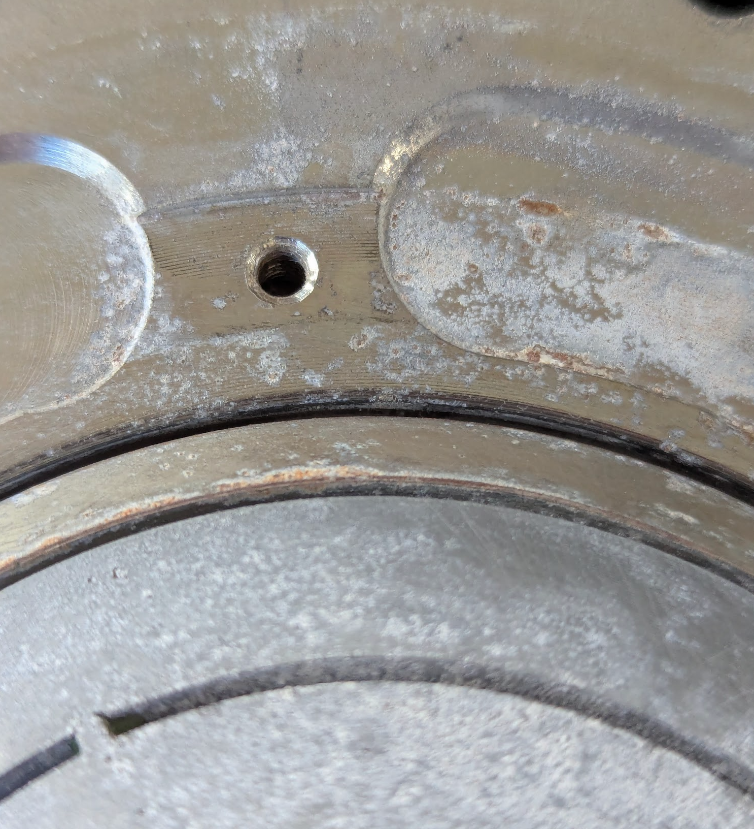

A few more photos of the corrosion/residue on the JBL 2450H's.
I was wondering if anyone had any tips for cleaning, particularly the parts that creep into the voice coil gap.
Is that best left alone - or is there a way to safely clean in there? Some seem to say don't put anything down except for the card and tape trick, while others seem happy to flush it out with some deoxidation spray / compressed air.
I don't see any noticeable pitting, it seems to just be a residue on the surface, so hopefully these can come good.

These are what I use to clean gaps that are fuzzy as you show.
These are very mildly abrasive, flexible and strong. I break them in on another surface and they will rub off the fuzz and not go through the zinc coating.
I am a nut with compression drivers and have made gage fixtures to measure the installed height of the phase plugs and coinciding depth of the diaphragms and built a plane wave tube for assembly validation.
I have measured improvement in frequency response smoothness when fuzzy gaps are cleaned flat and square and remeasured. A paper card may or may not get these truly clean.
Compressed air is also your friend. Keep taping and blowing them out until there is nothing at all coming out.
Barry.
