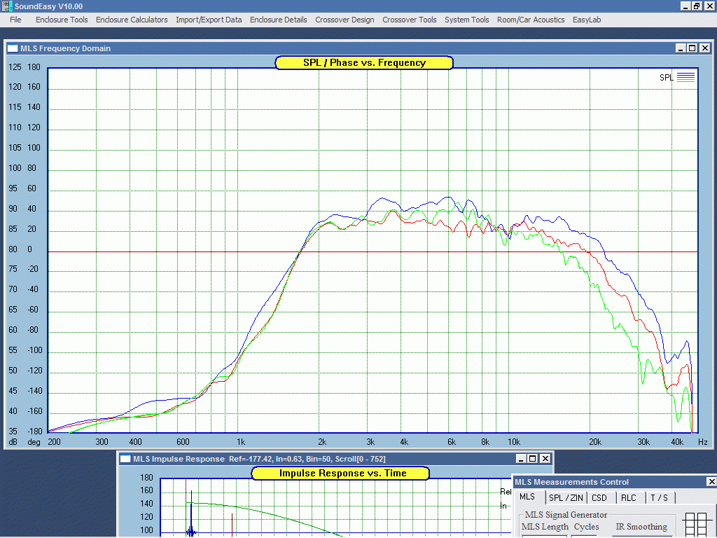

Sorry, I have not tried passive crossover with the ET-703. I did a measurement and it goes down to 4000Hz. TAD recommend a 2nd order filter and a cutoff frequency not lower as 5000 Hz.

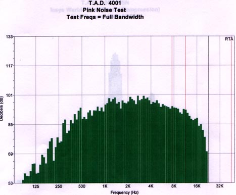

Here is the response graph of the TD-4001 and ET-703.
Perhaps these graphs might give an idea about integrating these two drivers.
Also, in the Exclusive 3401 speakers, the ET-703 is crossed at 7kHz.
