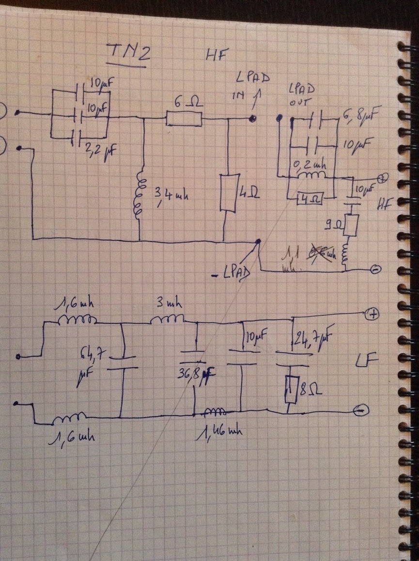

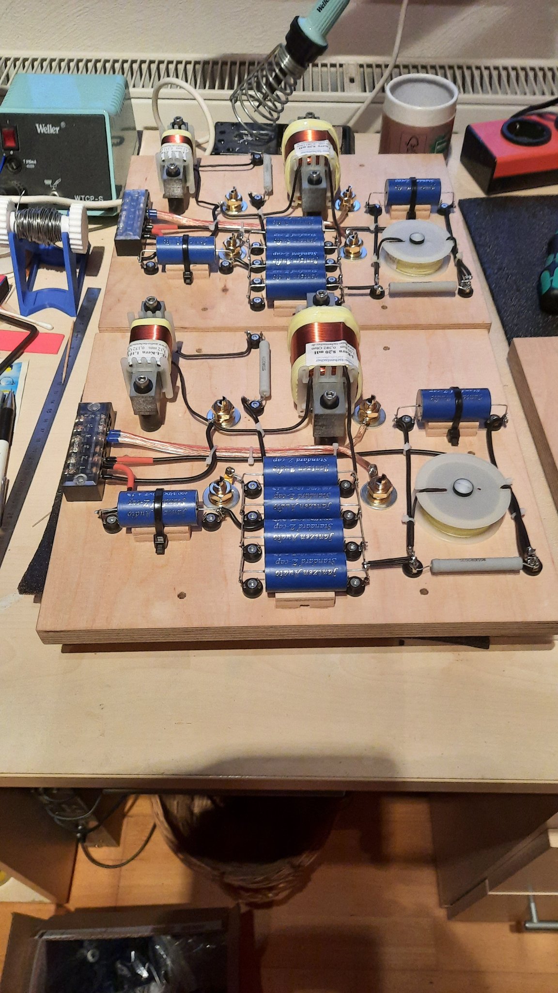

Thanks! The first version I made was point to point. but I ending up making more clones for friends, so I designed the pcb which is faster to assemble. For L3 I used 1.1mH
Does it have CD EQ circuit built in ?? Is it 8 Ohm woofer 16 OHm tweeter 660 Hz crossover network?
Thank you very much, I'll try 1.1mH.Thanks! The first version I made was point to point. but I ending up making more clones for friends, so I designed the pcb which is faster to assemble. For L3 I used 1.1mH
You're right, PCB is much better for mass production... But I only need two HF and two LF networks. However, if you had two more sets of boards, that might be a great thing! 😉😎😉
