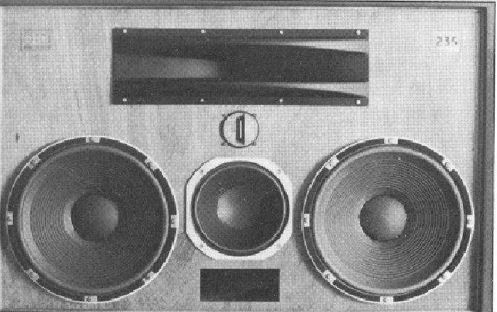

more random thoughts about the 2401
Ive found the 2401 and its variations somewhat enigmatic for some time. It has a long history that I think dates back to Westlake, although I'm not too sure about this.
I believe that George Augspurger (after his stint at JBL) and a few others had converged at Westlake for a few years and did a lot of work with this cabinet style. Like the picture I posted earlier I believe they are primarily intended for installation some what above ear level pointing down in a soffit that will extend the baffle.
The name of the other engineer who I think worked on this design escapes me at the moment.
I know Westlake is currently offering 3, 4, and 5 way cabinets of similar design.
In a thread about 6 months ago Jocko expressed some serious distaste for the horn loaded monitors favored by recording studios, I never asked him, but have been curious if this is the genre he was refereeing to.
If anyone can untangle my fractured understanding of the history of these apparently related designs, please jump in and set me straight.
-Dave
