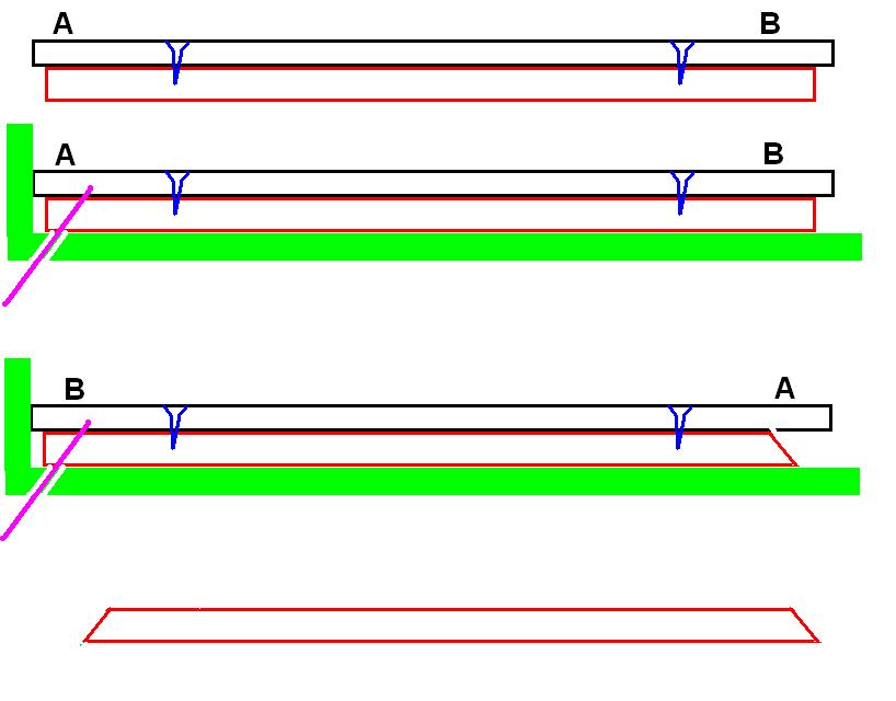

I wanted to upload 2 pictures that may help someone when cutting a 45 degree angle on boards. I use 45's when cutting plywood to hide the layers. When I first started I noticed it was really hard to get matching pieces.
This is due to two major problems. The first one is once you tilt the blade it is much harder to see where the cut is. The second problem is since most table saws only tilt one way, when you cut the other side of the board the angle will usually slide under the fence.

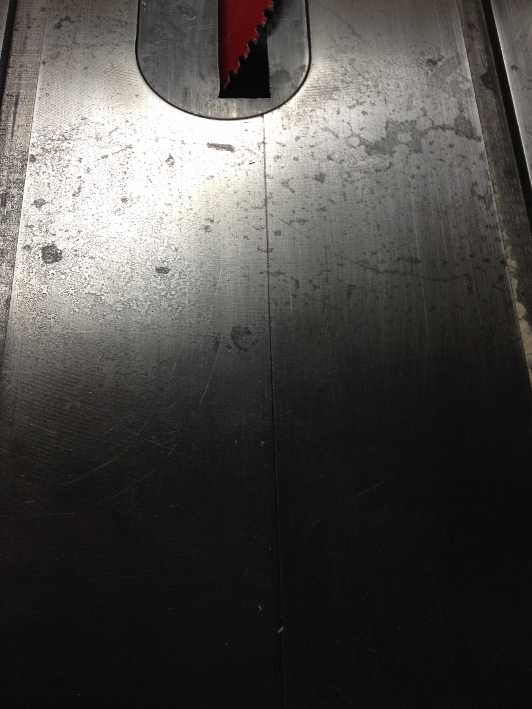

First I cut my wood square. Then I set my saw for a 45 degree cut. I use a square on the saw blade, do not let the square set on the teeth.
Then I run my test piece adjusting the wood till I cut the angle without making the wood smaller in dimension. Once I have achieved this (took me 3 tries) I turn the saw off (I unplug mine) put the 45 degree wood back in the saw and use a scribe to make a line on my table (can use a good ink pen).
After that you now have a line on your saw for 45 degree angle cuts.

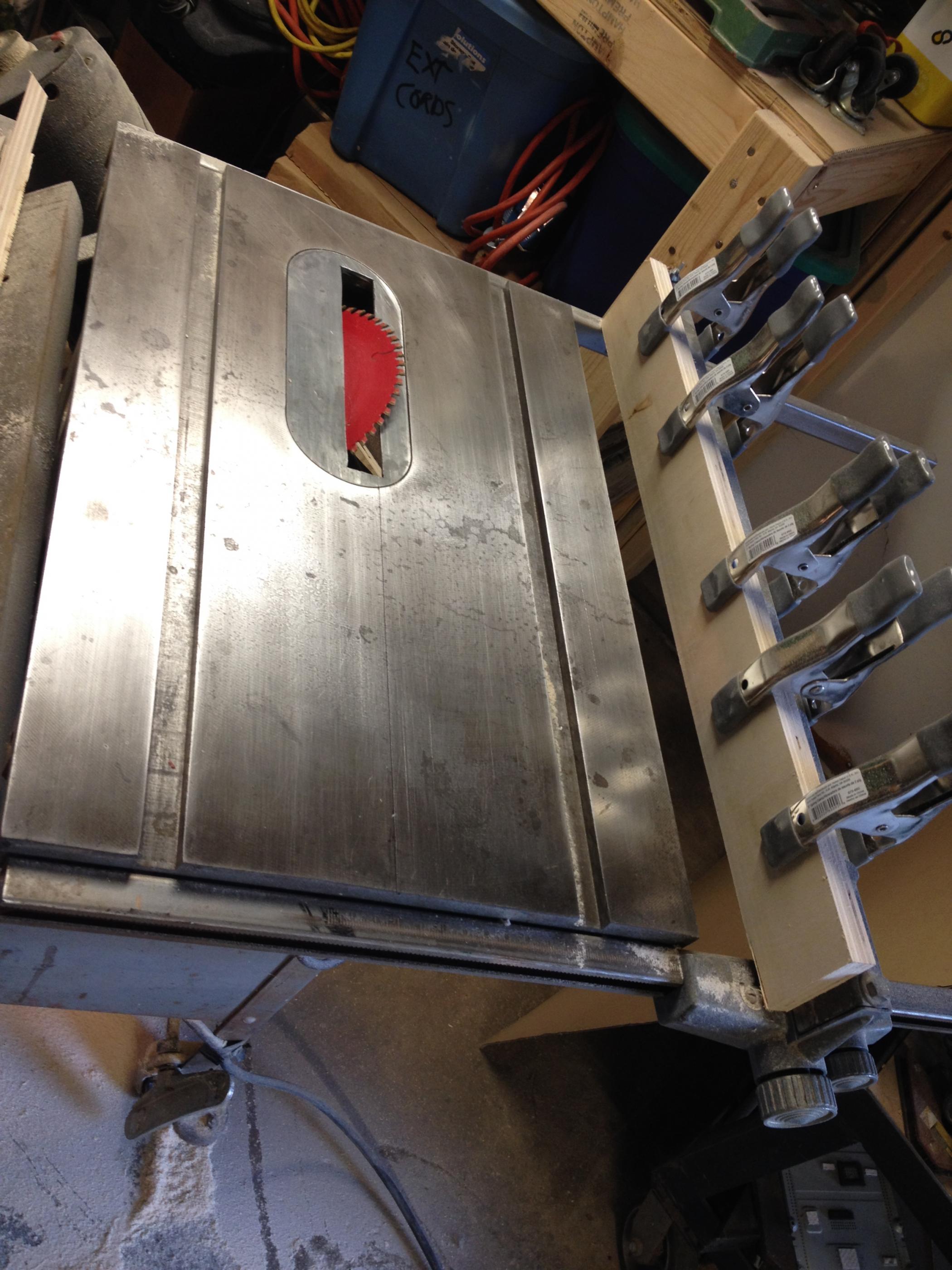

Then I use a piece of wood and 2" clamps to make sure the angle doesn't slide under the fence when cutting the other side.
Hope this helps someone.

I could do it that way Cal, matter of fact I never thought to try to put the fence on the other side lol
I prefer good side down, even with the thin kerf blade. I did have to notch the piece of wood at the adjustment end to make sure the thin angle would not slide under.
I guess my saw can't do what yours does, I have to have the good side up. Besides, you can always cut the bevel first and final dimension second. Yes the good side would have to be up, but that's how most of us do it, and it sure makes life easier. Having the fence on the left also means there is no problem if you have a little slip upward as you can simply recut it, unlike on the other side where you now have to cut another piece.

don't you find too much splintering of the face veneer when cutting bevels finish side down - particularly on any cross-grain cuts?
sometimes, it seems if I cut slower there is way less damage, big difference on the woods too. Harder the wood more splintering. A bigger table would help as most of my splintering happens in the last 2 inches when the wood starts to fall off the back. I've compensated by cutting the wood longer then trimming off an inch, those pieces become bracing along with the 45 scrap.
