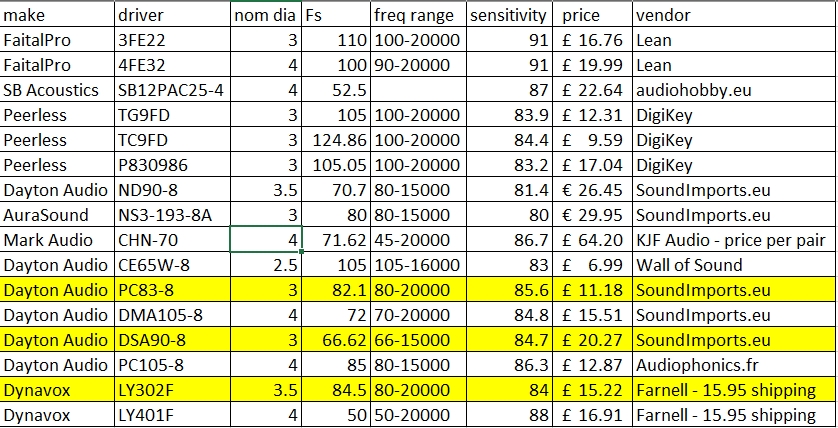

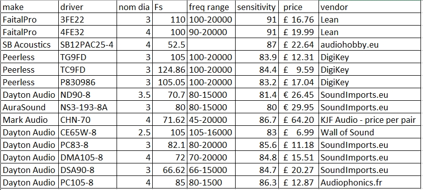

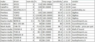

I am still interested to see if I can find a driver that might give me a bit more bass. I did a little comparison, attached, with some of the drivers that were suggested, and other ones I found. I am intrigued by the Dayton Audio PC83-8, seems to have pretty good low end response for a three inch. Would it give me audibly more bass?

Re-attached driver comparison with a couple more options added. The Dynavox 3in is interesting, but the PC83-8 is more available to me in the UK, and cheaper. What about the DSA90-8, it is spec'ed to only go to 15000, but checking on Online Tone Generator - Free, Simple and Easy to Use. I can barely hear 15000. Will it have significantly worse highs compared to a 3FE22?
Could the PC83-8 just drop in to my current box design, or would it need tweaking? Bjorn Johannesen simmed this box for me in the MJK worksheets, is there someone who can sim it for me? I will put it in Leonard Audio, but I was never happy how different LA was from the MJK sims, and I trust MJK more...
Try Dayton PS95-8 - I am pretty sure that’s a drop in replacement from cutout hole size. It’s a nice driver with great highs and more max. Looks great too.
OK, I'll get a pair and give them a try.

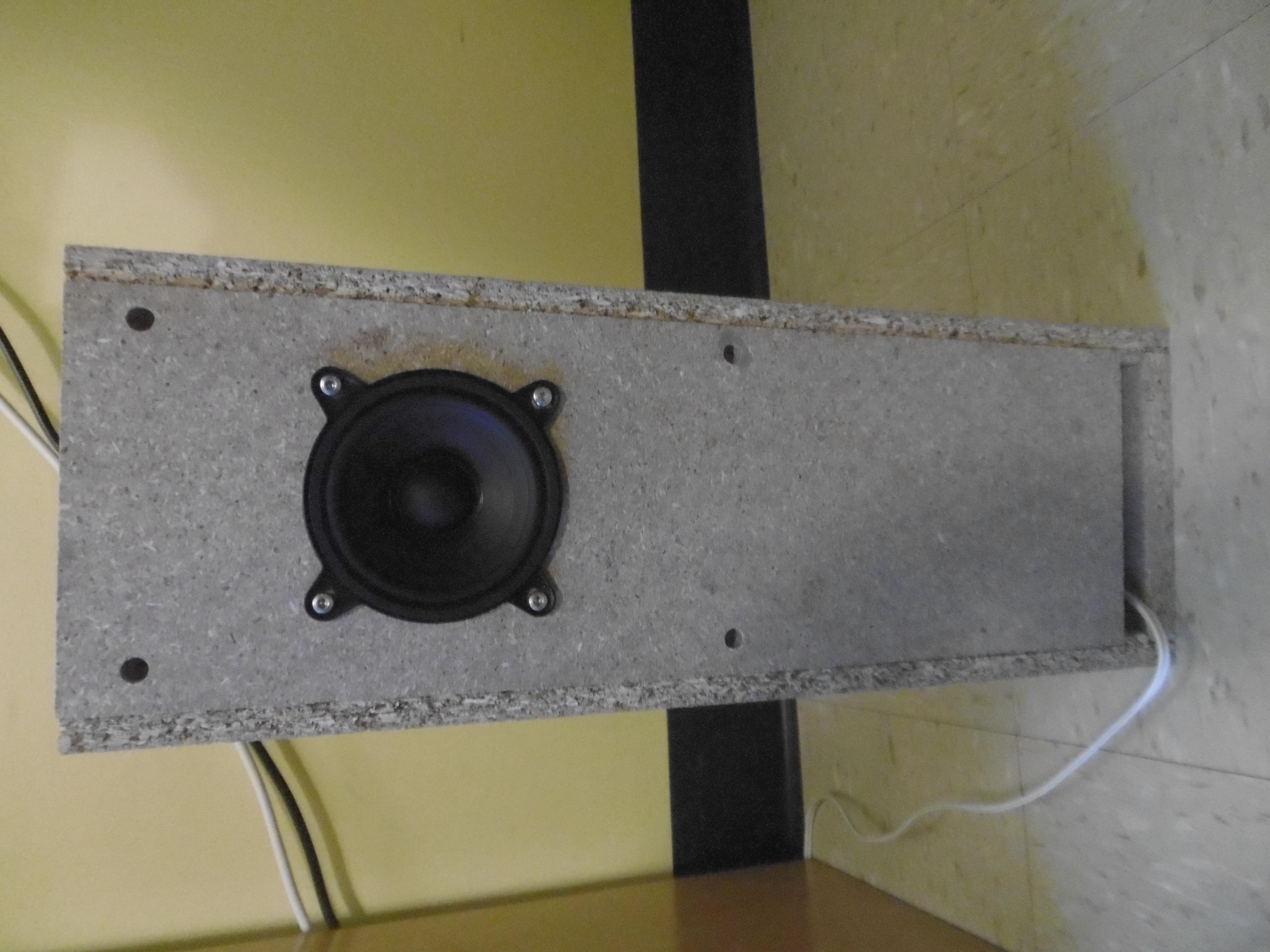

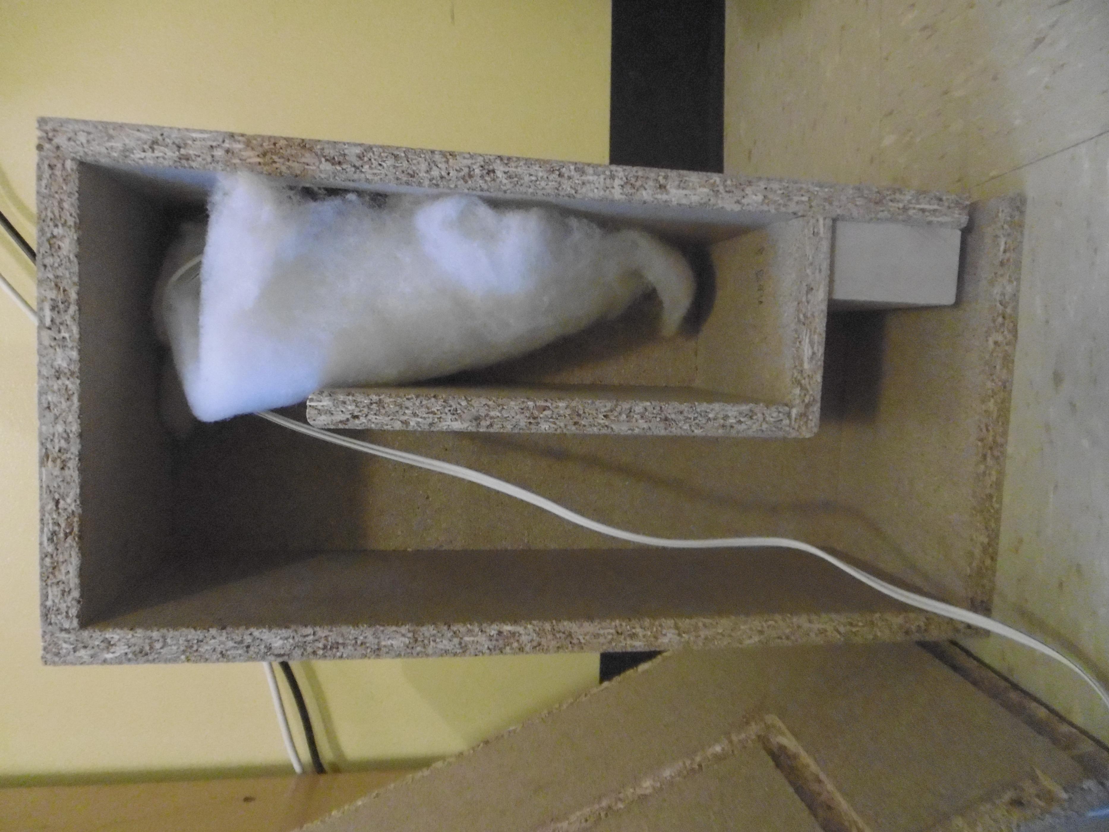

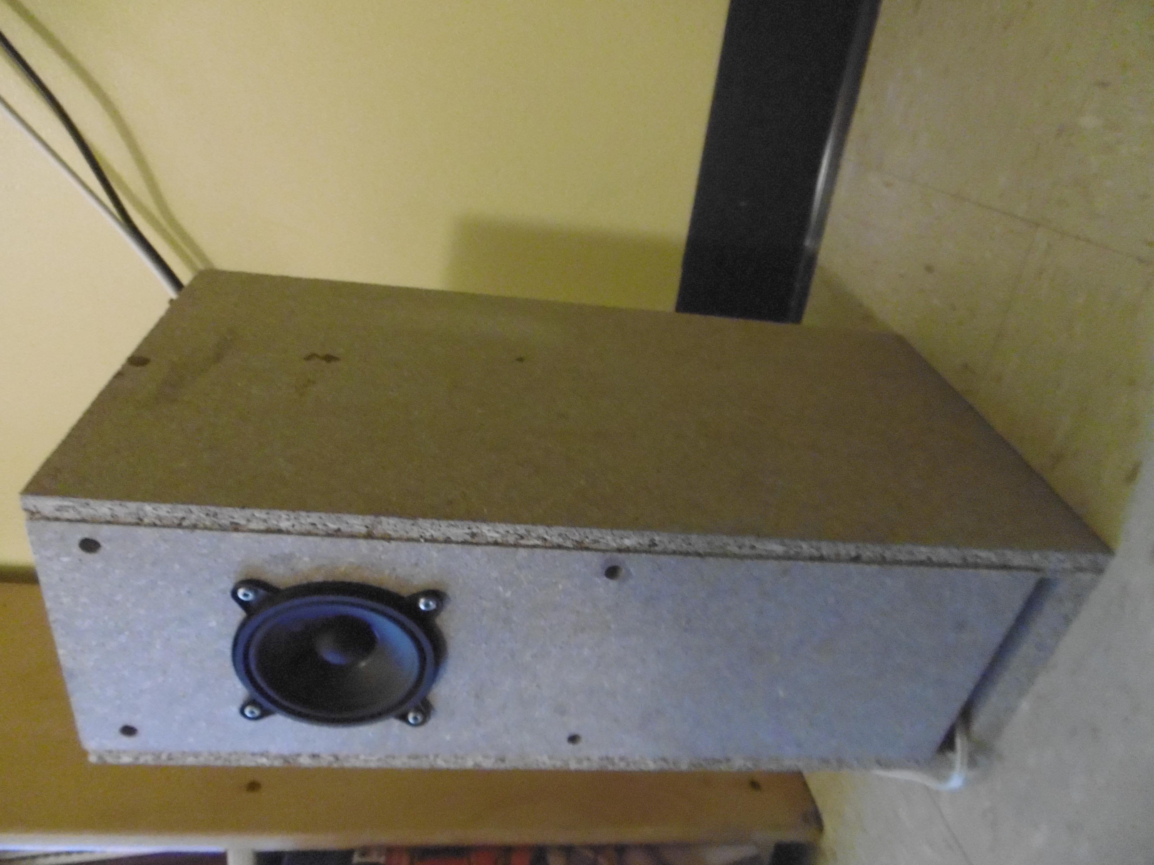

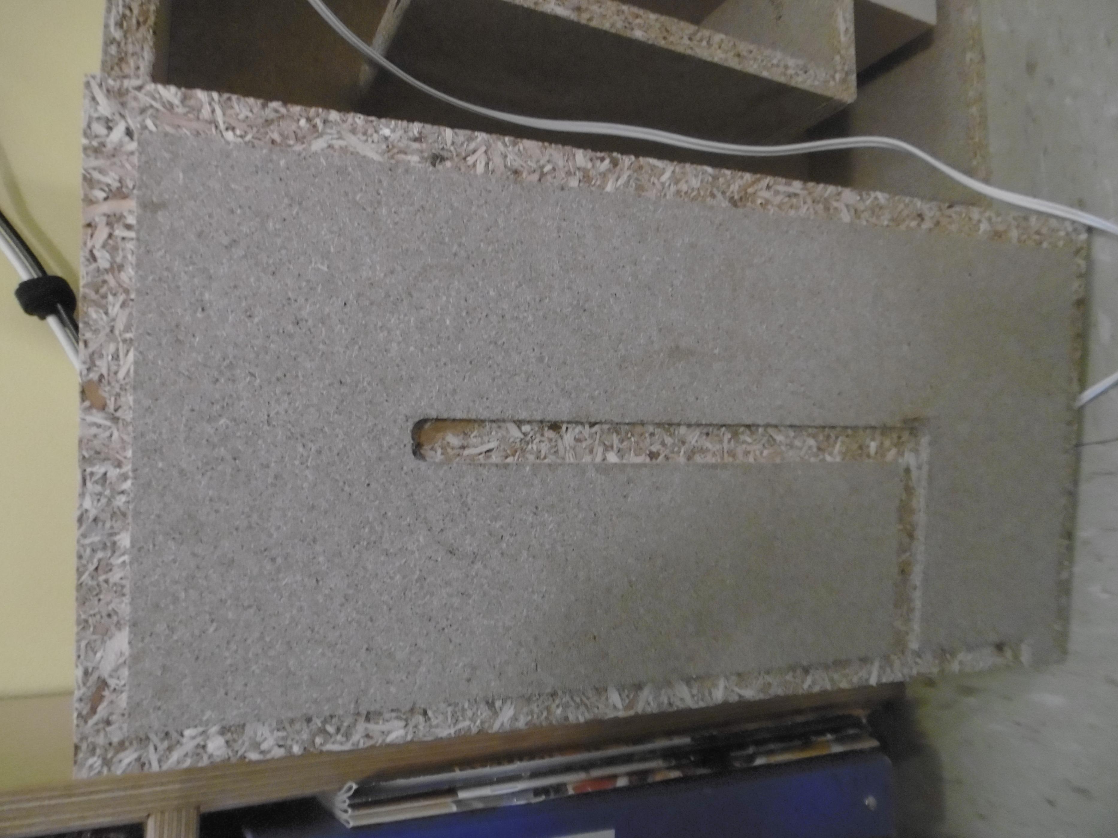

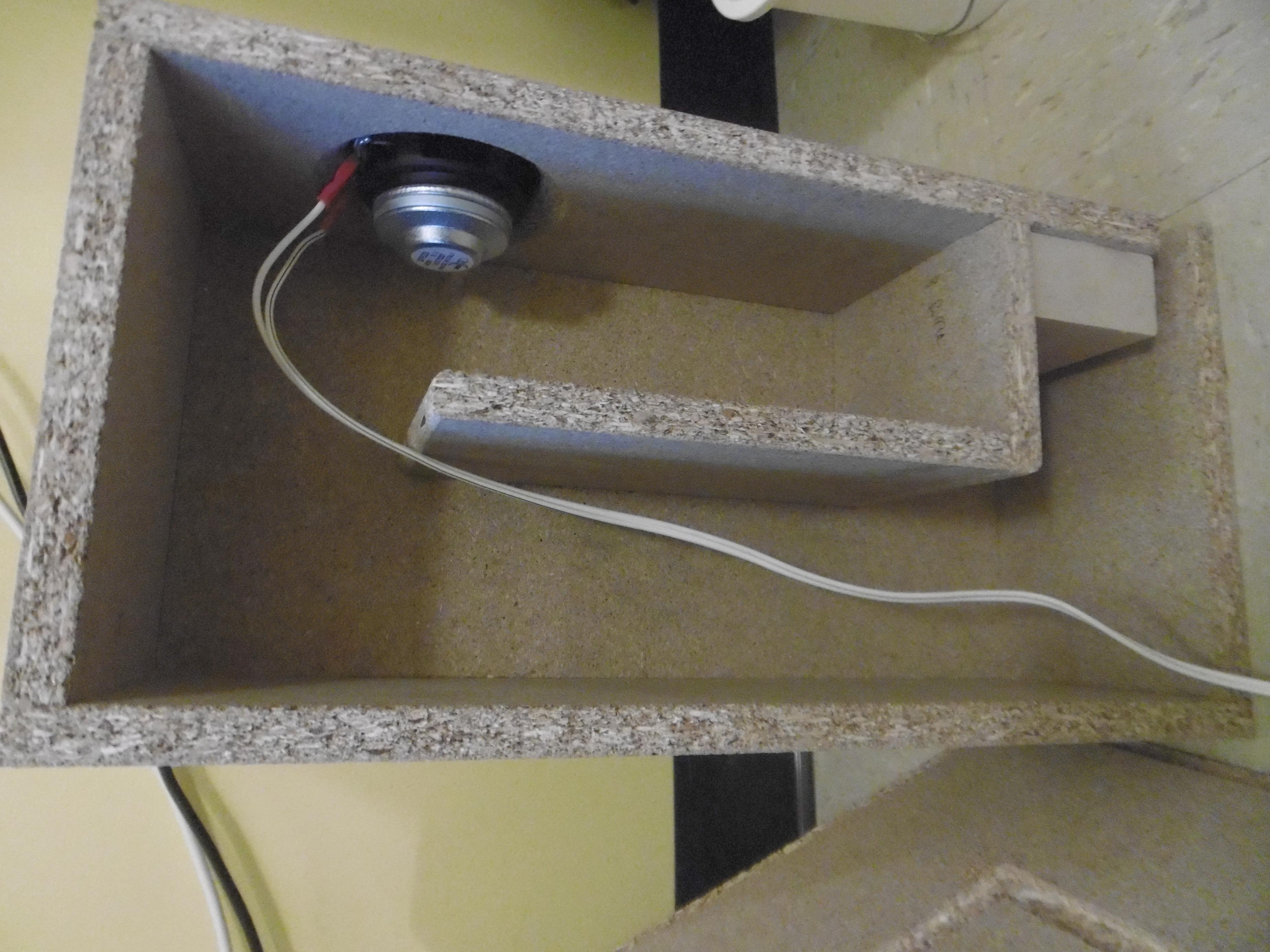

Here are some pics of the finished test build. I haven't got all the stuffing I need yet, but they already sound great. Very clear and honest highs and mids, and surprising bass considering the relatively high Fs. I will also try a test build of the original TABAQ dimensions with the Dayton Audio PC83-4 driver, that should get me from 75Hz down to 55Hz at the bottom end, and see which one I like better.
I will probably stick with the TABAQ design, because it sounds so good, and is very easy to build. I will be able to CNC the sides, and then anyone can cut the baffles and glue it up. I'll have to do a little more work on how to make the boxes look good, and add some terminals in the back and cloth for the front to protect the drivers from little fingers (it seems that kids find it irresistible to press in the dust cap!), but that should be easy. My next step will be finding a good, low cost class D amp board and power supply, and a USB DAC with remote, to make a complete little system.
