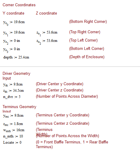

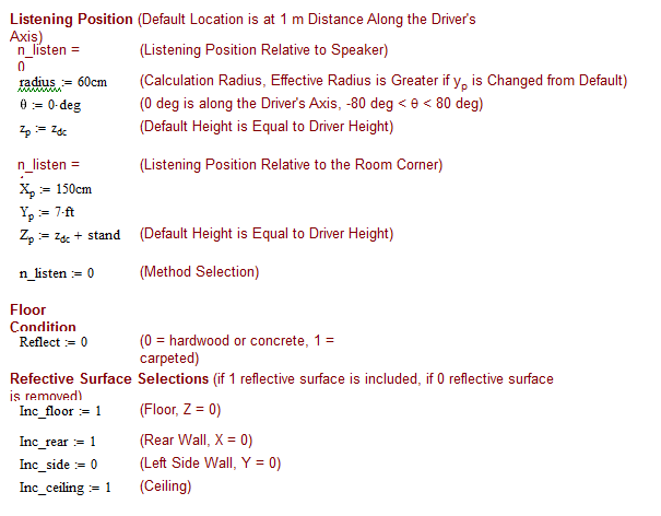

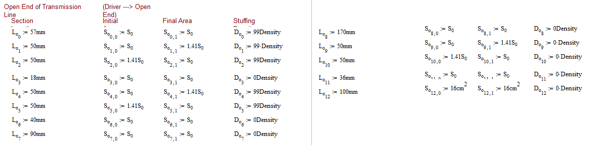

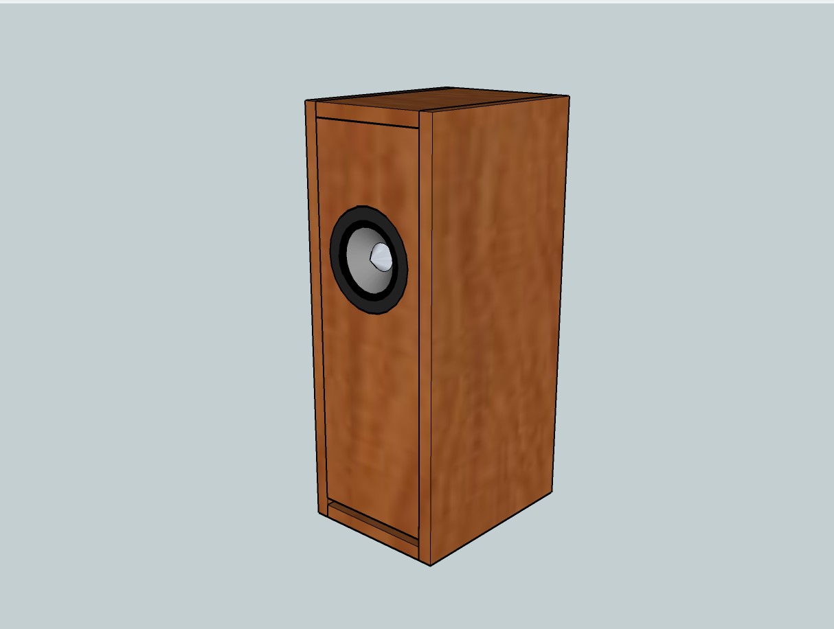

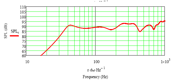

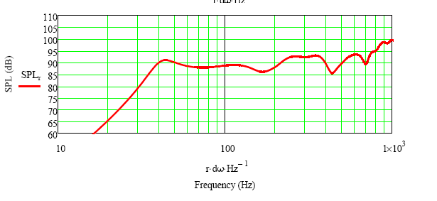

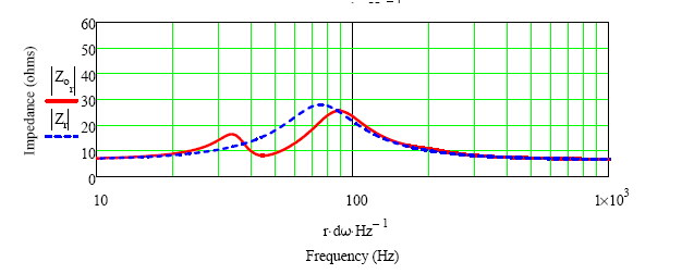

This is my new design for TB w4-1320 with MJK's worksheet simultation.
SPL
attachment.php
Impedence
attachment.php

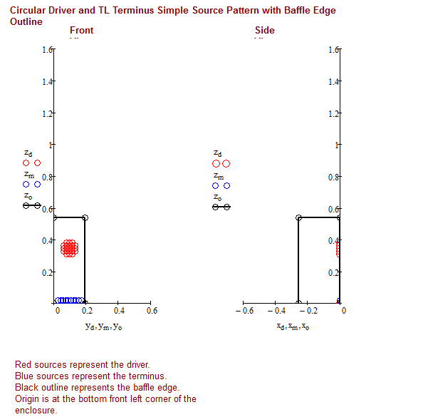

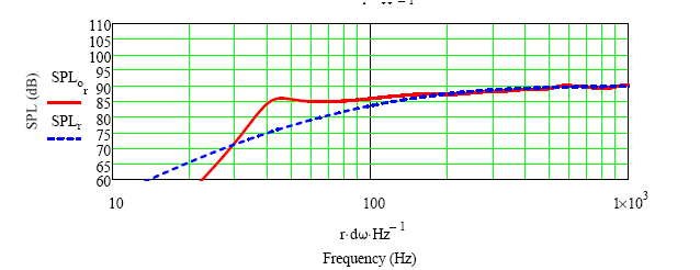

Baffle defraction SPL
attachment.php

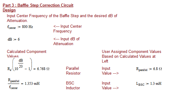

series paralleled 6.8 ohm resistor and 1.5mH inductor
attachment.php

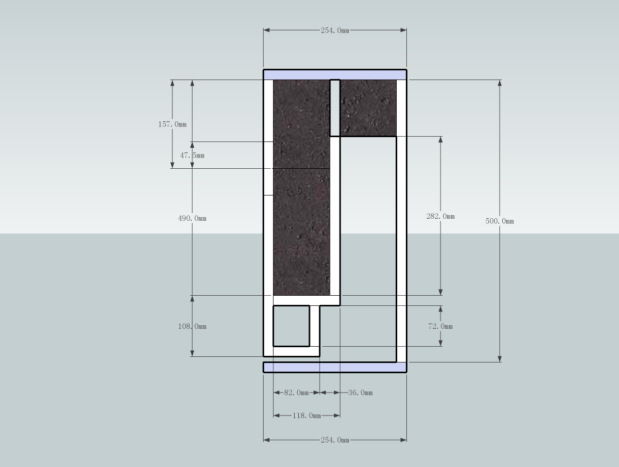

cabinet 2D sketch
attachment.php
3D sketch
attachment.php
Hope you will like it. 😀
I will upload more information later.

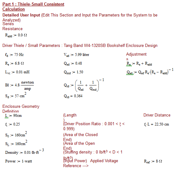

Driver T/S parameters
attachment.php
Enclosure setting
attachment.php

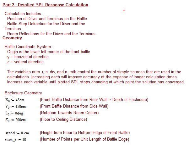

BSD setting for desktop listening.
attachment.php
attachment.php
attachment.php
attachment.php
BSC circuit setting
attachment.php
I just upload new designs to google 3D warehouse.
3D sketch links.
2D sketch links.

How much damping material is being used (I can see where it goes) Am I correct in that polyfill damping material is used but how much in weight?
Many thanks
AM
Hi yljhao
I'm not so familiar with that MJK simulations, but looking your drawings it looks like MLTL design and you use section TL woorksheet for simulations.
Hope I'm not write, bur let speciallists to advice... (sims lookd prety fine) or may be even Martin could add some more light...
Results should be essentially the same; the sections sheet has fewer simplifiying assumptions built in of course.
You can't enter different vent shapes in the MLTL sheet. Just take the radius of its total CSA; should be ~near enough, unless you're planning on employing an extreme aspect ratio, which none of the sheets account for anyway. That aside, the room will have far more of an impact on the response than the shape of the vent.
Thanks for the updated version of the bookshelf system and all the hard work modeling it. Looks very good.
I have received my W4-1320 but have not build the Tabaq because I have just moved to a new house and need to finish that first. Then I need to do some more work on my 6l6GC SE amplifier before I can build the speakers.
Many thanks
AM
Weight of damping materials are 97g+25g. Bigger black block in 2D sketch used 97g, the other one used 25g.
Hi yljhao
No, You are right. It's MLTL design. I will revise sketch's filename.
TABAQ bookshelf design simulation results.
I'm guessing since you took the design from the the intended 871S that this variation you have created would also work with the 871S? Thanks for the clarification!
I simulated Tabaq bookshelf design horizontal port Ver. and horizontal Ver. with these drivers.
1.Tang Band W4-1320
2.Tang Band W3-871
3.Tang Band W3-1878
I updated simulation on google doc.
Link
Hope you will like it. 🙂
