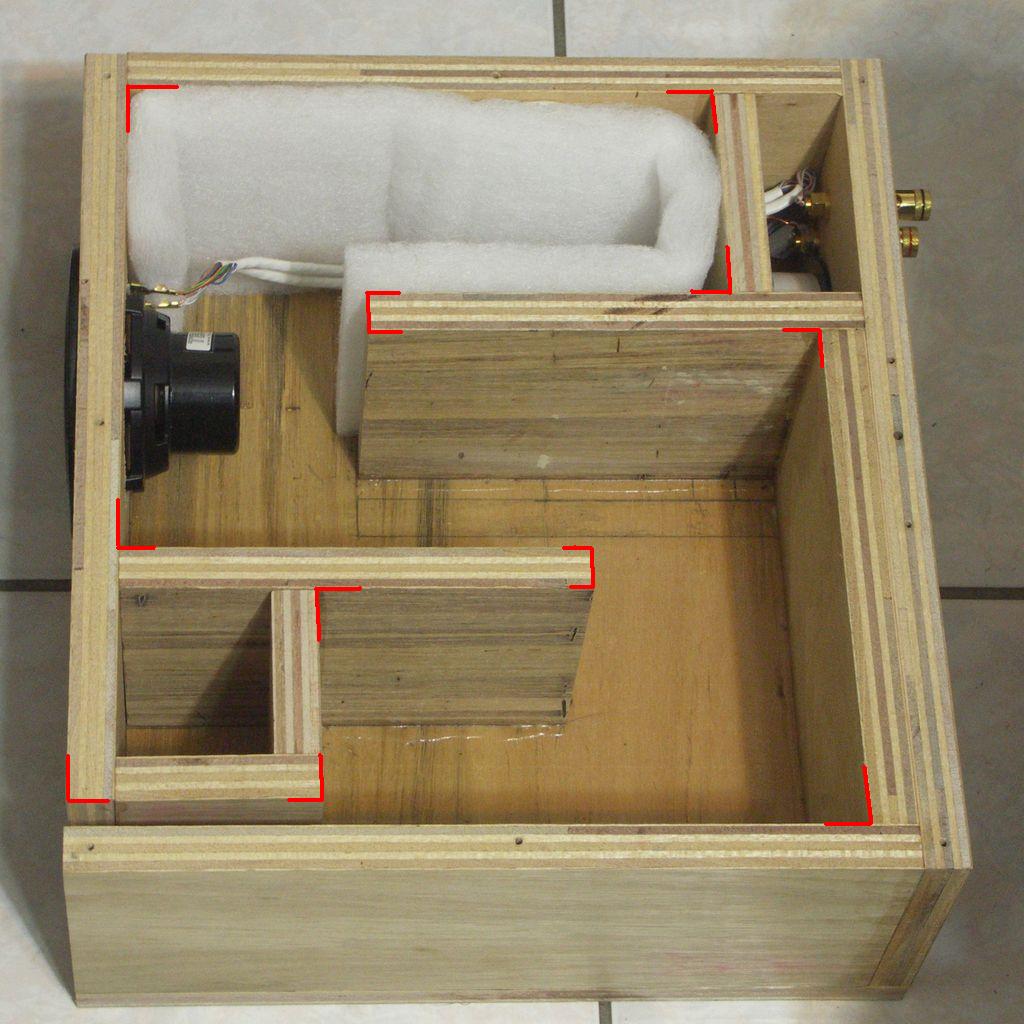

Prototype
I was build a prototype for this cabinet design, which is making by 18mm lauan plywood. Compare with last design, i was fix internal compartment configuration and put the BSC circuit in this space.
The sound is great. Plywood bring bass brighter, more dynamic and deeper than original design, but port size is very hard to cut. So i will modified the port again in my final design.
Fig1. Prototype cabinet.
Fig2. Internal compartment configuration.
Fig3. BSC Circuit.
Fig4. 2D Sketch.
Fig5. Mass Loaded Port.
Fig6. Compare with original TABAQ cabinet.
Fig3. BSC Circuit.
Fig4. 2D Sketch.

You are right. I was refilled 100 gram cotton to TABAQ original enclosure and prototype enclosure then re-compare both of them.
The original TABAQ sounds clean, bass won't muddy with midrange and it will get deeper.
Prototype sounds still bright and dynamic, but bass muddy and it won't get deeper bass.
Well, maybe i have to place port to other direction to aviod muddy bass.

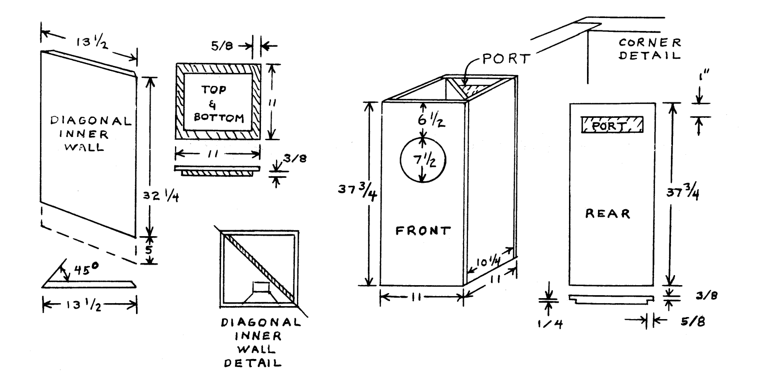

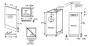

Instead of folding the TABAQ as done by the OP I wonder if it would not be better to fold it so that the pipe finishes up as a triangle. The port could be made vertically since there would be no space to do it horizontally. What are the thoughts by the learned members on this?
(attachment is for an 8 inch TL from the early days of transmission lines)
Thanks, AM.
Thanks, AM.
