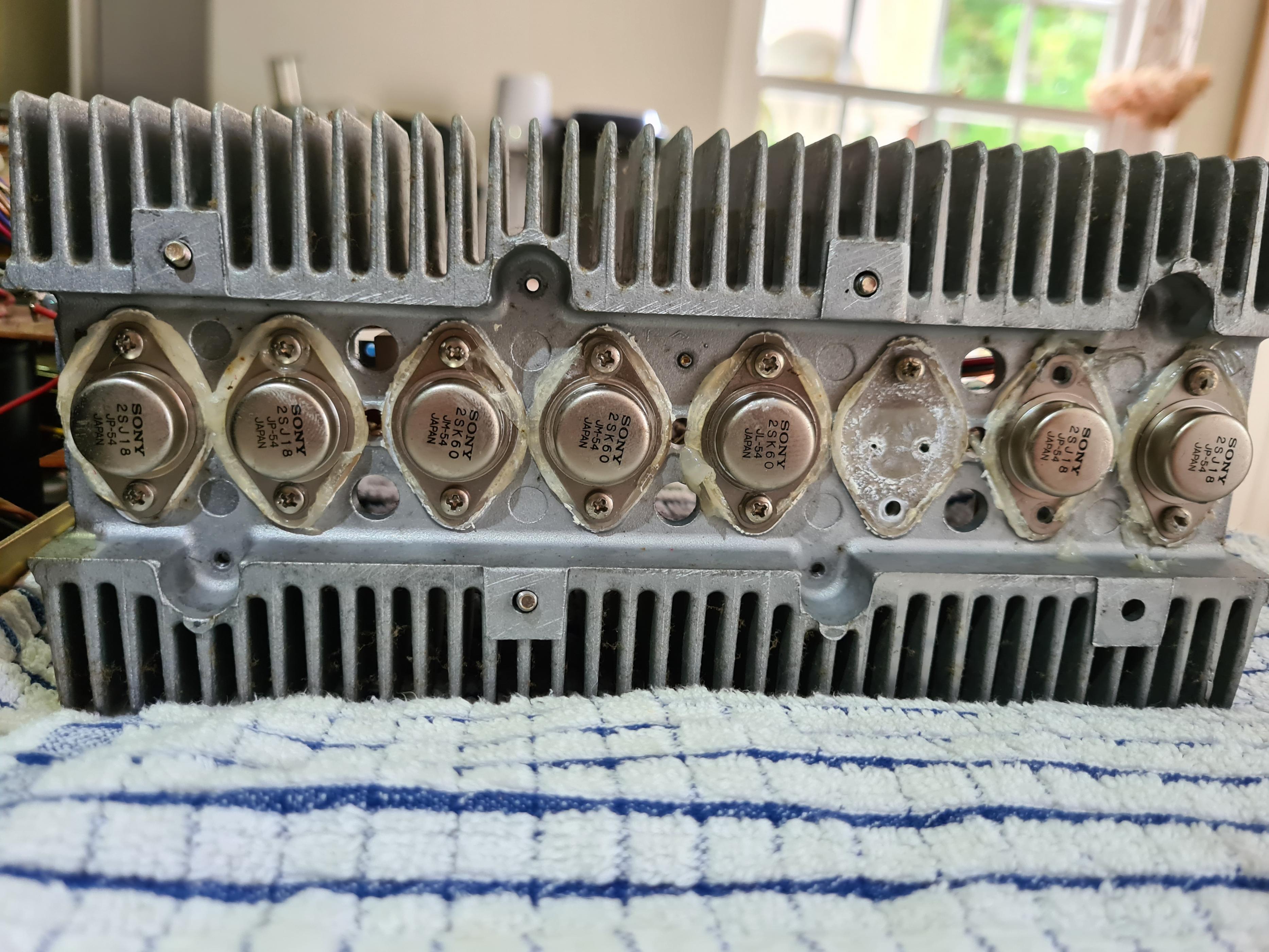

I recently bought an old TA-5650 amp in very decent condition and am in the process of cleaning and servicing it.
The amp appears to be a letter model, with the changes made in the Dutch service bulletin and with the wire wrap power leads instead of connectors.
I have replaced the suicide diodes and installed the double diode centre ground in the voltage doubler circuit.
Yesterday I measured the V-Fets and noticed that one of the 2SK60s (number 6) was showing a little high on the SD measurement of around 3.5 ohms. Am I looking at a shagged V-fet here ? If so, does anyone know if there is any place to source a 2SK60 with JC-54 grading?

Hi Elliot,
Turns out my FETs were fine after all. I replaced a couple of input Transistors to lower the DC offset and a couple of caps and then followed the installation process as per the service manuals and then set the bias (also replaced the 2.2K trimmers for multi-turn pots) and all worked great.
I did manage to score a matched set of 4x 2SJ18/2Sk60, used , from someone breaking a TA-4650 and these all measured good. Also got a set of 6 (4 SKs and 2 SJs) from another TA-5650 that was being parted, so I have a spare set of VFETs of 2 rankings (all ok so long as they are marched per channel).
Apart from the link above, the other genuine source i know of is Donberg in Ireland, Veronika is super helpful and may be able to get the odd one or two depending upon your ranking.

I've attached a picture of what I've got, the easy answer seems to be I need another JL-54 right? I've got a curve tracer and will run the rest through it today to test they're working.
Then, yes, absolutely, the suicide diodes are getting pulled and replaced. I'm doing that before it gets anywhere near some electricity 😀

Hi Elliot,
I decided to do a recap on my TA-5650 tonight, so the setup procedure is fresh in my mind.
Remove all the vfets and clean them well to remove the old schmoo off them. Use a ground strap to earth yourself just to be safe.
You need a 54 rank part, or 4 of the same rank to swap out on the channel.
I used the service manual method for testing them, all worked fine. Do short your probe leads 1st to get the lead resistance and subtract it from the readings.
With the vfets out and away somewhere safe and wrapped in tin foil, 1st thing to is the suicidal diode swap, followed by the voltage doubler mod for balanced voltage output.
If your amp has connectors for the power supplies to the main board, get rid of these and either wire wrap or solder the power leads to the amp board.
Replace the output relay, replacement omrons can be got easily enough. I got mine off eBay from a uk seller.
Assuming all is ok and you are feeling brave, power up the amp, make sure you plug in the centre connector to the amp board, this is the input signal and also needed for the relay board to work.
Once powered up you should hear the relay click in after around 8 seconds from cold start.
1 Check the voltages on the voltage doubler board, adjust VR1 to get 20v at q403 emitter, referenced to -ve speaker terminal.
2 check the dc offset with DMM between output terminals. Anything below 10mV is fine. Any problems here means you need to swap out the Q302/303 and Q352/353 on the amp board. Easy to source alternatives and they need matching for hfe.
3 assuming offset is ok, adjust the bias pots on amp board fully clockwise until vGS is max (29v or so)
You can probe the Source and Gate of the vfet connectors with -ve lead on -ve speaker terminal. Should read around 79v and 48v.
Now insert the vfets with new schmoo, sparingly. Cross fingers and hit the power switch. Don’t use a test bulb as it will cause you problems. Use a DMM, -ve on left ch + speaker output, +ve on the test point by the trim pot ( do use multi turn pots). It should read 0v. Check both channels.
Now with DMM connected, slowly wind the pot until you get a mV or so showing ( it will take a few turns until it starts) then wind it up to about 30mV, smefor other channel. You may hear the transformer start to hum as the vets start conducting. Leave it for 15-20 mins to warm up. Keep watching the bias and if it climbs over 50 mV wind it back. Once warm, set to 50mV and you are done.

Easiest way to test is with a DMM on resistance setting and follow the service bulletin guides. No need to curve trace them as very unlikely you can get matched sets, and to be honest, they are probably all over the place as they will have aged over the 40 years of use, each slightly differently.
The Dutch service manual recommends replacing a number of Resistors and Caps, plus lower the bias to 50mv. Mine must be a fairly late model as it had the changes, plus had the terminals wire-wrapped.

So I think I'm looking for 2 rank 54 2SK60s, at least it's not 4 😱

Hi Jon,
I'm just back in the UK for a little while so have the chance to look into it a bit more now. The amp had the parts from the service bulletin already so that was easy, I've replaced the diodes and when powered on the relay clicks in.
Measurement wise I get 20.2v at Q403, next, my right channel DC bias is very small but my left channel measures circa 25mv. Sensibly, I think this means Q302/303 need replacing?
Past that, my gate measurements seem to be circa 47v on the few I could easily get to just now (which I was happy about), but my source values were 9v which is way out. I don't suppose you ever had anything like that did you?
Do you mean DC offset rather than bias.? If so then 25 mV is ok, but would consider swapping out the input transistor pairs for something more up to date. I used 2SA1015Ys which when HFE matched gave less than 5mV offset and are pretty quiet.
All my voltages were in spec, please check the output from the supply PCB as the voltage doubler circuit is responsible for the source voltages, so check outputs there 1st before the amp board.
Ah yep, offset not bias, I got my thinking the wrong way around. I ended up measuring at quite a few points ilimzn spoke about in a thread on another board (audio karma?) and it's not too far away I think.
However, after measuring and going through the VFETs we spoke about from China, you were right, they weren't ranked properly / had just been printed 55 so have returned them this week which was really disappointing.
Back to the drawing board at the moment, but at least as a worst case scenario I have some good VFETs for the next iteration of the lottery amp
Are you measuring the S,D,G voltages referenced to Speaker -ve or to the PSU Gnd point?
You need to measure reference to speaker -ve.
Also check for dry solder joints around the driver Transistors and associated mylar caps. I noted my Bias (S to G) voltage would collapse to around 5v if I prodded components in that area, traced it to a dry joint on one of the Mylar caps. Cleaned the legs and re-soldered the joints and it is rock solid now.
