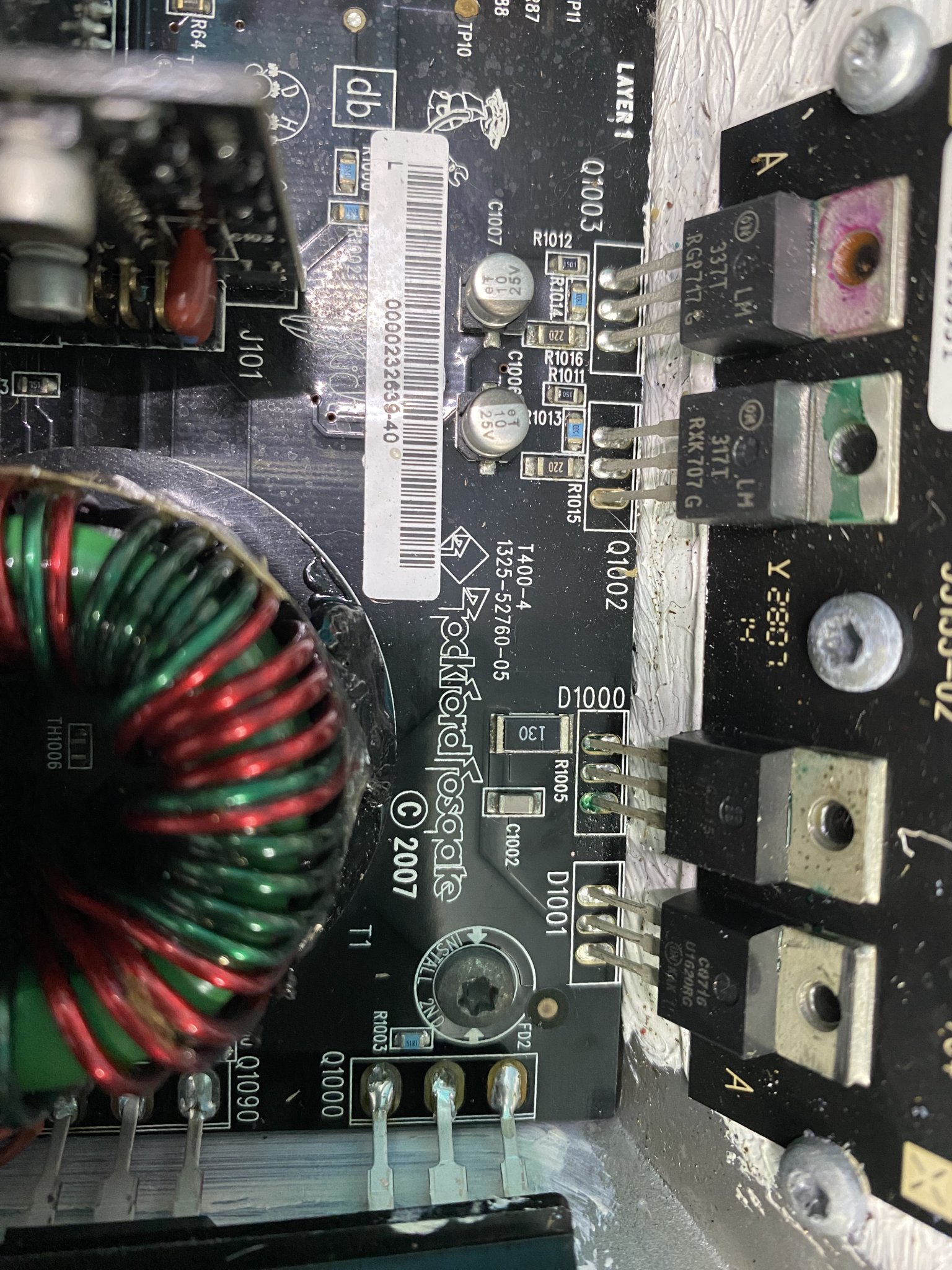

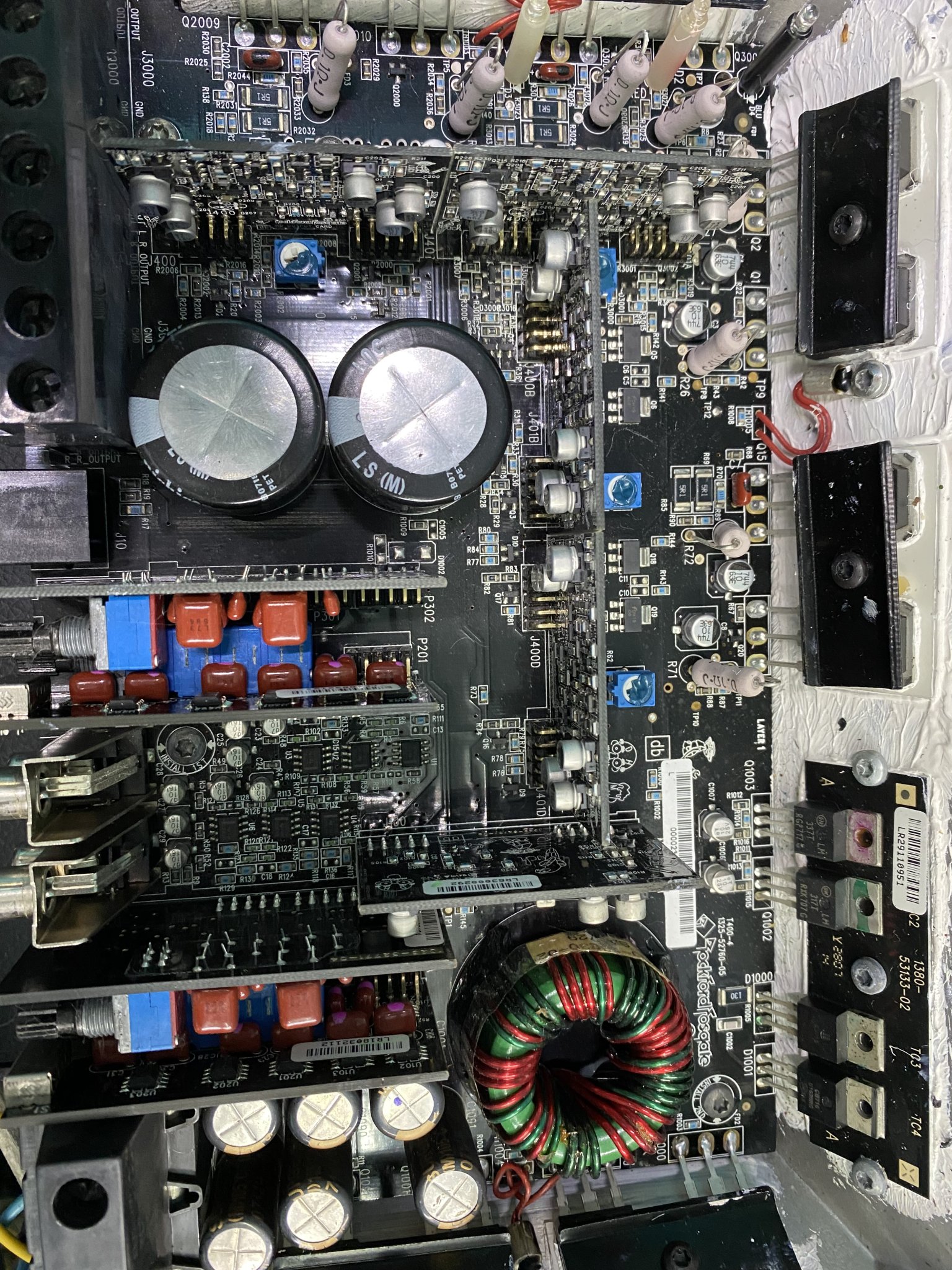

T400-4
Is there any part of the board or any component that you can push on (with a non-conductive probe) to make it go into protect?
Does heating or cooling (inverted can of canned air) cause the amp to go into protect? When using the cooler, I'd suggest having all transistors tightly clamped down and nothing more than a 10 amp fuse inline. If you accidentally spray the bias transistor, it could make the amp draw excessive current.
