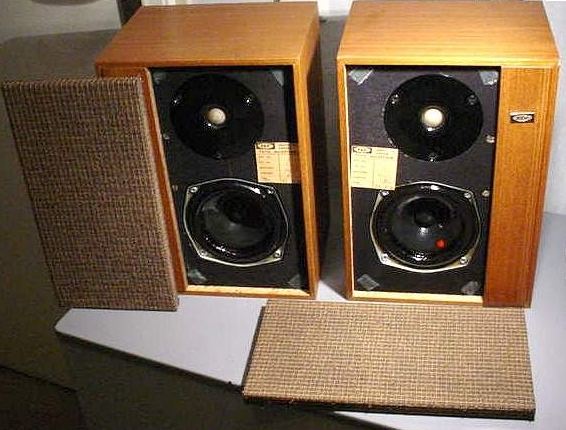

So I now own two pairs of Vintage Kef Cresta Mk 1.s
the units from 1968 have been rebuilt with entirely original components
the units from 1970 have been repaired thus:
1) I repaired the broken chipboard around the B110 insert using ply wood batons behind and filling with wood filler at the front
2) new gaskets for the B110 using draught excluder
3) Some additional cabinet damping using Falcon foam panels
4) The broken T27s were replaced with Morel drop in equivalent cat 298
Morel CAT 298 Tweeter
I did some listening tests last night. I'd already given the 68 set a listen and were generally pleased. The 70 units sounded somewhat better I felt. There is not much bass in either unit. I assume the simple 3 part crossover doesn't give the LS3/5a mid hump, but on vocals they sound wonderful. I listened to a Sandy Denny compilation and I don't think I have heard it sound as good. A velvety top end , not spitty at all. Both speakers are now bees waxed and to be put away til needed. They join a pair of Mission 707's that were refoamed and a pair of Leak Sandwich speakers that suffered a life of abuse. All these speakers now roam free in their paddock

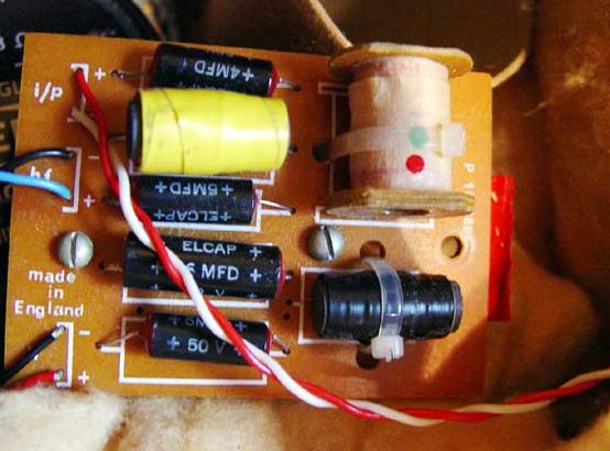

Hate to sound like I'm nagging, but those old non-polar 4uF electrolytic capacitors are probably near end of life now. They dry out over the years, being made of foil and blotting paper soaked in electrolyte.

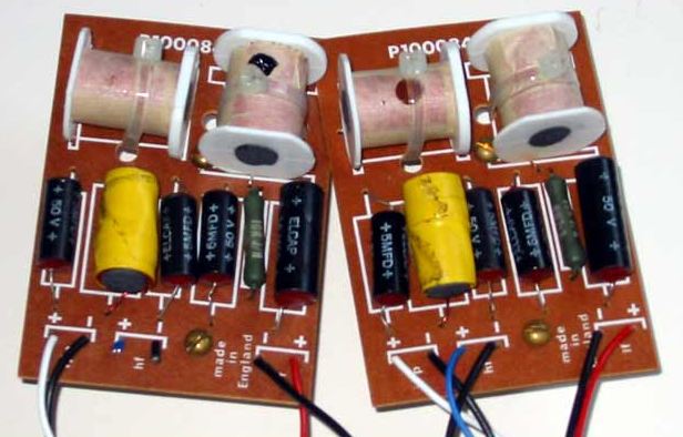

I'm pretty sure they are non-polars. They would be marked 50V and + at both ends in all likelihood too. Like in this KEF Cadenza crossover.
I have seen similar in IMF crossovers too. The blown up one looks like electrolytic to me. Replace with similar or a polypropylene for tweeters.
FWIW, polypropylene produces frequency response changes with bass shunts due to lower damping factor, so not so straightforward.

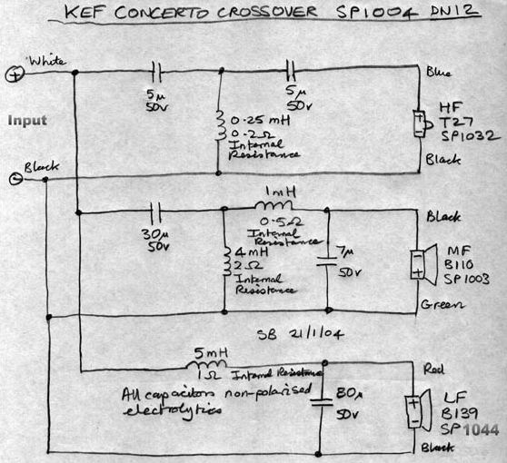

First order bass with second order tweeter is a bit rough on phase. Either way can sound good. It's actually quite hard to hear the difference and people do tricks like turning the speakers upside down to change the time alignment to your listening position. So you'd best figure out what KEF found best based on the distance between the acoustic centres of the two drive units. Lucky you've got two pairs. 😀
Fantastic work, jives11! Enjoyed reading the latest blog. 🙂
On the subject of bass performance, I'd guess these speakers don't have much bafflestep correction, because the bass coil looks as small as the tweeter coil around 0.5mH at a guess. The B110 was 0.55mH inductance IIRC, so the bottom line here is these are bookshelf speakers, not in the modern (and dubious...LOL) trend of standmounters which would have something like a 2mH coil and a huge loss of eficiency. FWIW, the tweeter capacitor won't influence this.
