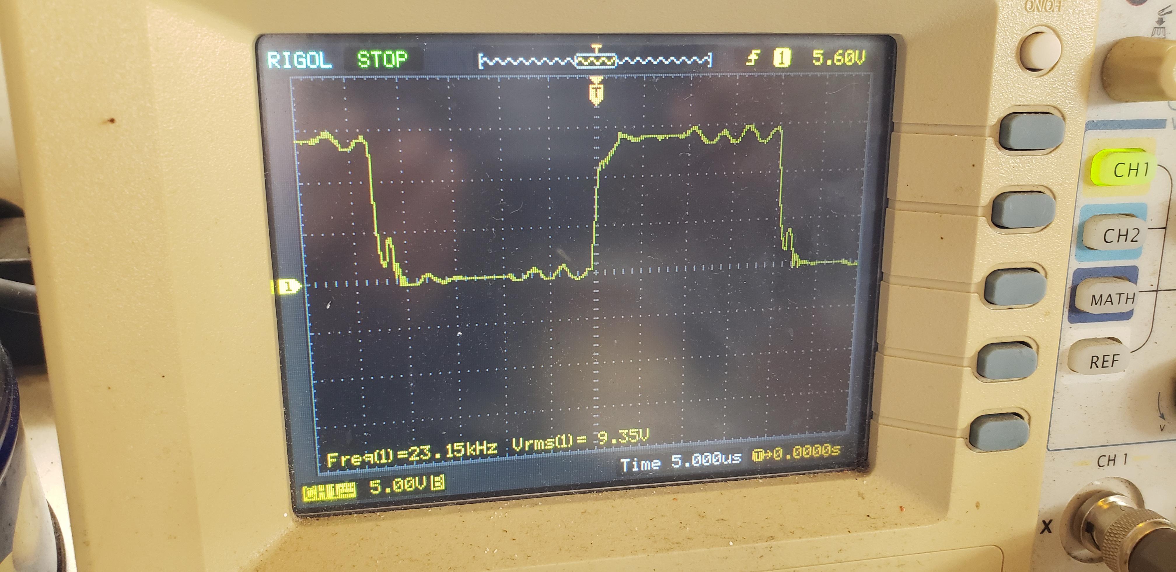

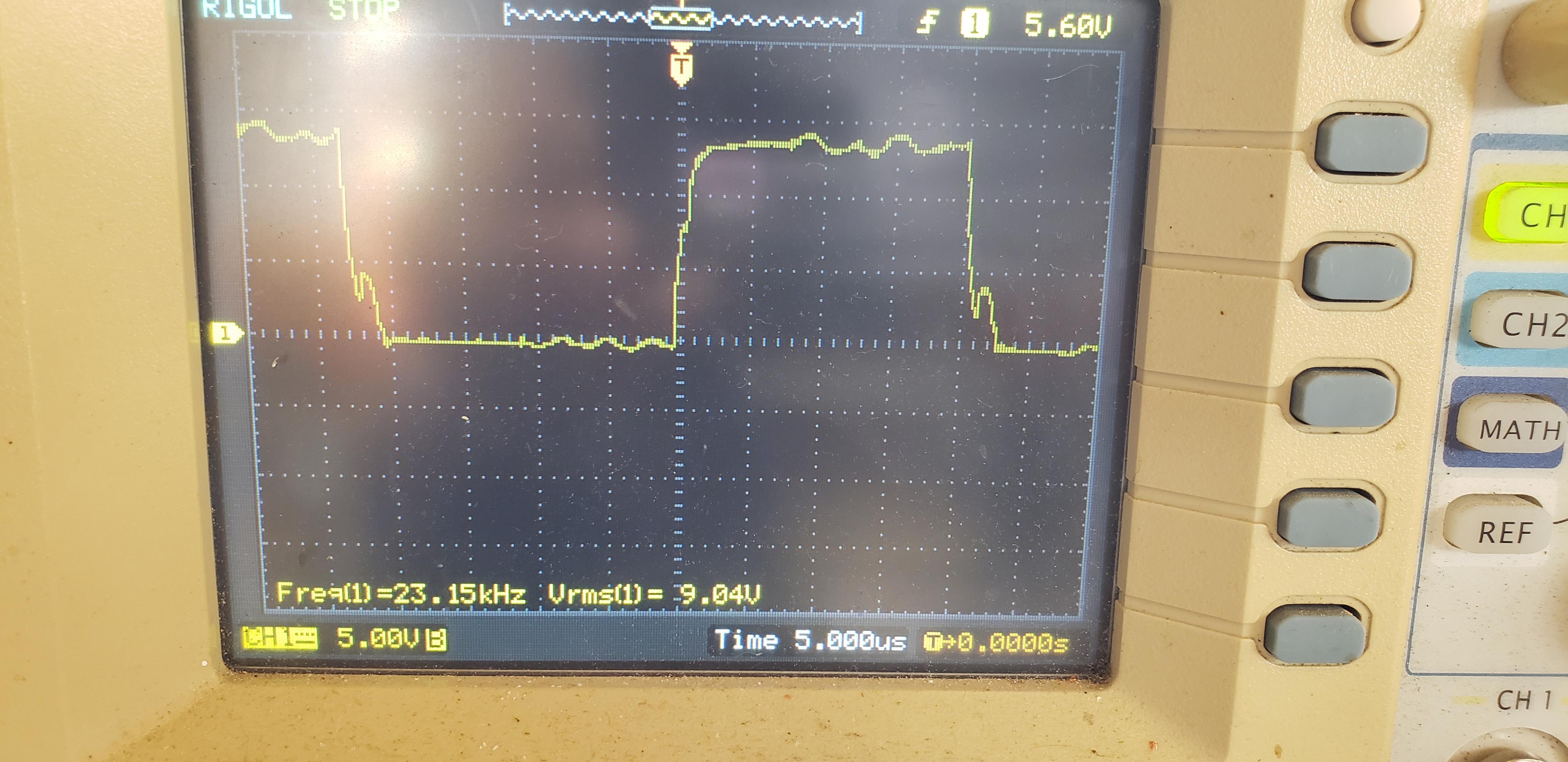

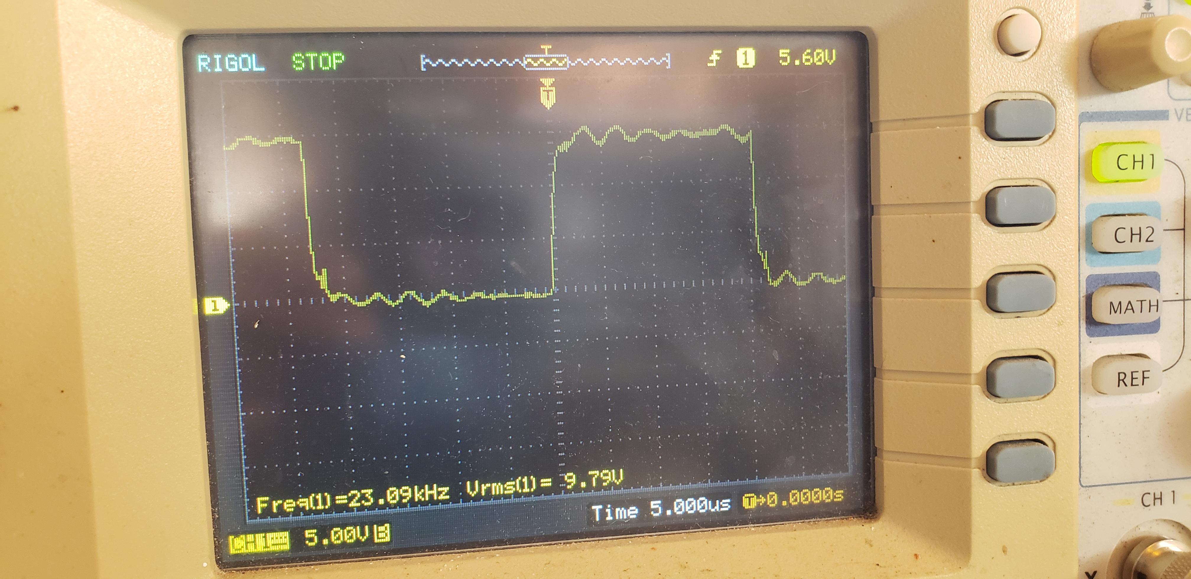

T2500-1bd gate resistor values

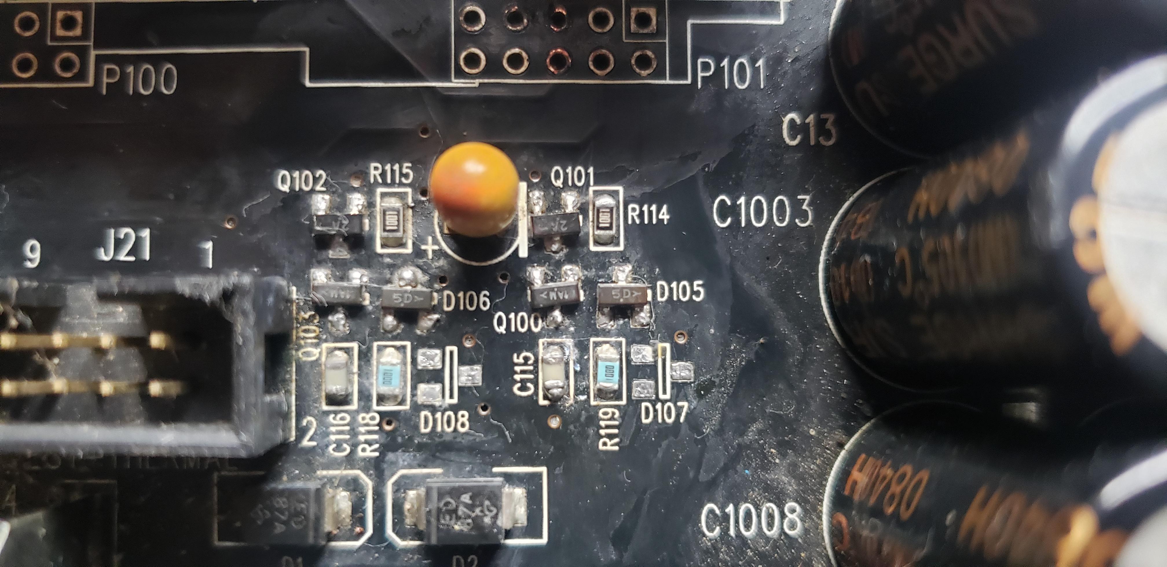

Attaching picture of driver transistors. Good side mosfets connected to base of 2A and heated mosfets connected to emitter of 1AM.
Do you have any MMBTA56 drivers that you can install in place of the PNP drivers?
To clarify, the driver board drives one power supply FETs directly. The output of the driver board that drives that power supply drives the bases of the drivers on the main board. The drivers on the main board drive the second power supply FETs in emitter-follower pairs.
I never used the HUF75344 in these amps. I always used the IRFP064N. If all else fails, try those in that supply.
You might try desoldering and lifting the center leg of the rectifiers for T1 to see if something strange is loading the supply. I think it's the drive but I don't know for certain.
The T1000 supplies the low-voltage. T1 is only for additional rail supply so the amp should work normally if T1's supply isn't functioning.
