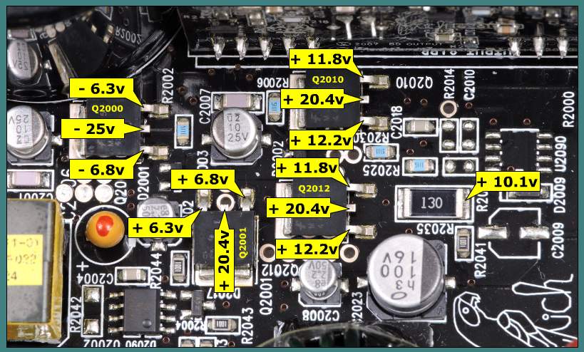

Pin 6 is supply. Pin 8 is what enables the IC.
Which pins have audio? Pin 1 should be the only pin with audio.
Are the regulator voltages on your amp approximately the same as in the attached image?
