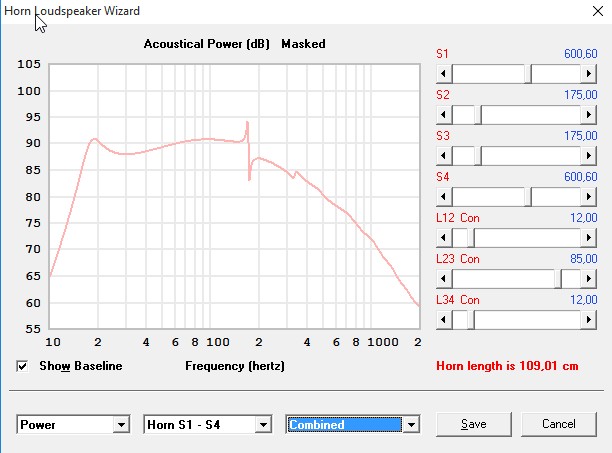

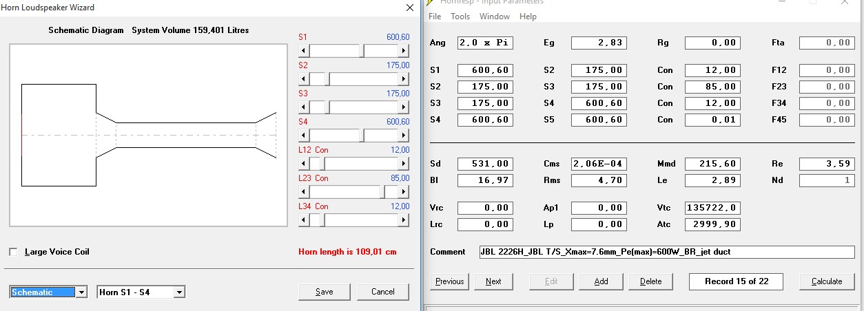

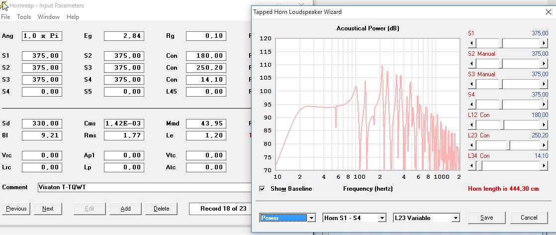

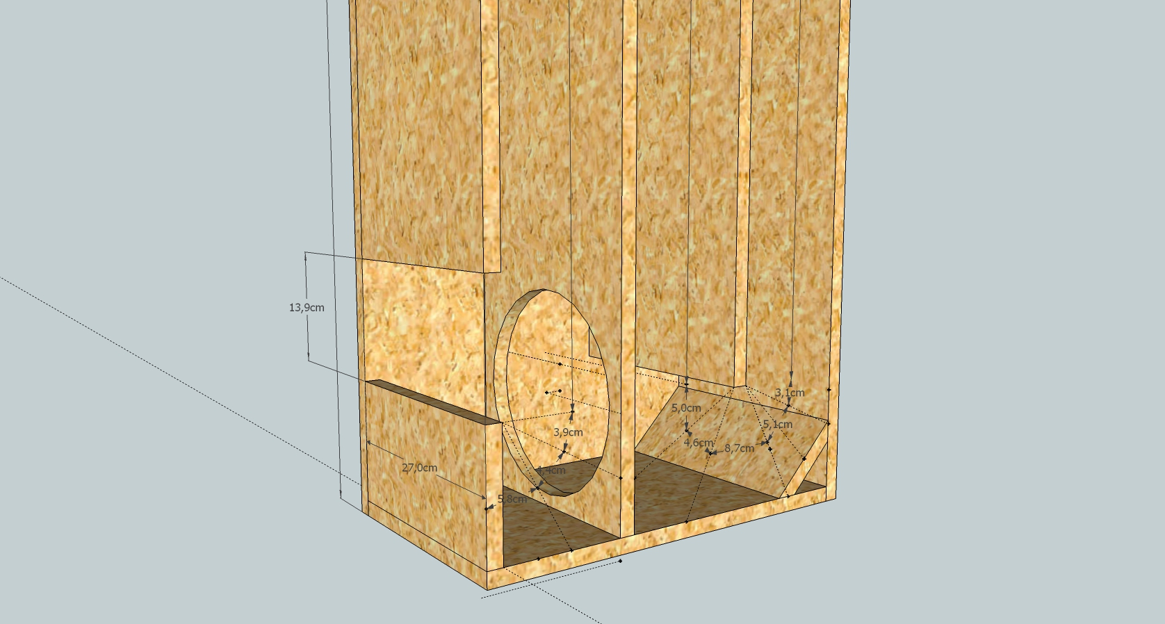

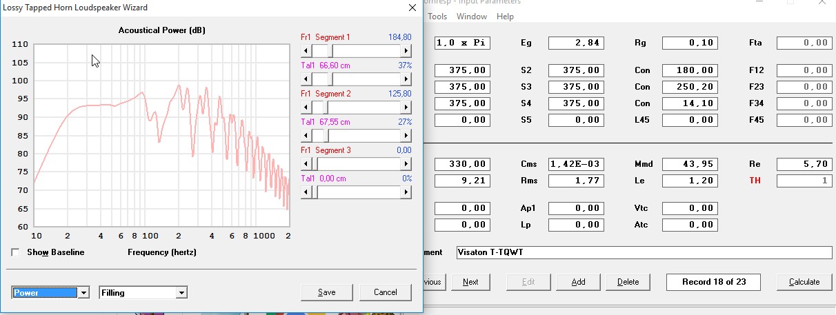

Have seen than the exit is different by yours, I have now make that also that way and go measure again.
See the pic of how it is now, I have put on hornresp some stuffing and then the peak/dip do dissapears almost but not with mine sub itself.
(all inside measured so thinkness wood is also automatic calculated).
L12 = 180 cm
L23 = 250,2 cm
L34 = 14,10 cm (Here now some doubt!)
pipe is 375 cm2.
but did exit different (maybe cause?)
regards

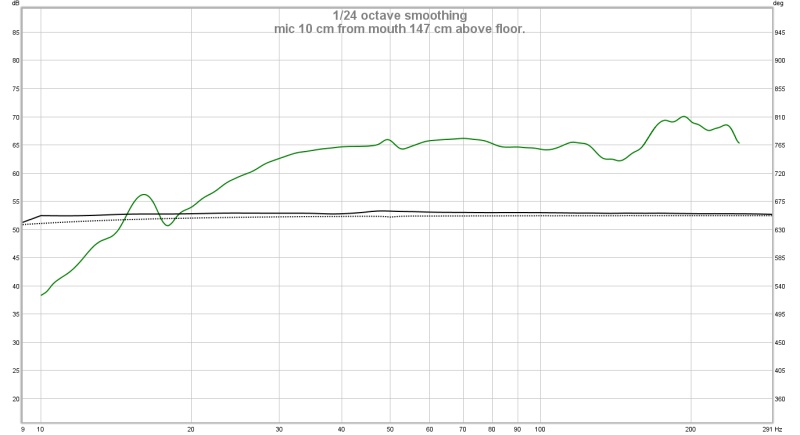

with stuffing I get this with the box as made it, I can not change that anymore but when do the stuffing it still gets that nasty peak on 52 hz.
Now I go try outside if it is dry there, .
regards

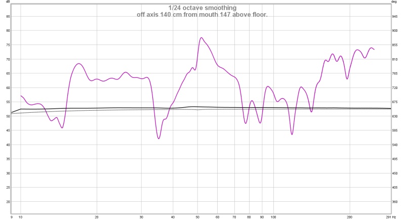

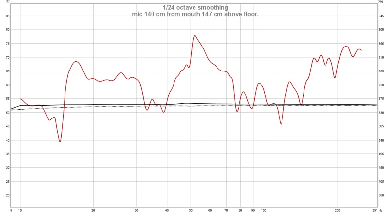

Kees52, you have wasted space. Bjorno said internal height is 152.9cm. Based on your built height and design, your tap is in a different location than what he modeled.
Wasted space I did now, a little, but the sub is build in 2015 and so I can not change much except I have the tap now on the proper place. Further changes is not easy or even not possible because of the glue.
I did some measurements inside with the stuffing Björno advised but I have a nasty room

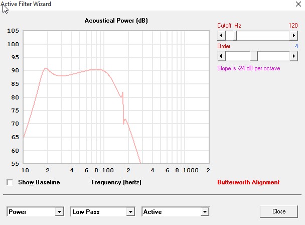

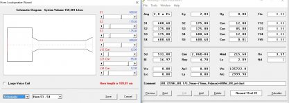

Are you using any DSP?
no not a dsp, I use a 24 dB lowpass filter.
But maybe it is needed if room is quite nasty, therefore I do make a new one, that is a tapped horn, or inverter tapped horn.

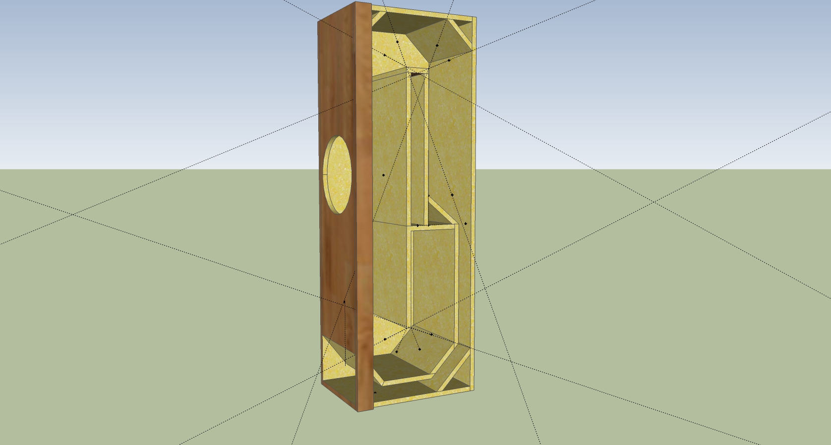

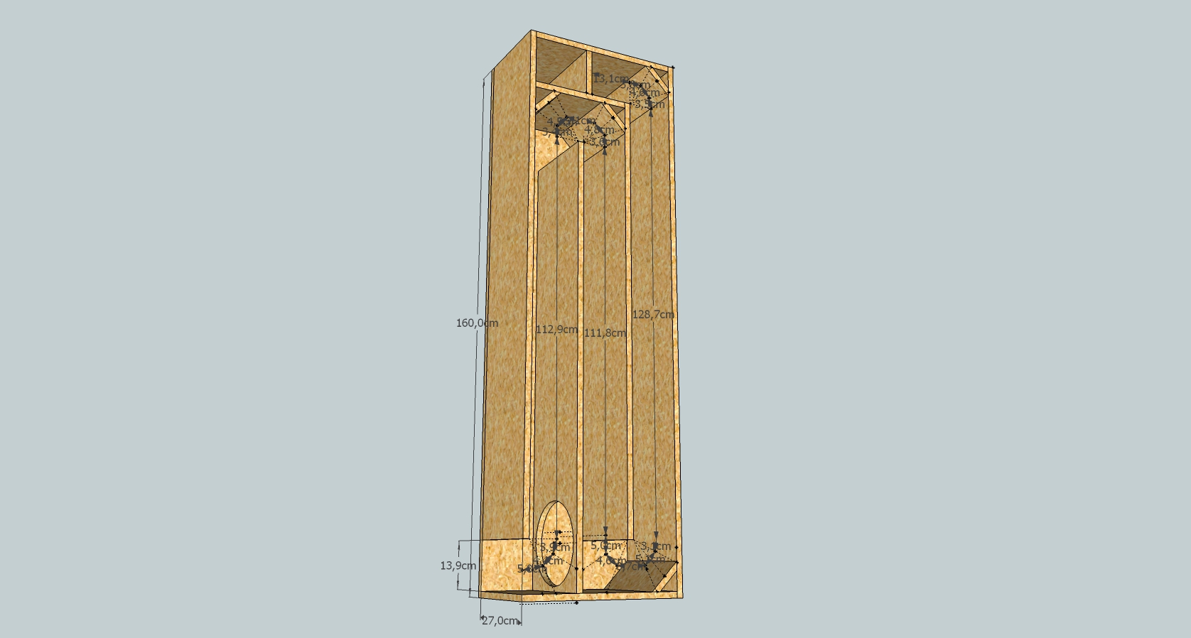

The misunderstood what concerns length I have to explane how I did folt it in sketchup. I do always keep internel length and width
in mind, automatic it go right, the inside baffles for example. I do not need then to look at thickness of wood in sketchup.
This way I have also draw this sub in it but never build, it looks good, folding I have some experience with now.. I draw always form inside out so thickness get automatic right.
regards

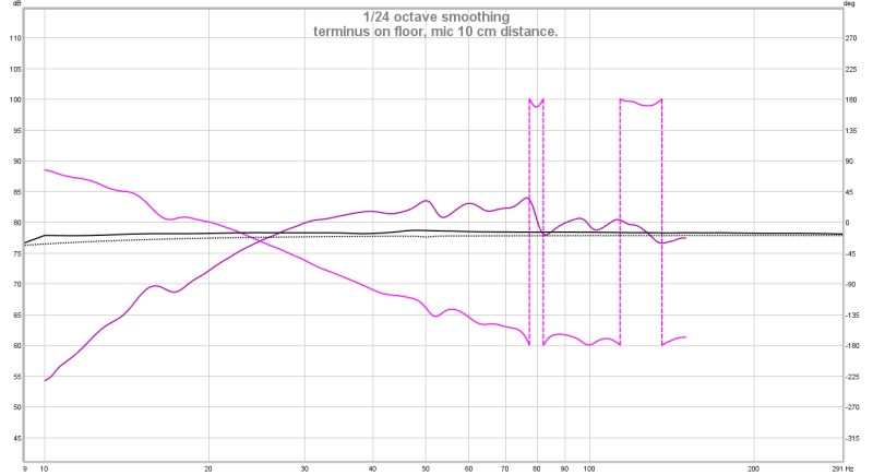

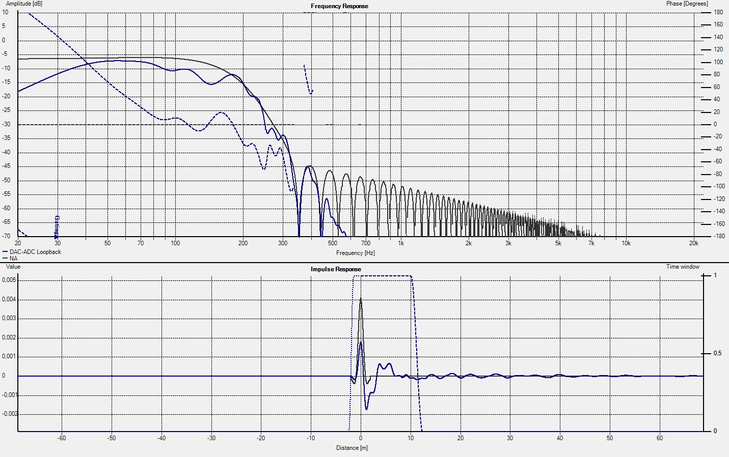

Hi Kees,
The first of your submitted Pictures show the Response of your T-QWP
as measured ~ at a point where the Mic. doesn't dip into the Terminus end correction= OK.
Looks like you only have a Room problem.
Note: The T-QWP Terminus should be placed close to the Floor,not at a Height of 147 cm above !
b🙂
Hi Bjorno
I have now flip the dbox so terminal is on floor again, do not much different with that.
The canceling however do go up to 80 hz, so there is a fault in length of box, I go however do a tapped horn or a inverted tapped horn, for use with the synergy horn, it needs more efficienty and the visaton pipe do not give enough, however it is a nice learning curve.
