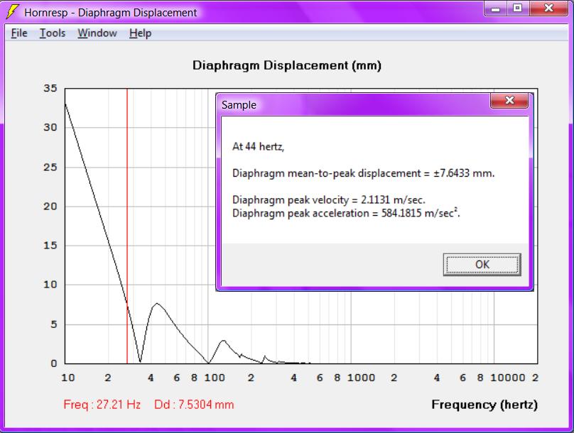

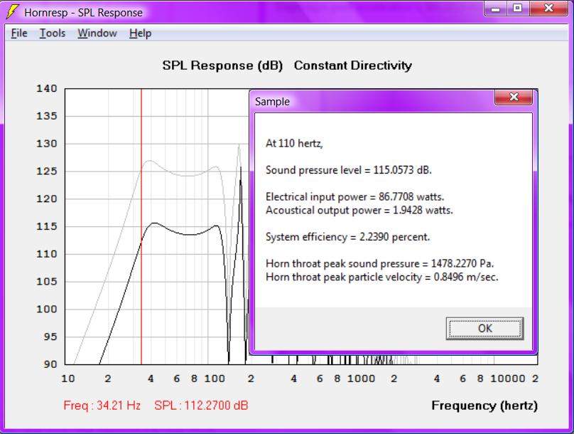

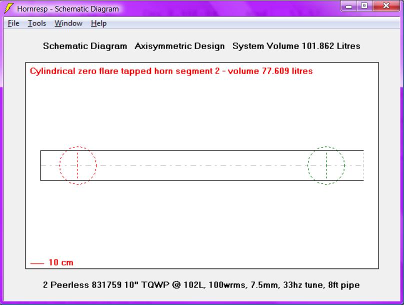

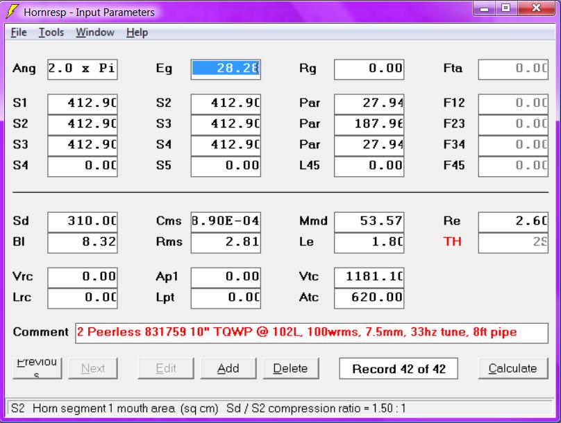

How about an 8 foot (2133.6mm) x 11" (279.4mm) x 7.27" (184.66mm) 33hz tapped quarter wave pipe (TQWP)? With 0.75"(19mm) stock, a single fold enclosure would be 49.5" (1257.3mm) tall x 12.5" (317.5mm) wide x 16.79" (426.27mm) deep. No angles! 100 watts @ 8 ohms, safe to 27hz.
