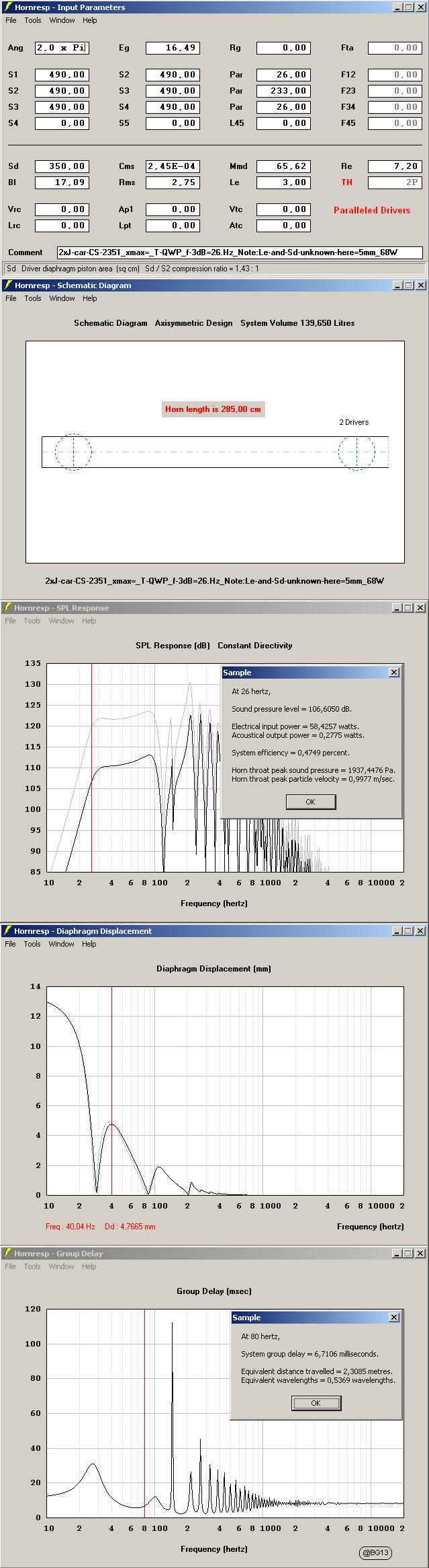

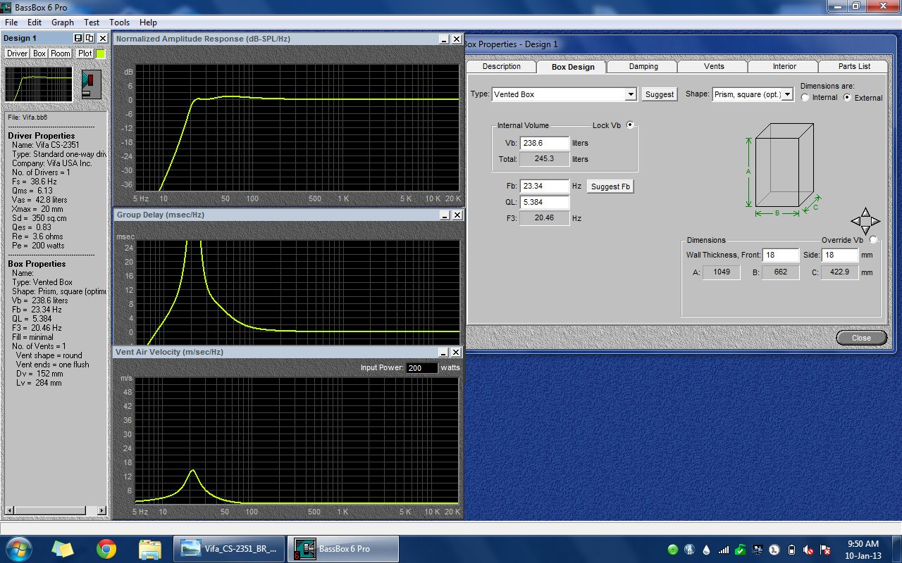

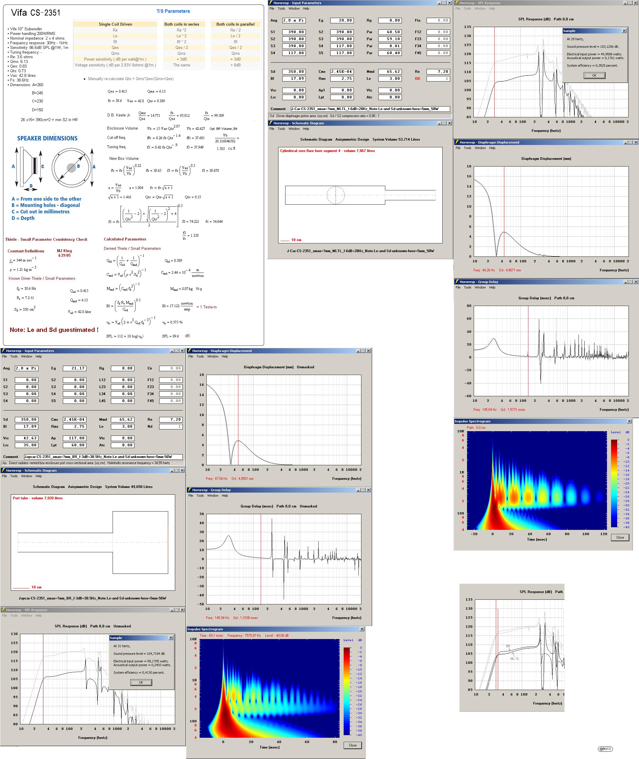

What about this design I came up with in BBP6, it's huge!. It's got the right frequency response but the group delay might be too high? It's above 24ms. 250L box for a 10" sub.
Might try and sim a box that's smaller, might reduce the group delay, the F3 will be higher though. Music doesn't have much (any) content below 30hz usually anyway, right?
I think this driver was intended to be used in a sealed box, don't really want to go down that path.
James
James

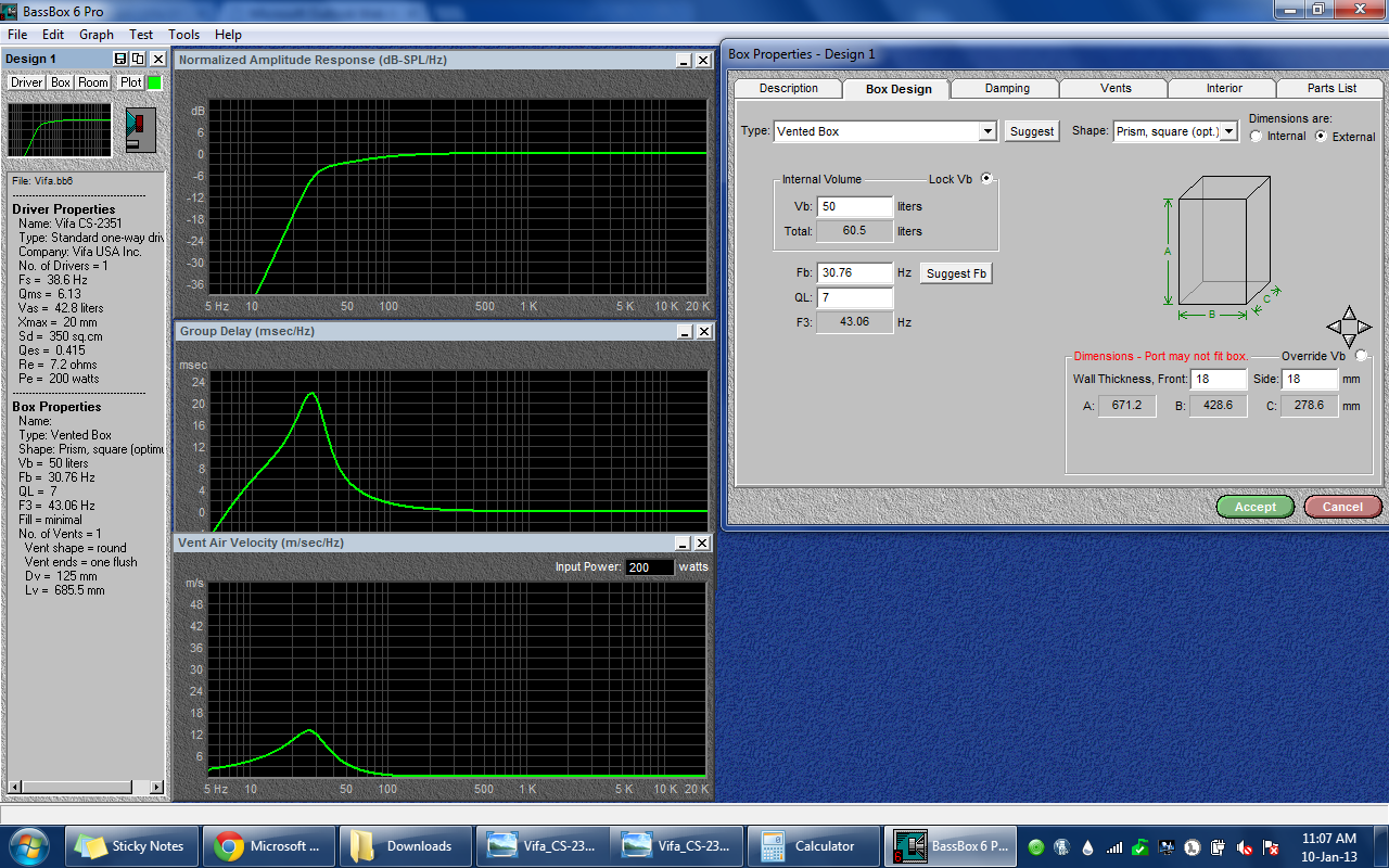

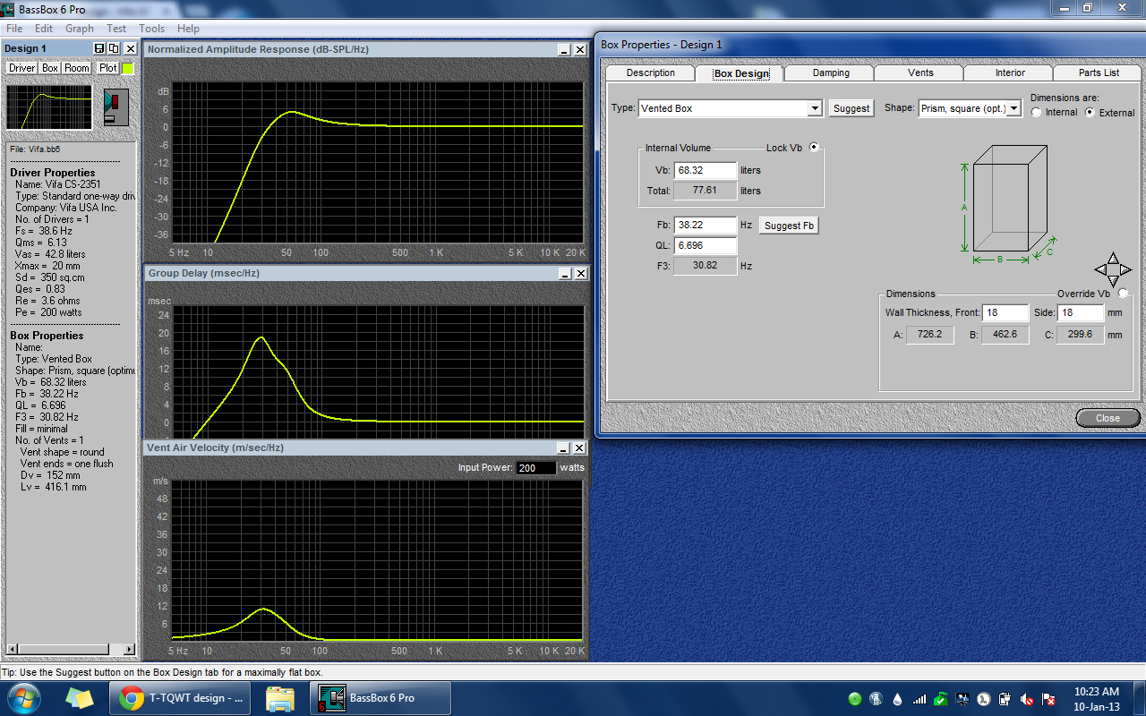

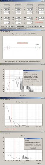

Here is a much closer design to your BR in Hornresp, the frequency response is not as flat / different?
James
Hi James,
😱You are using T/S parameters for only one coil, when the coils are in series or parallel: Qes should be (Qes single coil)/2..
b🙂
Whoops! it's going to be in series. Thanks for the help. Re-sim now,
EDIT: what if I drive a coil per ch. as I was going to use a Pro-Audio 2ch power amp? does QES = 0.83 then?
James
James
Are you sure? The specs on the Jaycar site were similar to yours, but then here it was stated that those specs were wrong, so at this point I don't believe either and why I didn't bother to 'run the numbers' except for lowest practical tuning: http://www.diyaudio.com/forums/subw...eters-vifa-subwoofers-needed.html#post3208138
