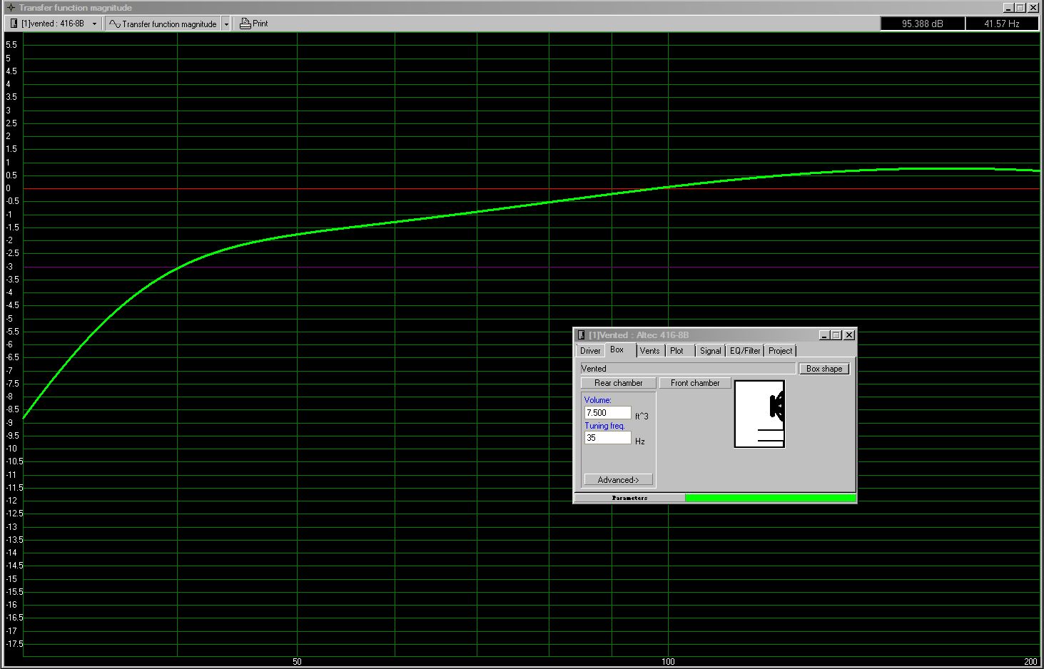

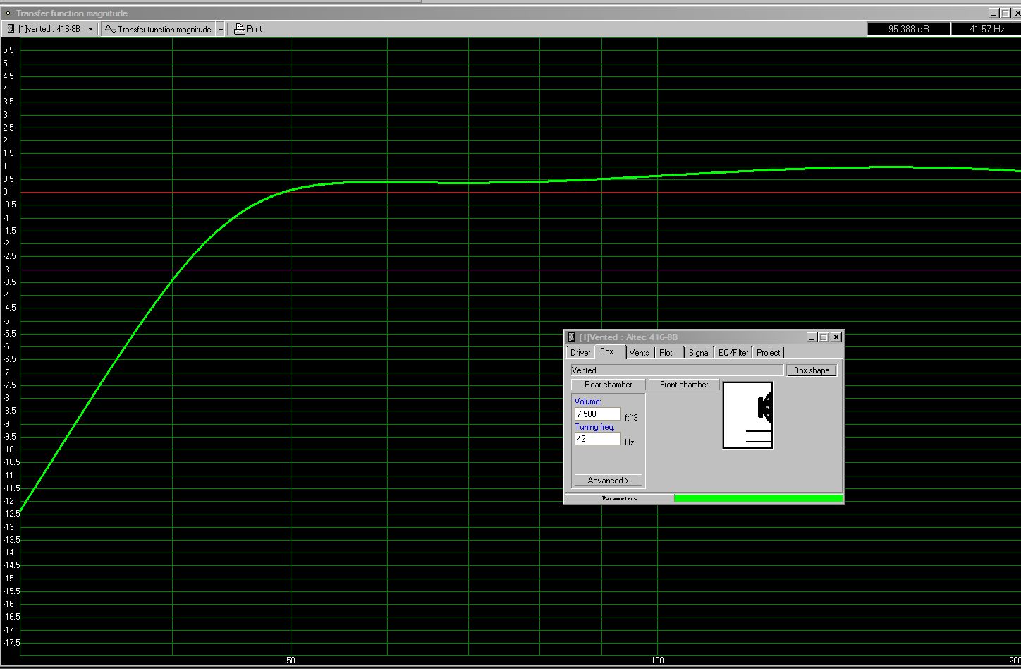

Attached graphs for 7.5 cuft ported box tuned to 35Hz and 42Hz. Your room gain and near-wall placement can add to a flat'ish response.

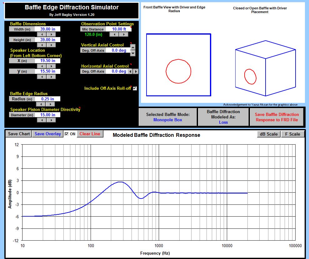

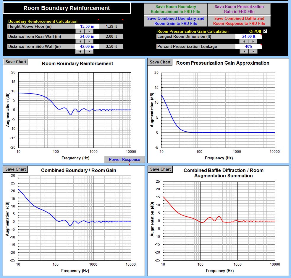

Plots of a simple room/diffraction model as a reminder how room dimensions and speaker placement can change the box tuning for optimum in-room sound. More detailed models include all_walls + ceiling + carpets + drapes + furniture, etc..
