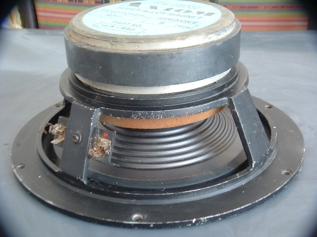

After digging into my old stuff i finally found the driver i purchased 8 years back I Delhi It was a die cast 8 inch driver the masket is of hard aluminum and polycone with 1.25 inch voice coil. I purchased it from chandni chowk from a boltom dealer. At that time i was living in Agra and saw this driver in a speaker box asked that man where he purchased it and went the other day to buy one for me. i bouht just one to see how it sounded. The name is BOSCHMAN AXIOM. last year i went to Delhi to the same bolton dealer to buy a pair, but to my disappointment the manufacturer of the driver had gone from Delhi. i asked the dealer who was making them and he said two brothers from Calcutta and they have gone back to calcutta. i have some pictures taken today, tried my best to take good pic although my digi cam has some problem in macro focusing but i think they are good to see the see the details.
You are in Calcutta is you can inquire if they are available in Calcutta or not. It is a nice strong driver and I have taken out every part of it cus it was lying there in one of the cartons and was like some rotten mango. Will try to repair it and do a full blown surgery to it. I found out the voice coil is wound on aluminum sheet. The voice coil came off from its base (aluminum) and now I will be using a normal paper base. Hope it works. Can you send me ur email, its hard to post pic so large in size here.

Hi Bro Somak
I have this 8 inch driver which i mentioned in my above posting. For last 8 years it is with me and i have not used it for last 6 years. When a took it out from the carton i found out that some of the parts were like deteriorating and the glue was loosing its strength and everything was coming apart. In past (23 years back) i had done some reconing and changing the voice coil and cones of the drivers. Now back to this driver, i took the driver and dismantled it, separated each and every part and will put it together again ( i hop i dont end up like "all the kings horses and all the kings men could not put humpty dumpty together again".) My real problem is that the voice coil got off from its aluminum base. I have some options and i want to u to give me ur precious opinion. Options are:
1. To go to the speaker repair market and have it repaired done just the voice coil replacement as the cone is in good condition but I don’t know how the other voice coil would behave as the voice coils sold in the market have no ohms rating or watt rating confusing.
2. But a same size paper based voice coil of same size and unwind it, have my original glued to the paper base as the aluminum base of my original voice coil seems to be not useable anymore.
3. Have a complete makeover of the driver.
4. The other option I have in mind is to use the OHP sheet as the base and stick the voice coil on it and then see what the outcome would be
Please suggest what I should do

Dear Kamal ,
You have to do a complete reconing to get good result .
I have seen very good quality imported voice coils of Chinese and Thai origin available in the market they are mostly 8 ohms made of aluminum or Kapton former .
Also change the spider .
the total cost will be probably :-
VC :- Rs 30 -50 each
cone : Rs 30
spider :Rs 10-20
Gasket Rubber :Rs 10
Use Araldrite Rapid as glue .
You should take the unit to a reconer as they will be able to center the coil better . If you do it on your own it might or might not be able to center the coil .
